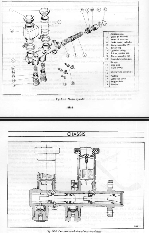

Here's the 1972 diagram showing how the front and back are "stacked".  One pushes the other.
Hi Zed Head, I'm not sure if you mean there are remanufactured MCs with the "F" mark in front? (Where?)
Hi grannyknot, I don't mind purchasing aftermarket if it looks like OEM. I'm just not finding an aftermarket MC with the "F" marking in front.
I'll probably end up getting the newer MC and swapping the lines underneath, but have not yet given up on the possibility to keep the OEM look/equipment.  Will probably get a quote to have mine "sleeved" & rebuilt  (, though expect that will be prohibitively expensive).

Thanks Zed Head. My signature has model-year, also (now) VIN#. Checked out those Rock Auto links, I might take the 71 option, but for now I'll just see if new seals will solve the issue (if I can find them).  Actually, I'm still trying to figure out what's happening. I'm not seeing fluid inside car, so rear seal must be working. Pressure is being transferred forward to front piston, but not fluid, so floating/middle piston seems to be working. Is there a check valve that could "stick" and cause this?. i'd like to see a cutaway of the old-style MC, but my manuals only show the same cutaway picture as you attached above, which is for later model MC.
Fluid won't show up in the car. It all ends up in the vacuum booster. Which ruins it. That's what ZH was alluding to
