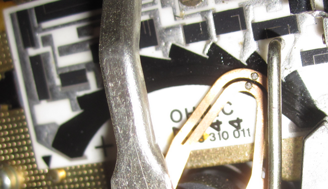

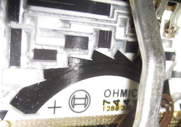

board, says OHMIC.  1 288 310 011 with a big 7444 beside it.
I suspect OHMIC is a company that Bosch sub-contracted out to for construction of the board. I bet that Bosch did not silk screened their own boards.
And the 7444 is probably a date code for 44th week of 74 (making it a prime candidate for the 75 model year).
It's a bosch unit. That is a Bosch symbol next to the "+" symbol. I think OHMIC desrcibes the type of contact used to measure resistence and therefore vane position.
"Generally the term "ohmic contact" implicitly refers to an ohmic contact of a metal to a semiconductor, where achieving ohmic behaviour is possible but requires careful technique"
https://en.m.wikipedia.org/wiki/Ohmic_contact

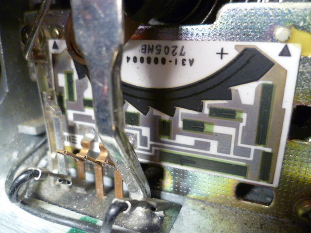

Zed Head, the one I got from you has the 7 pins and fuel pump cut off so I assume its a 77.
It's a 78, pretty sure, I got it from a 1978 parts car that seemed all original.  The fuel pump pins are "useless" as I showed above, post #8, with the Nissan wiring diagram.  Nissan probably had old AFM's in stock when they made the model switch.

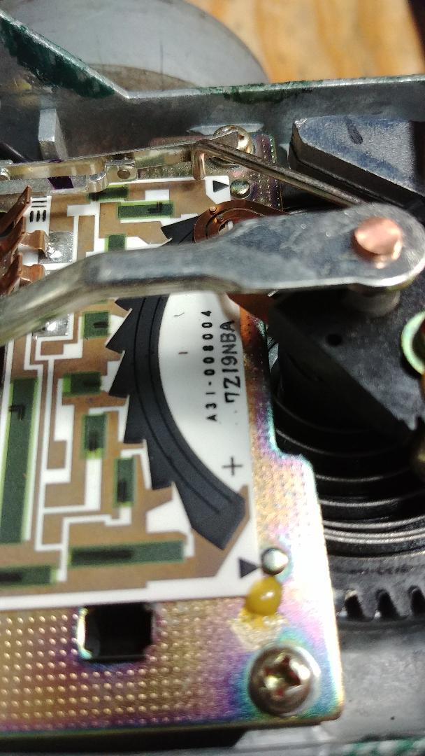

If you can get the part number from the board that would be cool.  No picture necessary, although pictures do add something.
Here's a pic of the AFM in my 77. I haven't owned the car since new so I can't guarantee that it's original, but I believe it is:
Seems the later AFM's used the green protective screen printed coating over the laser trimmed resistors.
