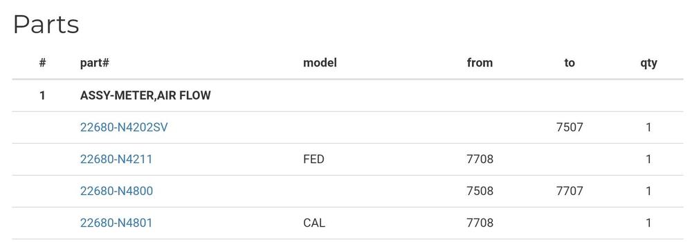

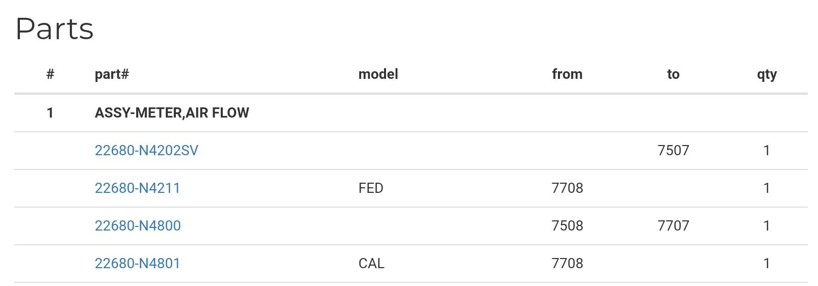

Yes, I have given up trying to figure that out. Datsun/Nissan had 4 different part numbrrs from 12-1974 through to the last S30 in 78, but JECS seemed to have used their own numbering system when you look at the MSA site.
I have four units and I have run three of them om my car and they all worked fine. I had to jig the fuel switch to run two of them.
It might be a case of parts swapping and JECS just keeping track of it that way. Or minor improvements for emmisions etc.

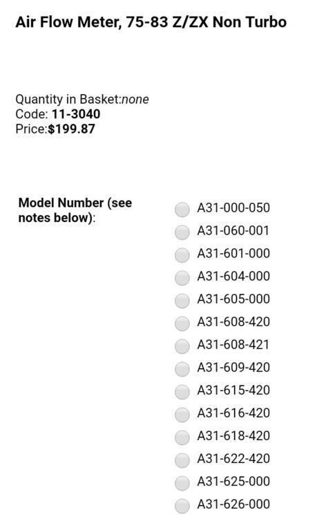

The 22680-N4202SV is the Bosch unit and I have seen it referred to as the A31-000-050
I have a A31-000-427 (p/n:22680-P6600) from a European 280ZX na from 1981. Those numbers don't show up anywhere on the two lists for US models. So if you look at the 280ZX na version as well, the list is extensive.
