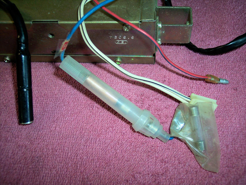

Not my car but an item in my recent parts hoard purchase.  Hoping for another unicorn find with this one.  I cleaned it up yesterday and refreshed the faceplate with a silver Sharpie - not to worry, a chrome pen is on order to get an accurate look.  Its missing the Hitachi model # sticker on the bottom but otherwise very complete and in great condition.  Next up is setting up a test environment to check out the functionality.  Where are @S30Driver and @Zup when I need them?

Thanks, Jim.  I know the power goes in thru the white connector to the blue line with the fuse.  The red/blue wire looks to tie in to the instruments per the wiring diagram.  I presume it is idle for bench testing? The radio is grounded thru the body, correct?   I have a working OE antenna from a 260Z to check out the antenna switch.

Yes to all your queries above. From memory---:ermm:--- it seems the red/blue wire is for the dial illumination lamp.

Hey Jim,  the red/blue illumination lead you can connect in parallel with the blue +12v power, to see if the bulbs for lighting are functioning.
