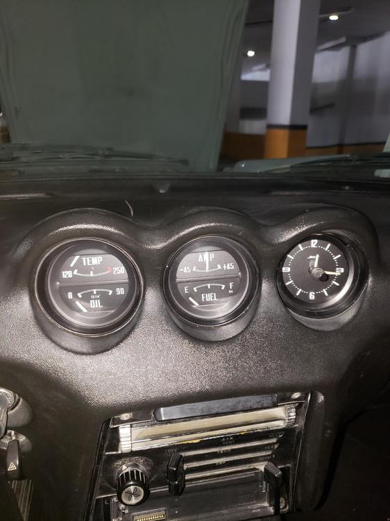

1972 datsun 240z ammeter not working. Easy fix or should i get a used one?
10 hours ago, cgsheen1 said:
No, the needle sits at the center point without voltage or current.  I have one in my hand (and I'm not sitting in a Z...).
Just reading what others have said I don't think your gauge is the problem.
From Steve's post...
If the ammeter has failed completely, typically the car will not start since current will not flow through the ammeter. For starting the car, power goes from the battery, through the fusible link and ammeter, and to the ignition switch.
And that's the starter not the alternator you're checking voltage on.  I'm sorry I can't be more helpful.  Good luck.
Where does the needle point when the car is off?  Should be at the center.  Then when the car is running does it go all the way to the left, negative?  If it stays at the left running or not, I would disconnect the battery and see where the needle goes.  Again, good luck.
Edited by siteunseen

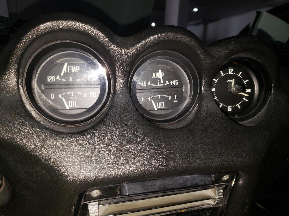

Negative battery pole disconnected, tap given with closed fist to the gauge, needle went tobñ center and viola ammeter working again. Thanks to all of you for your great help throughout these 4 years and exhaustive patience. Happy new year!

Sorry for the misrepresentation of the part. Anyway problem fixed. Thanks to all of you. By the way i wish my air conditioner would blow more cold air. The gen ii mini evaporator need more flow.
@jalexquijano Happy New Year Buddy. Glad you coerced the gauge back into working condition again. A word of caution. The problem will reoccur and too many thumps on the plastic faceplate will eventually crack it. V.O.E. Don't want to hijack the thread but how's your Z running these days?
