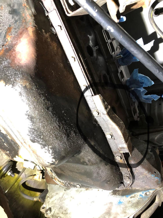

Hi guys im wondering if any of you know the function of the metal bracket that is held in by the oil pan bolts on the driver side? It has a metal heat shield or something that is attached on the bracket. Im currently trying to fit my header on but the heat shield is in the way. Is it okay to remove it? any use for it? thanks for any help

You could possibly bend it up, flatten it a bit, it is keeping the oil pan gasket from getting too hot and burning but then I've seen many cars where that flange has rusted away without any problems.

Mine worked with MSA's 6 to one ceramic header but I did have to trim some off the transmission's extra bulk so it wouldn't touch and rattle.  Not a big deal but I'm going by my header, no idea what you have.  Good luck.
