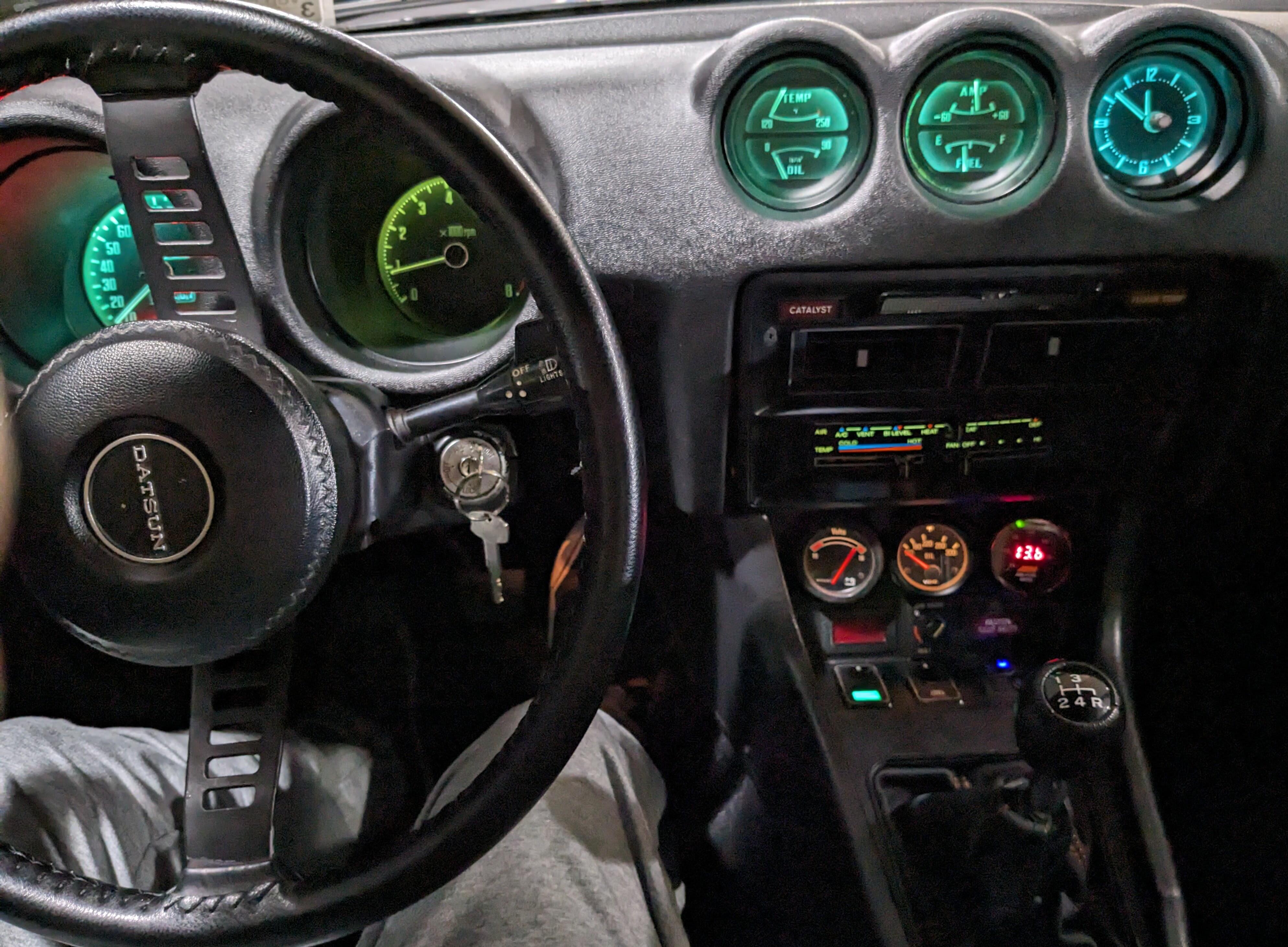

Ya, bright. Phone video doesn't really do justice. I run them about half speed around town, turn them down when I'm driving in the hills at night...

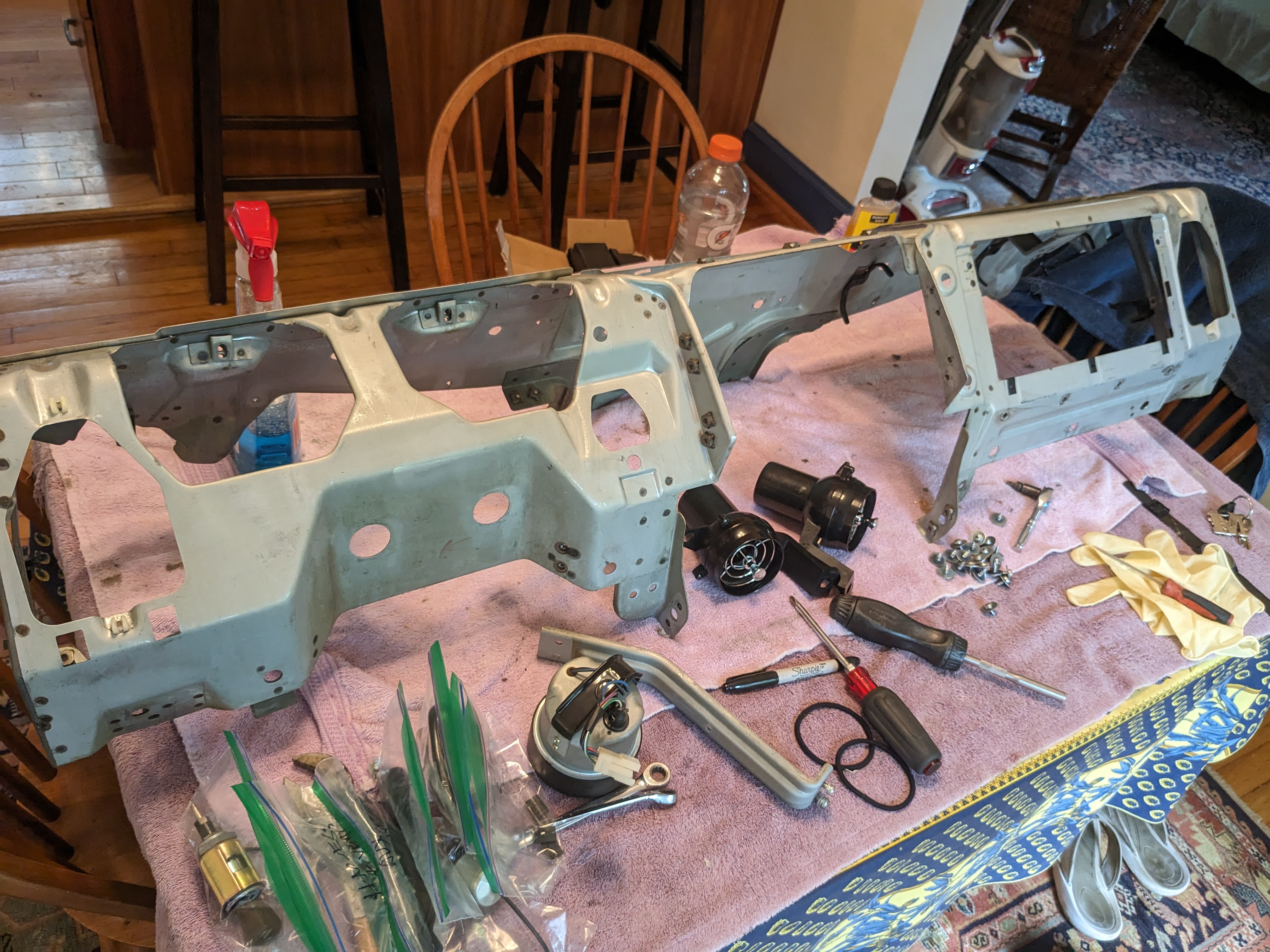

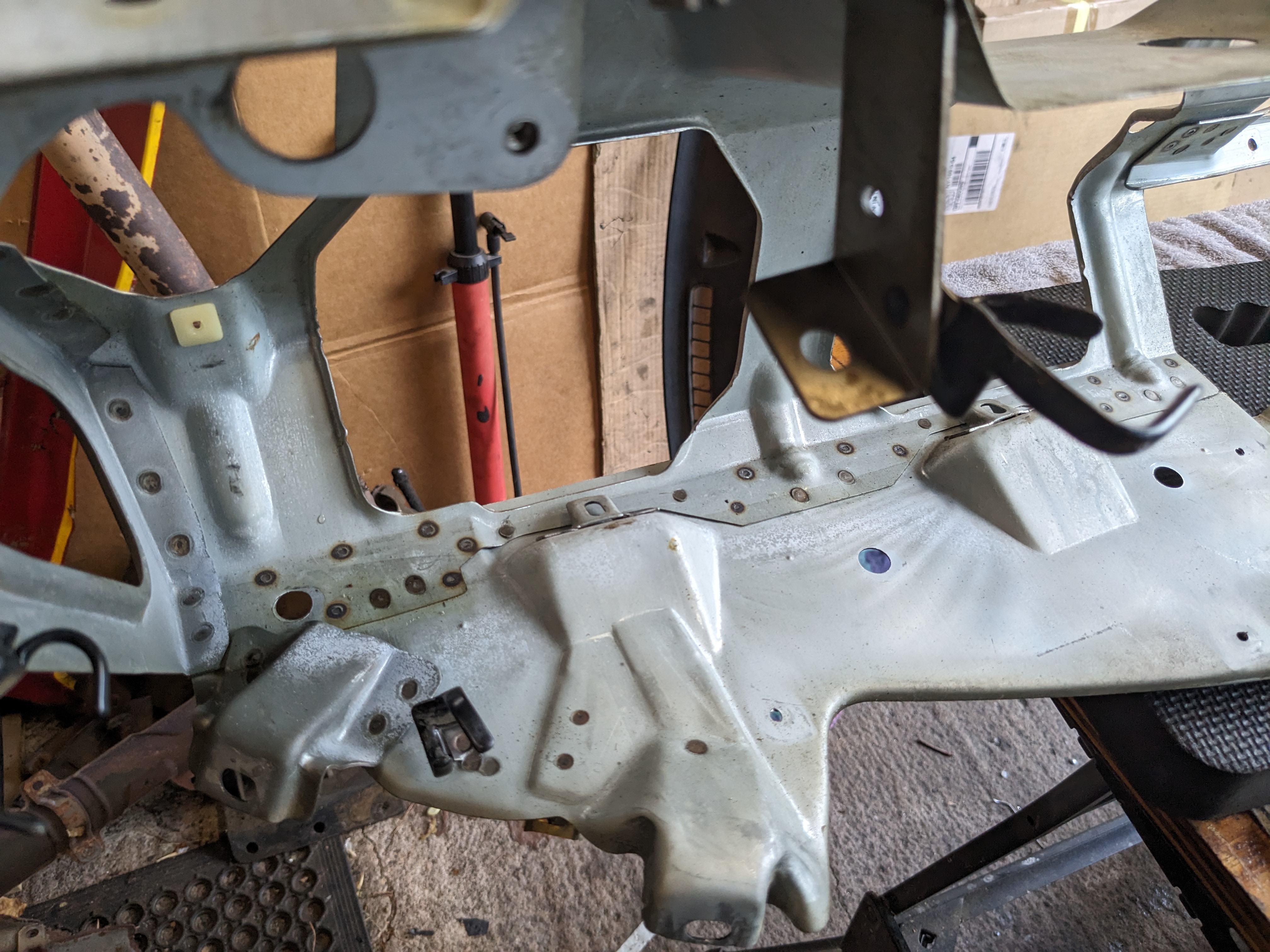

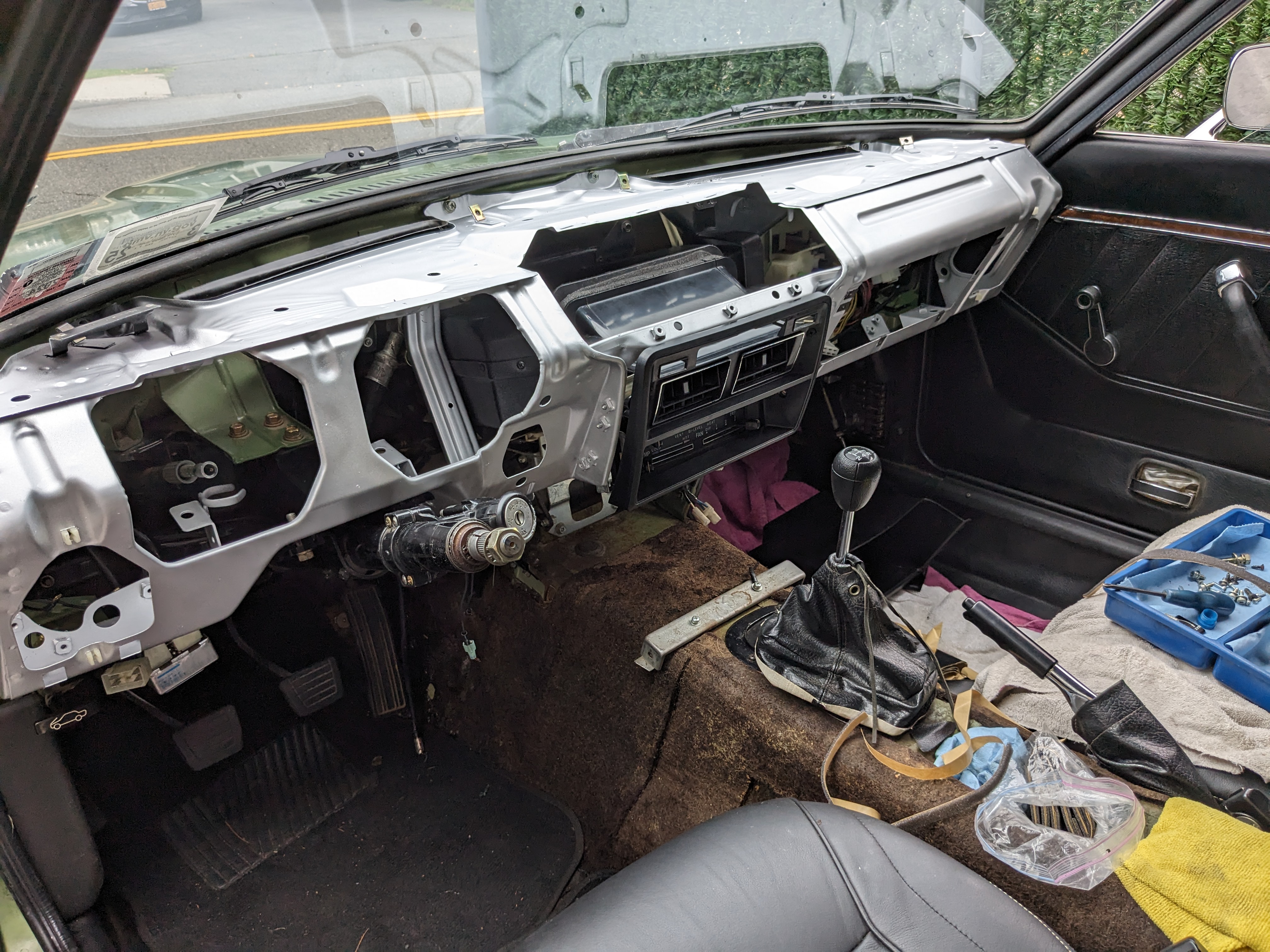

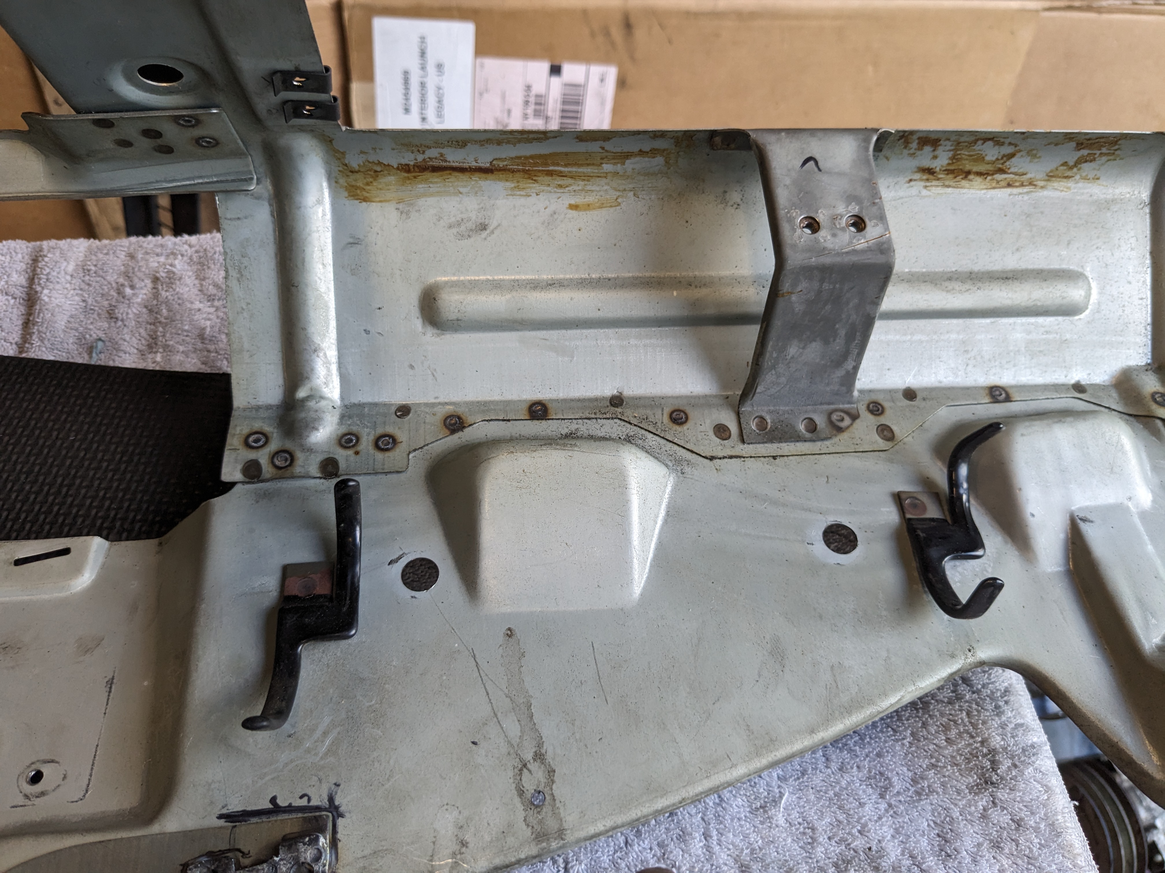

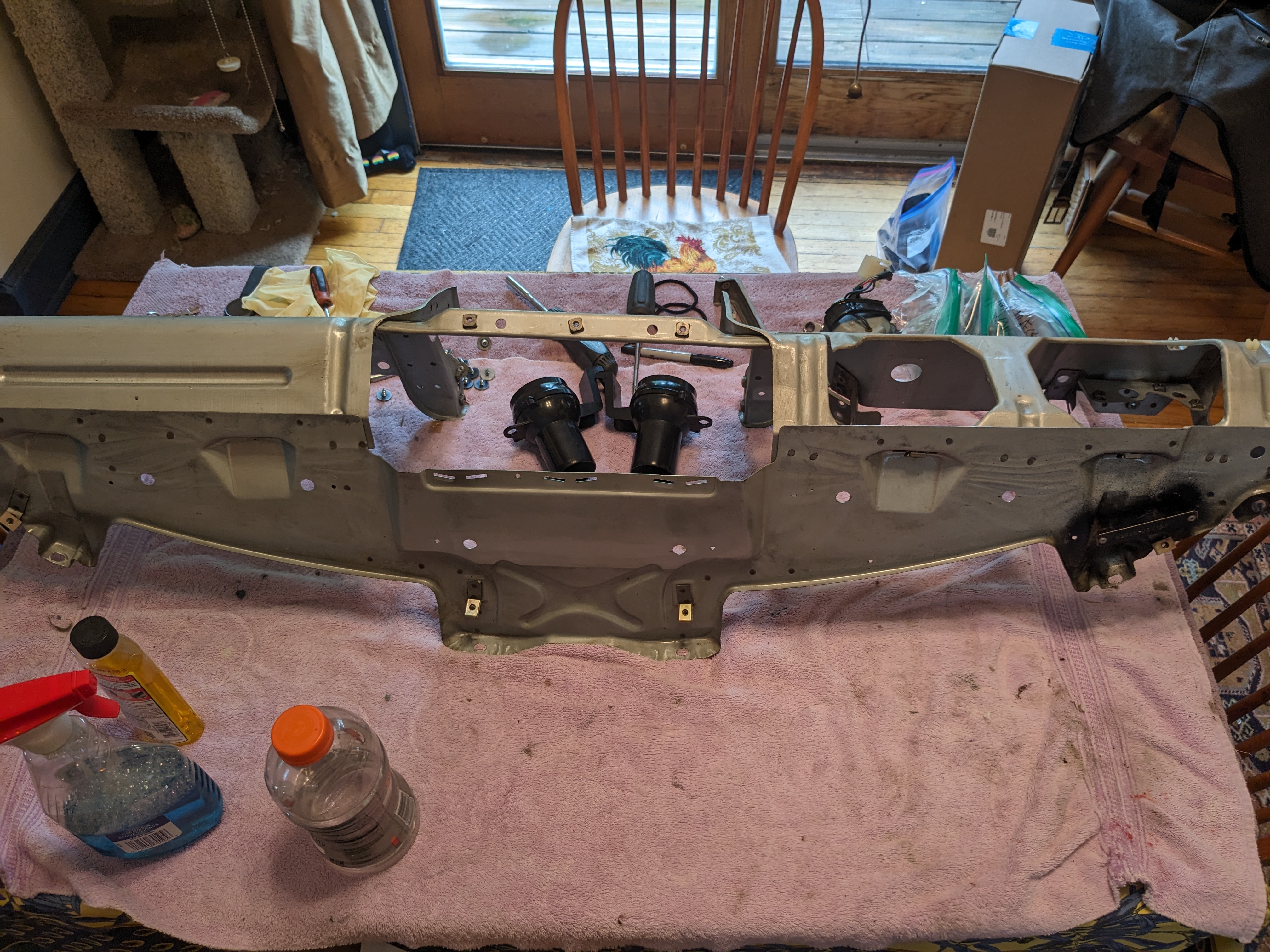

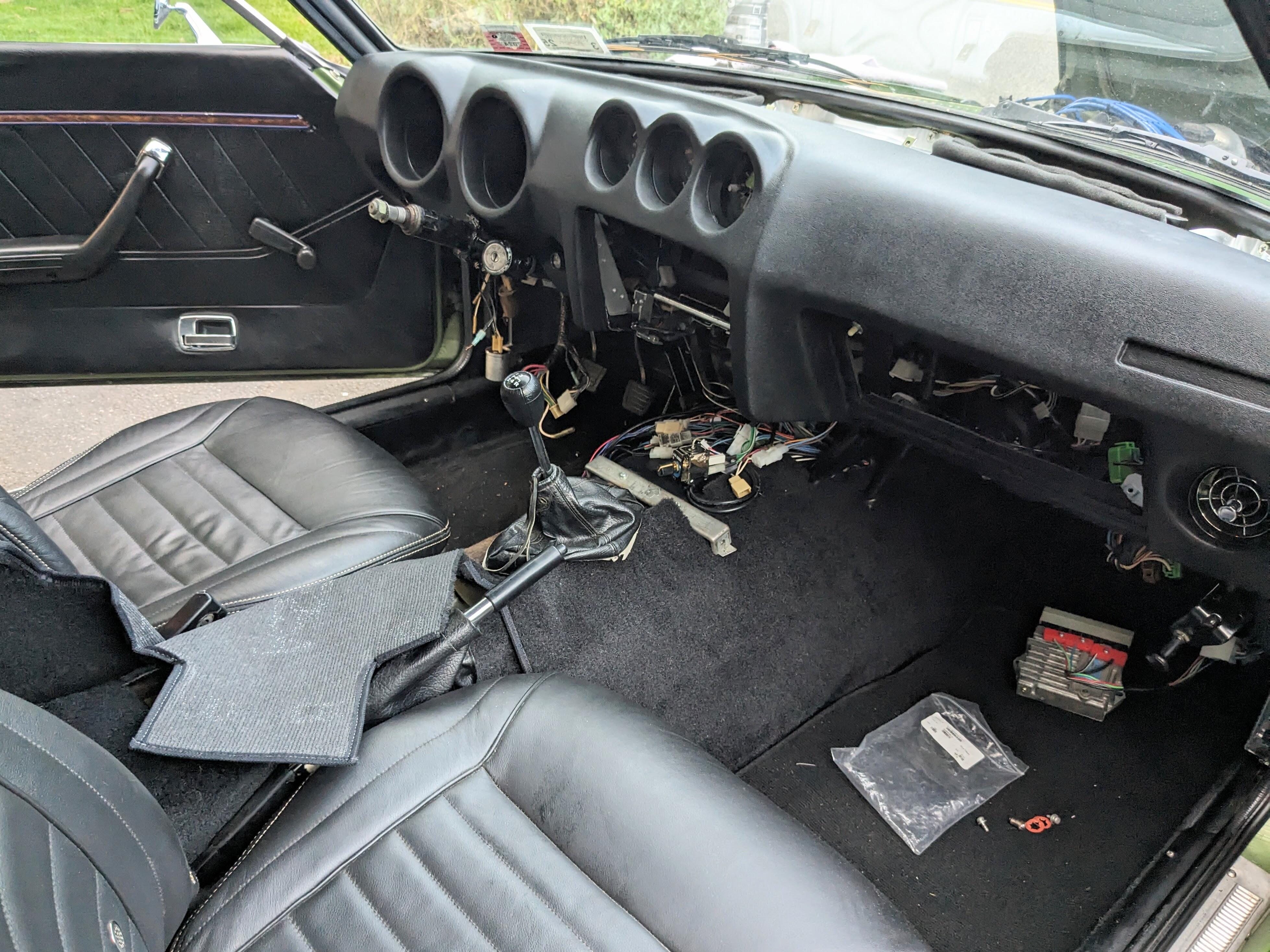

Pulled my dash during the week, today I stripped the frame

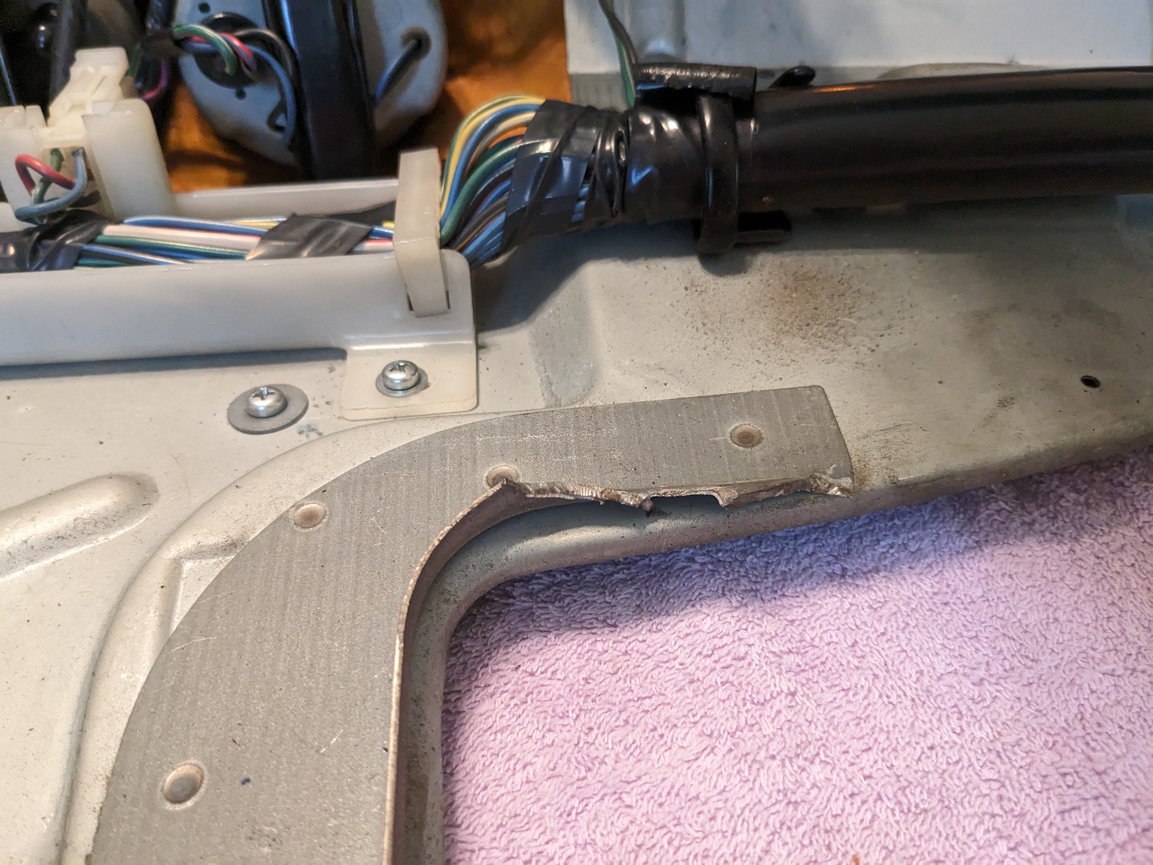

The right center support was cut off - I assume due tot he aftermarket AC evaporator box. I'm going to have to figure out how to make a new one. I'll install the stripped frame over the HVAC to see how I can add one back. I'll also add some more spot welds in-between the existing welds to reinforce it. I'd like to make sure my new dash says unstressed as possible.
The construction & assembly on these Datsuns is very nice. Harnesses properly secured, everything well organised, very tidy indeed!

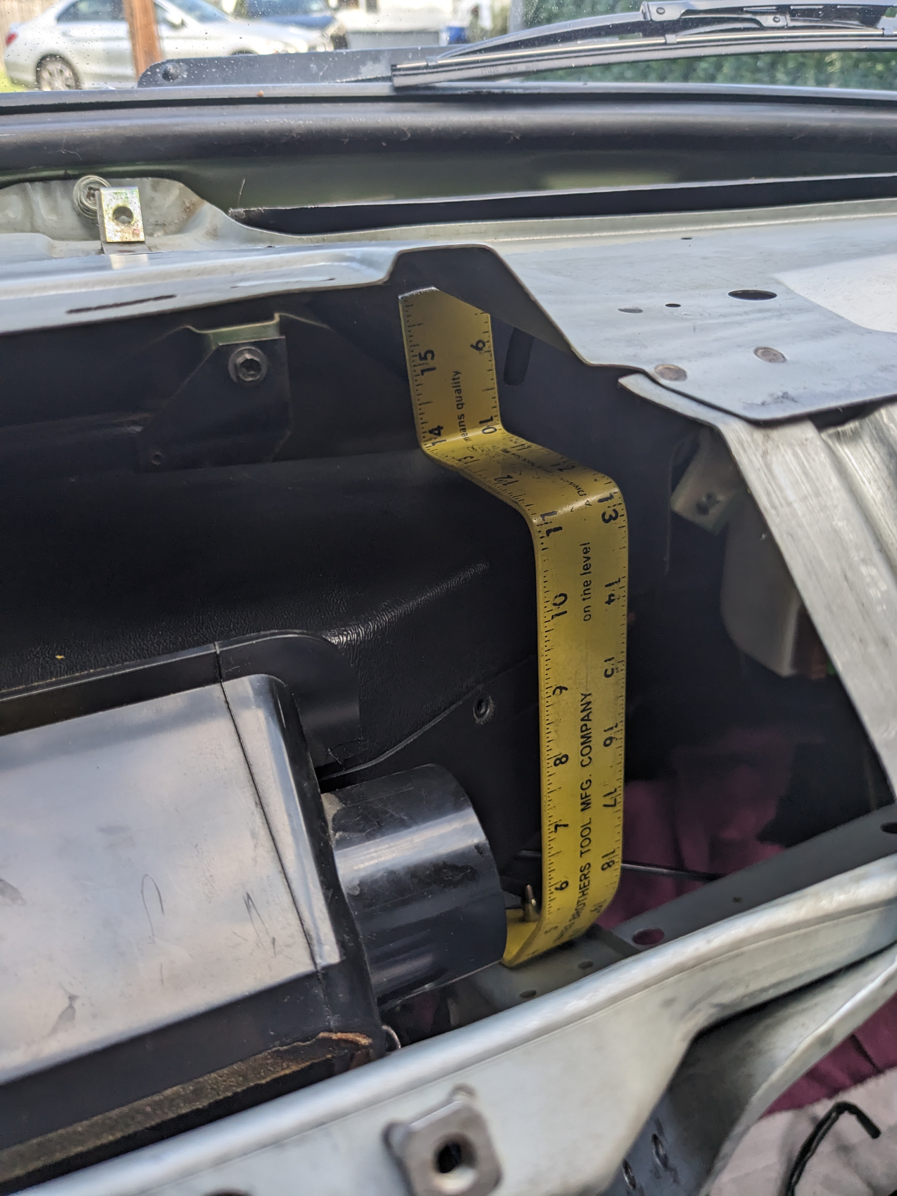

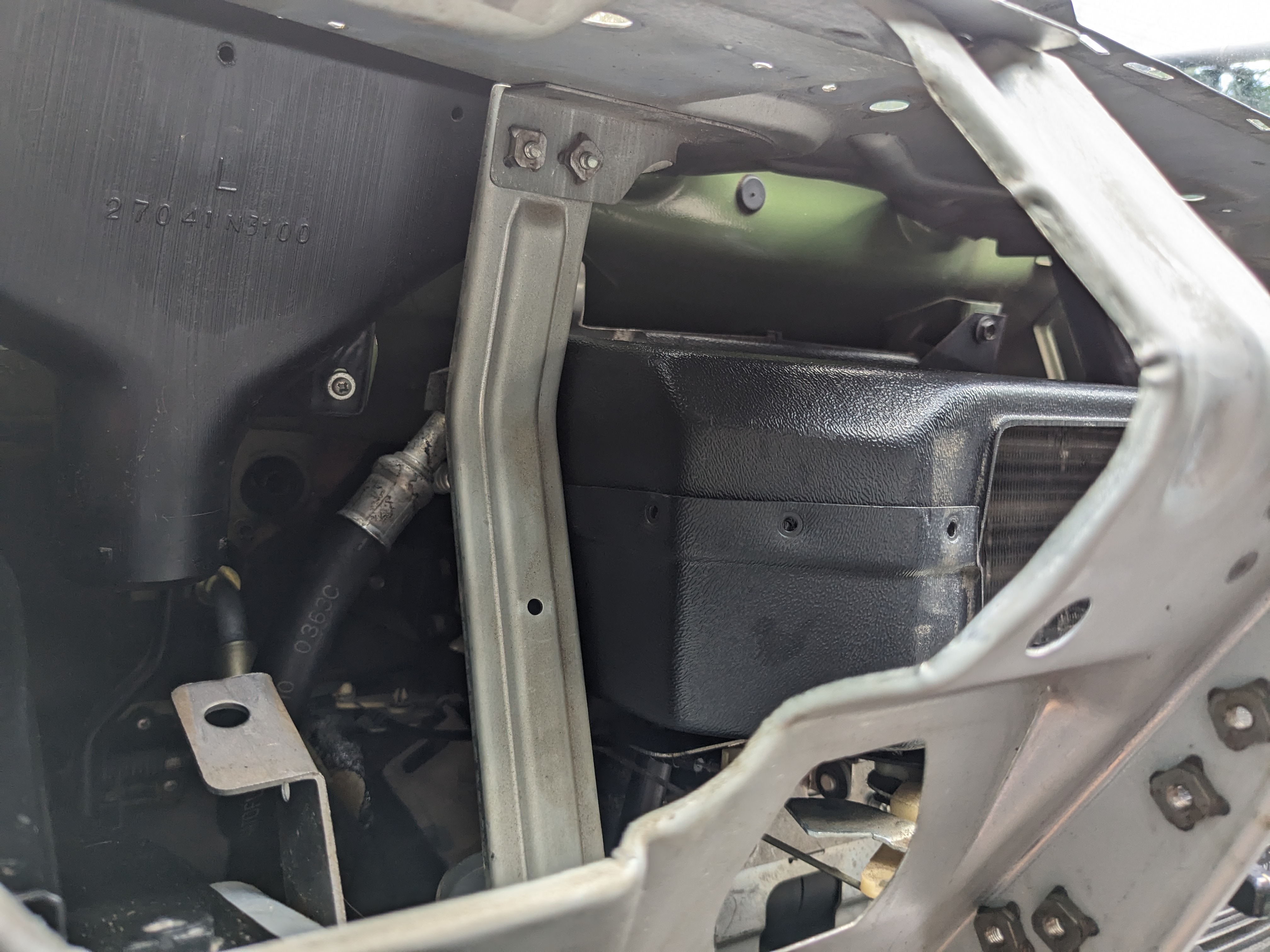

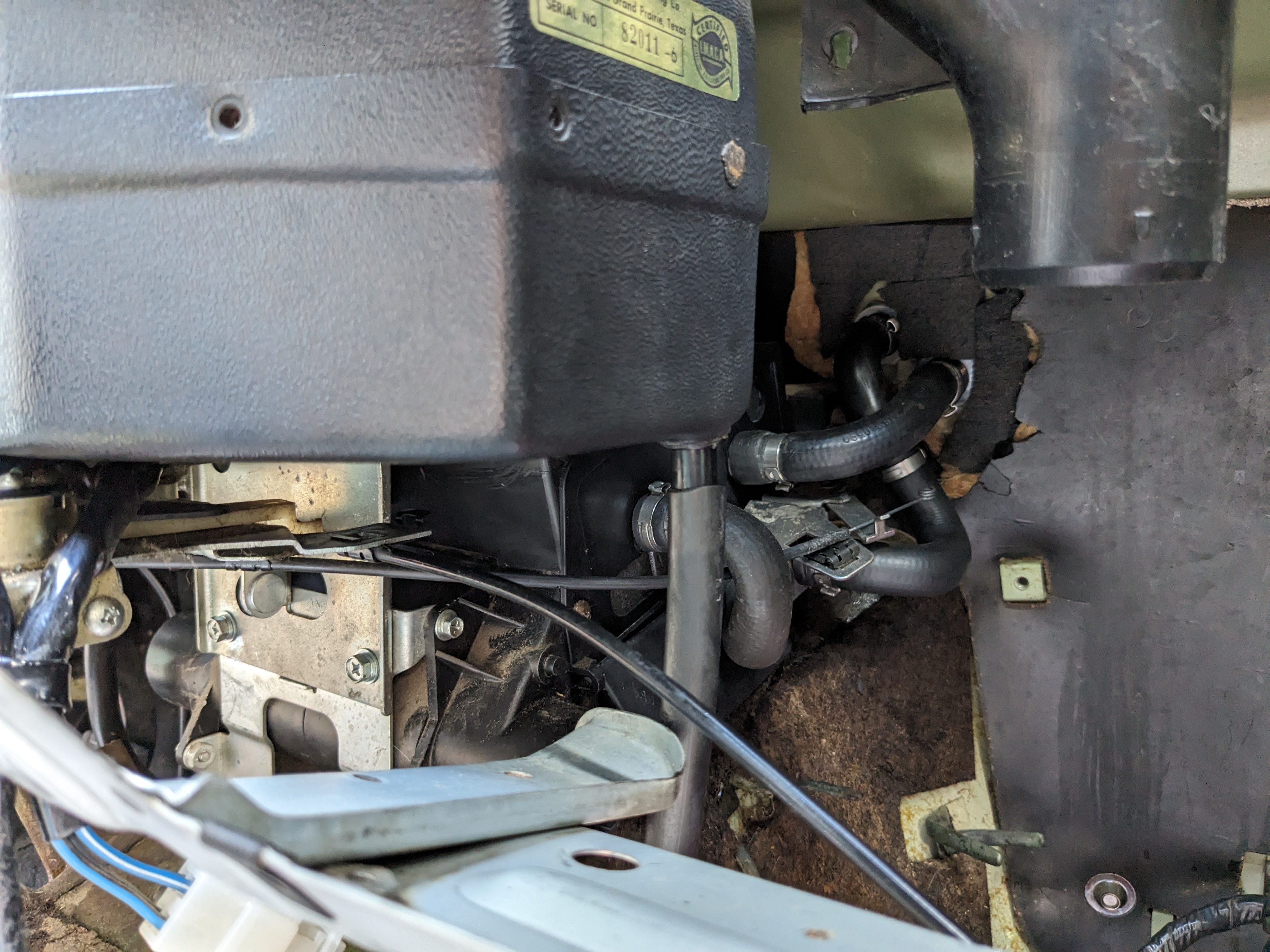

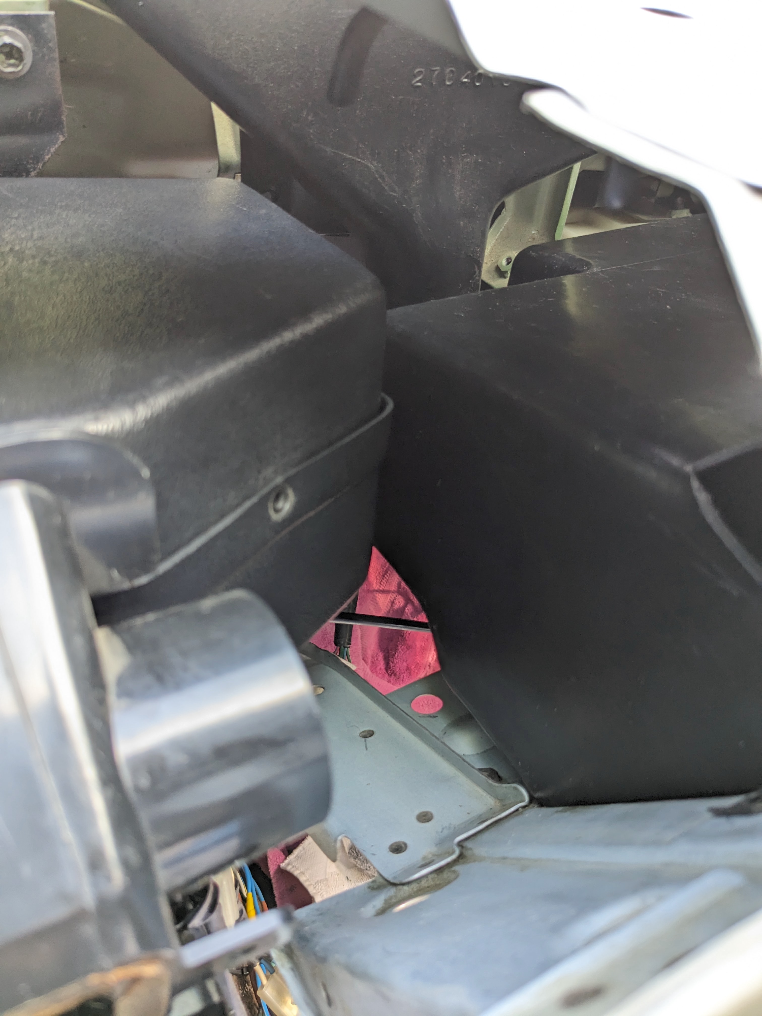

Had a little time to work on the dash today, so I put the frame in the car to figure out the right side support brace
Left side brace sits right up against the box

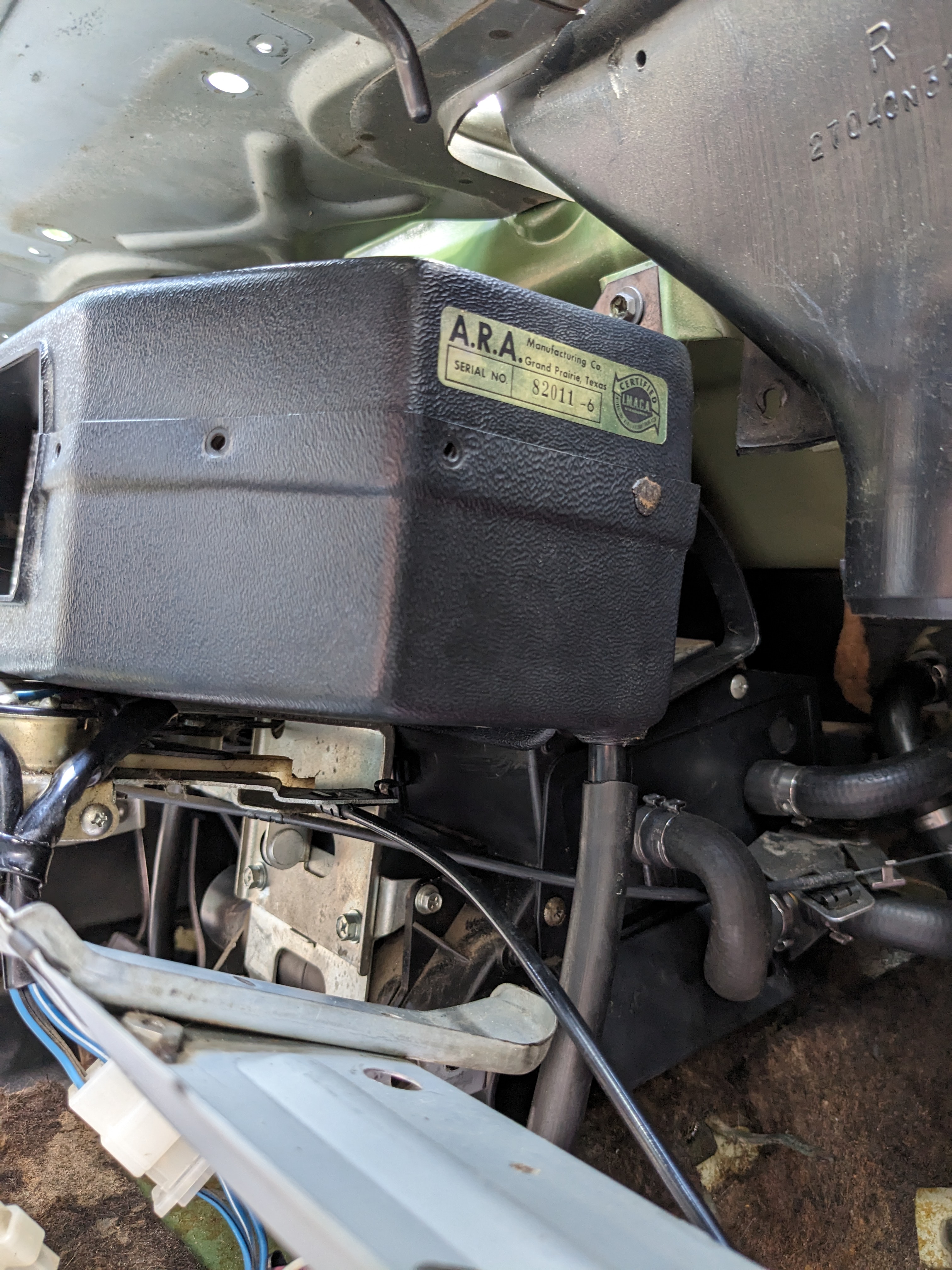

Right side - definitely was removed due to Evaporator

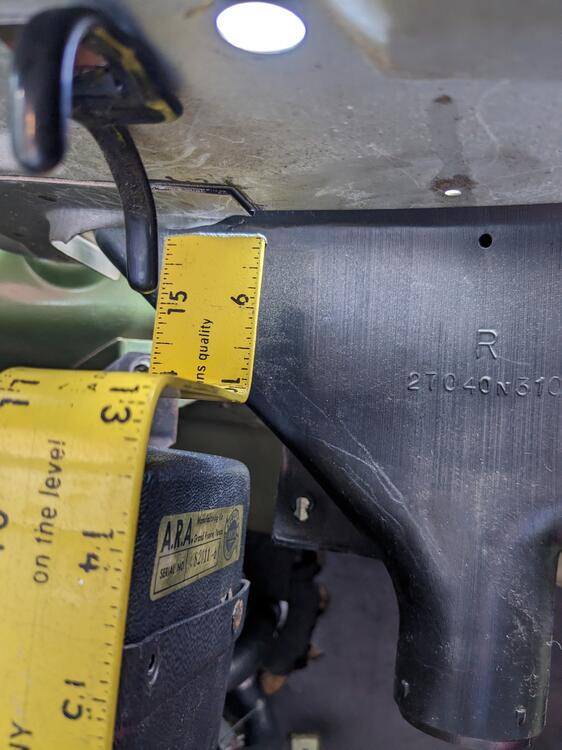

set the glovebox in place, to check clearance outside the evaporator box - none

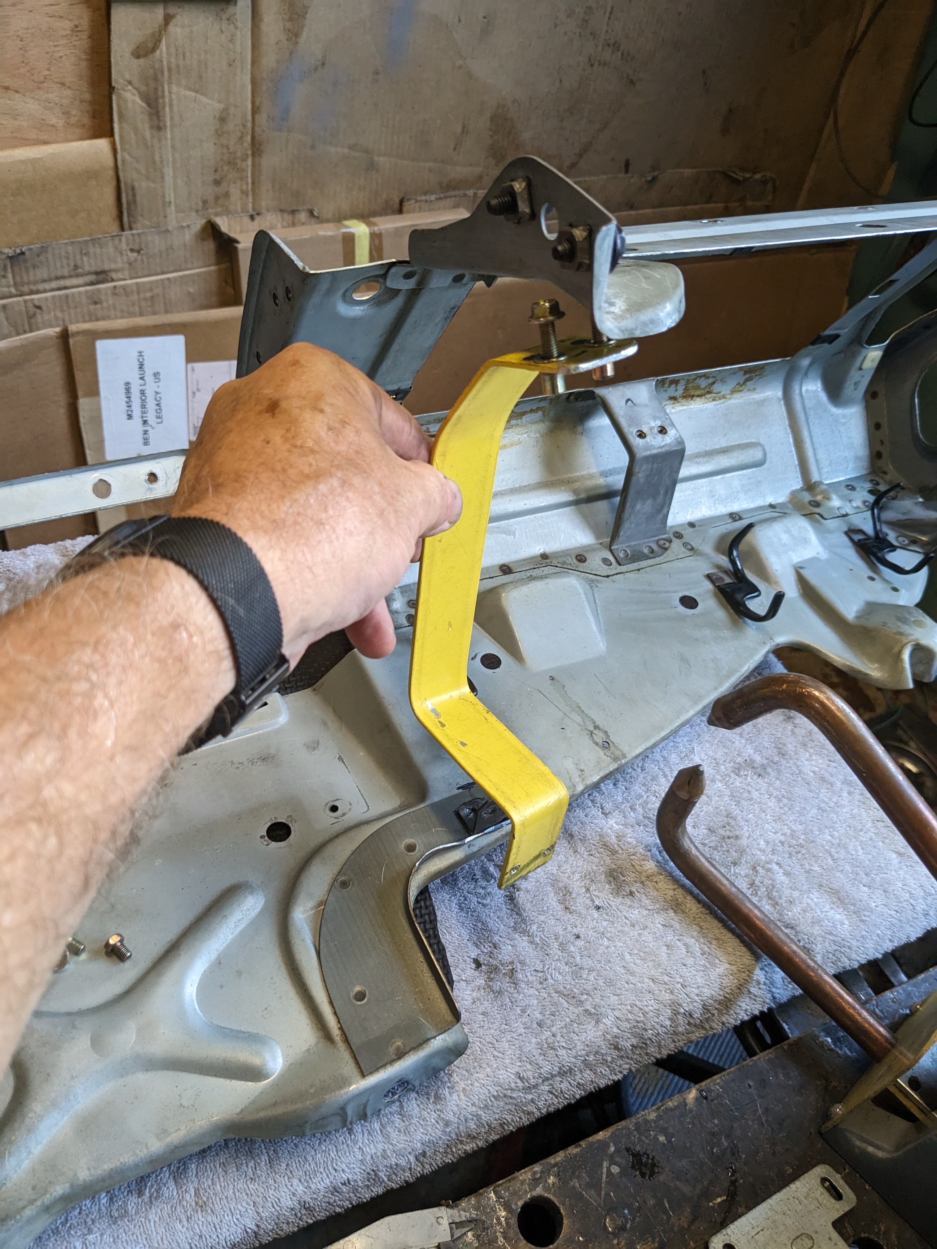

Used a aluminum ruler to make a brace
I'll add an angle bracket back to the dash frame, to attach the brace to

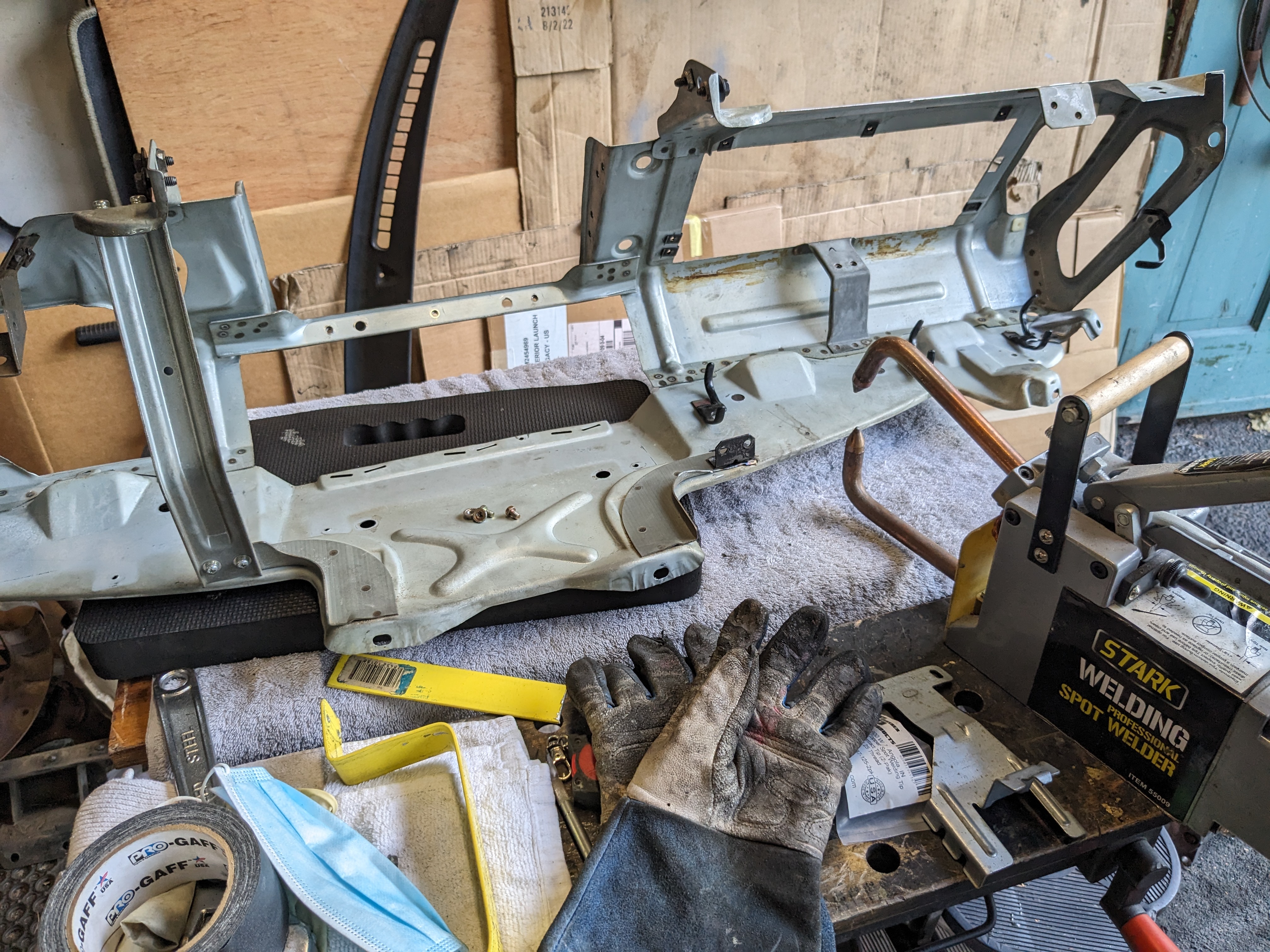

frame back out to finish up the angle bracket for the brace & add spot welds to the existing structure

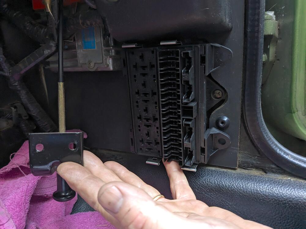

Going to replace the fusebox with an MTA 15 ATC fusebox, and a (4) relay panel

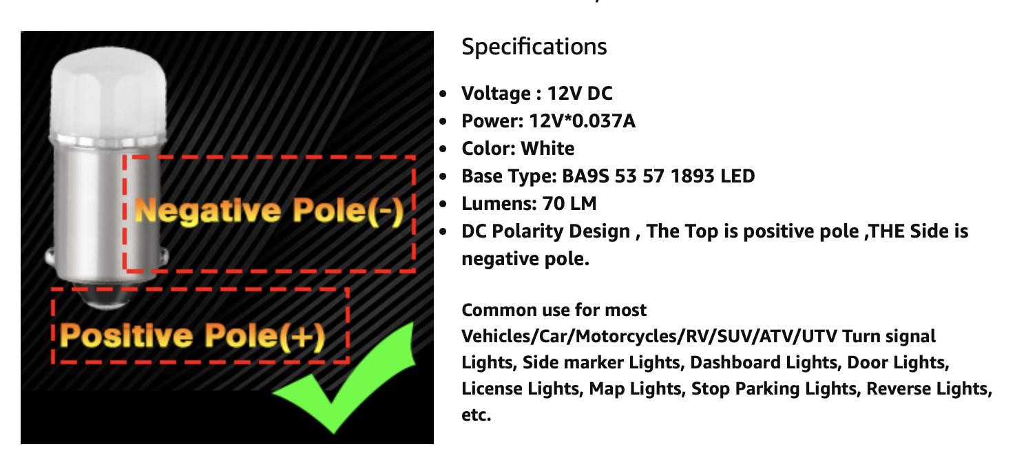

I bought a 10 pack (white) of these today - specifically because they indicate they use the same polarity as a DC bulb, and because you said they work with the dimmer. I personally dislike intensely the extreme brightness of LED bulbs, so being able to dim them without adding an extra circuit that makes them dimmable is essential.
The other ones (Kieurot) linked do not appear to be polarized, and appear to be on the long side, based on the pic provided
Edited by HusseinHolland
If you are using stock gauges with stock wiring, the speedometer has reversed polarity from everything else in at least one bulb socket. 🤦‍♂️
Make sure your bulbs can handle reverse polarity. I know that's covered in a thread somewhere on here. I added the bulb to my list after another member told us he found one.

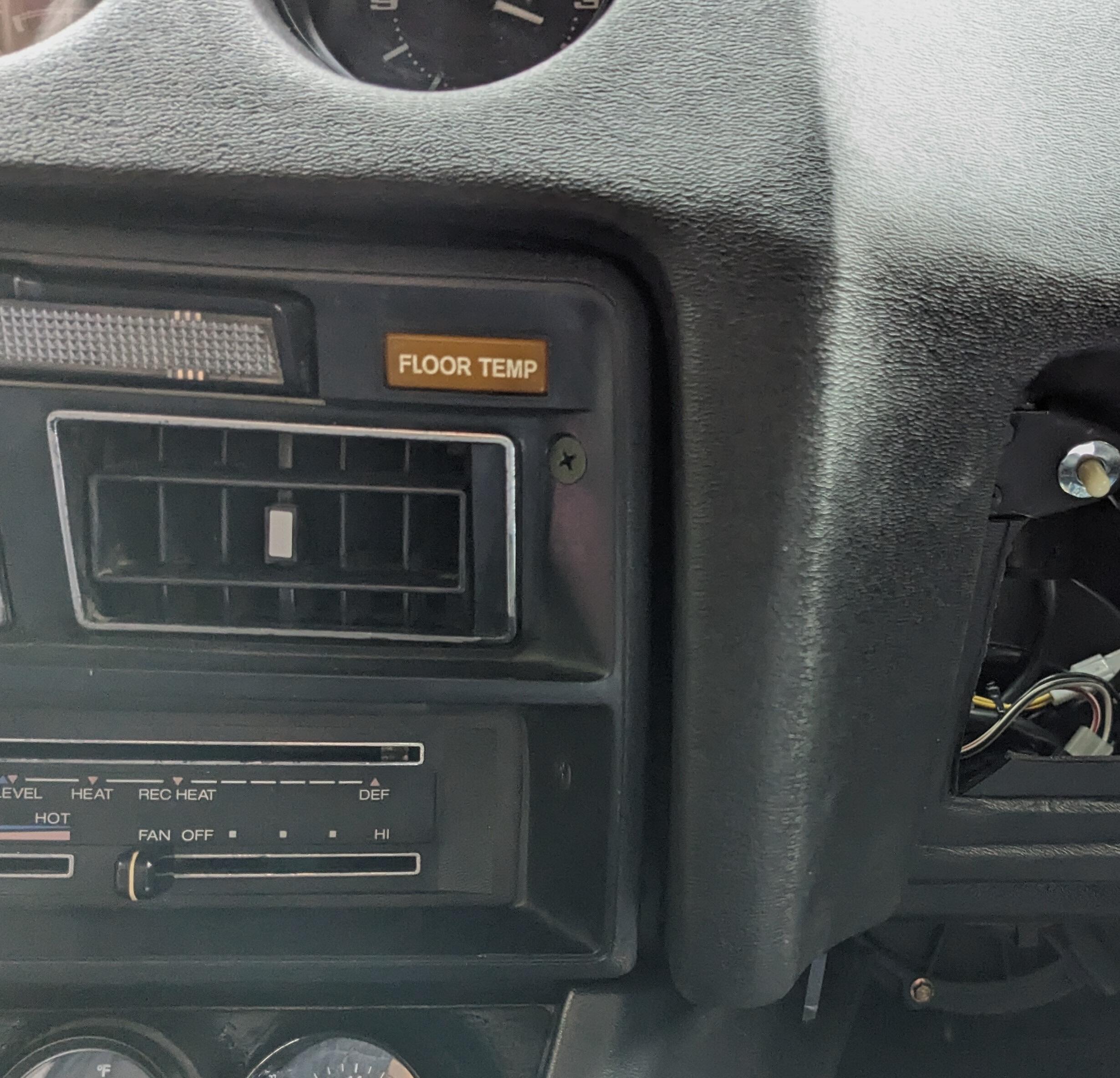

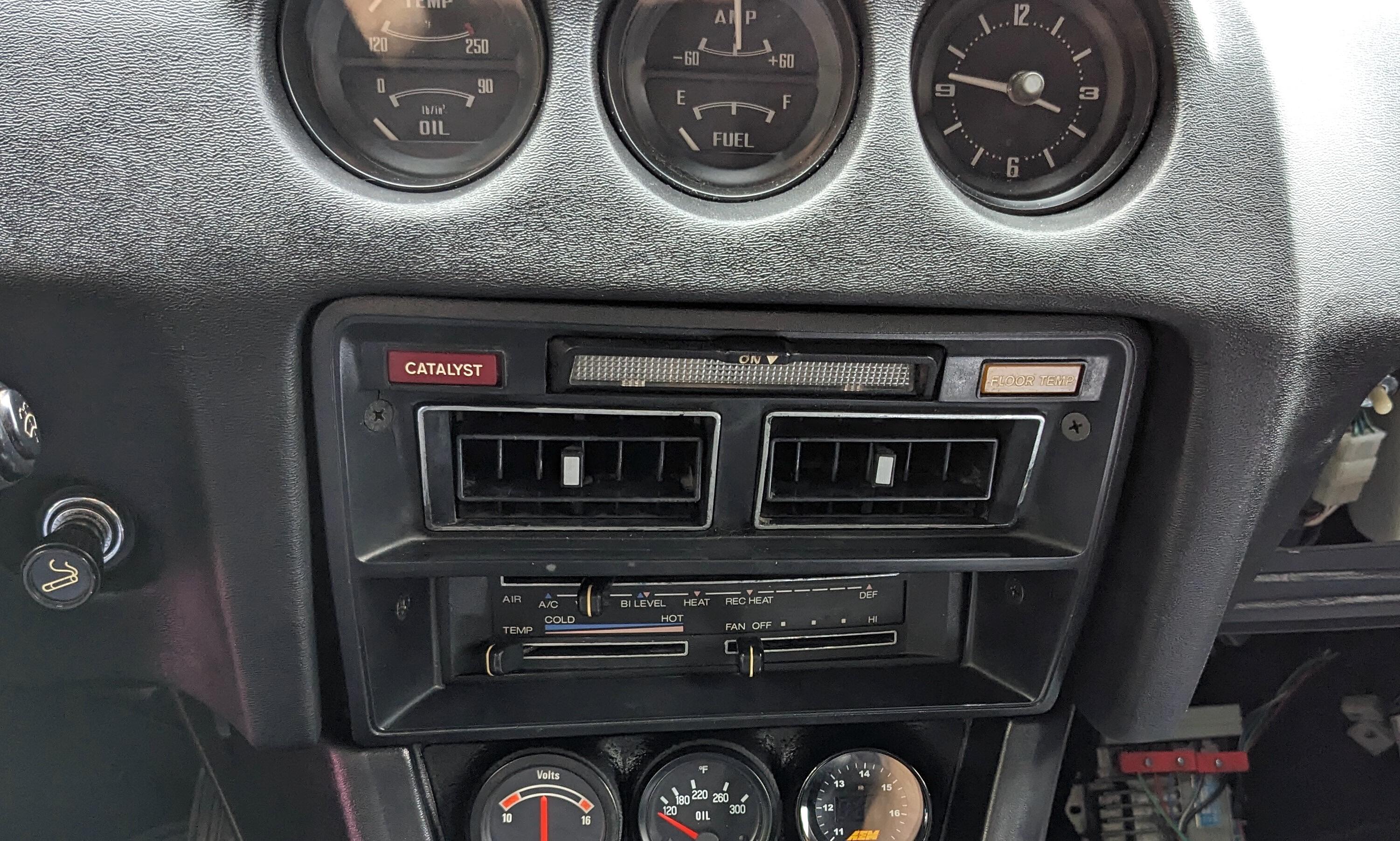

Finally getting the Vintage dash back in. Fit is very good, however there does seem to be excessive gap on the vertical surrounding the center console trim. I'm wishing I hadn't precut the excess vinyl to match the factory in this area. I'll add a pic later to illustrate. I left much of the excess material in the glove box area, I'll deal with that when I'm actually ready to install the glovebox. Have to deal with all the HVAC ducting before that happens
Center opening gap difference Left to Right
Didn't notice with the original center console whether the dash aligned with the uprights. or if its staggered like this

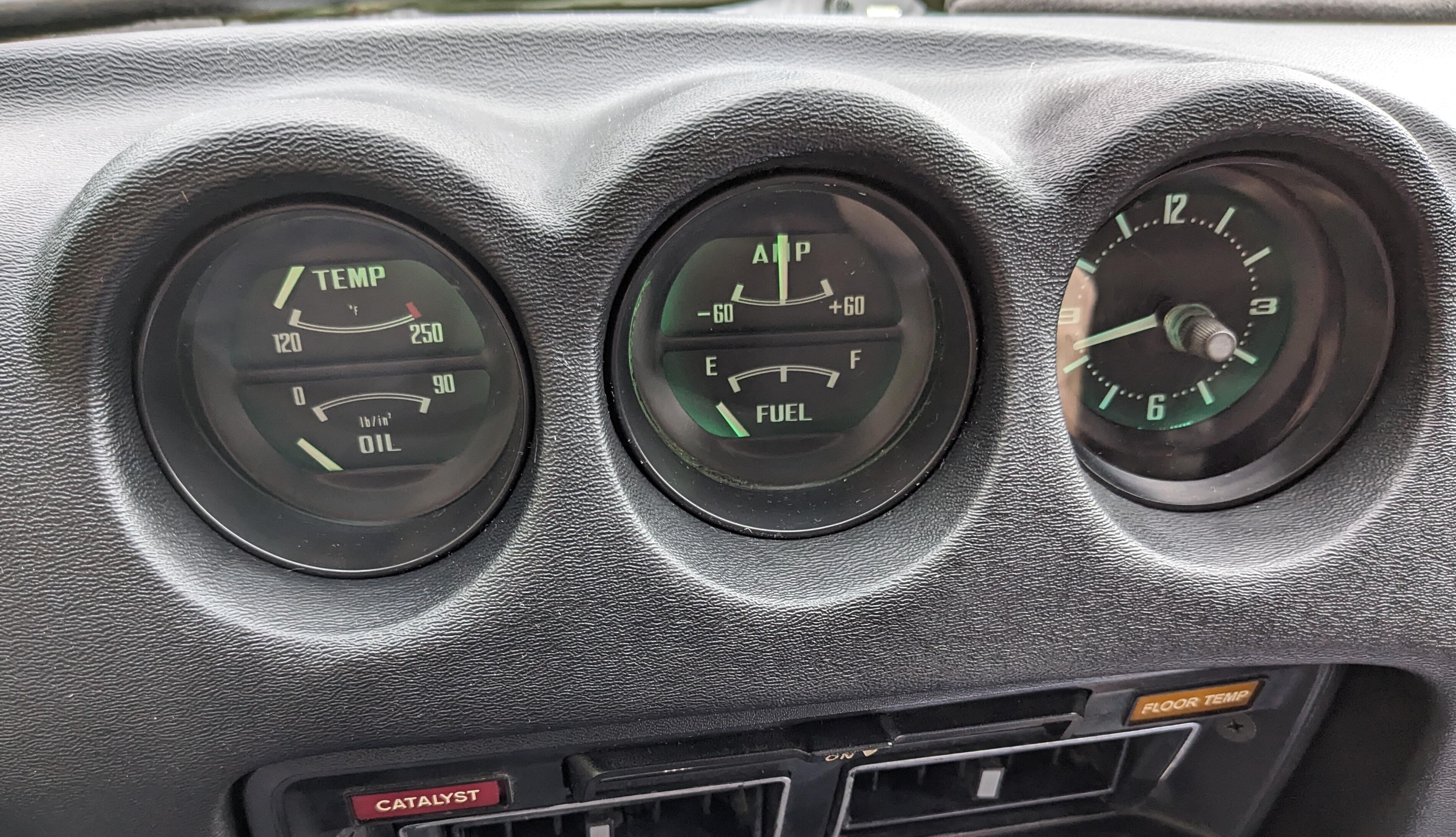

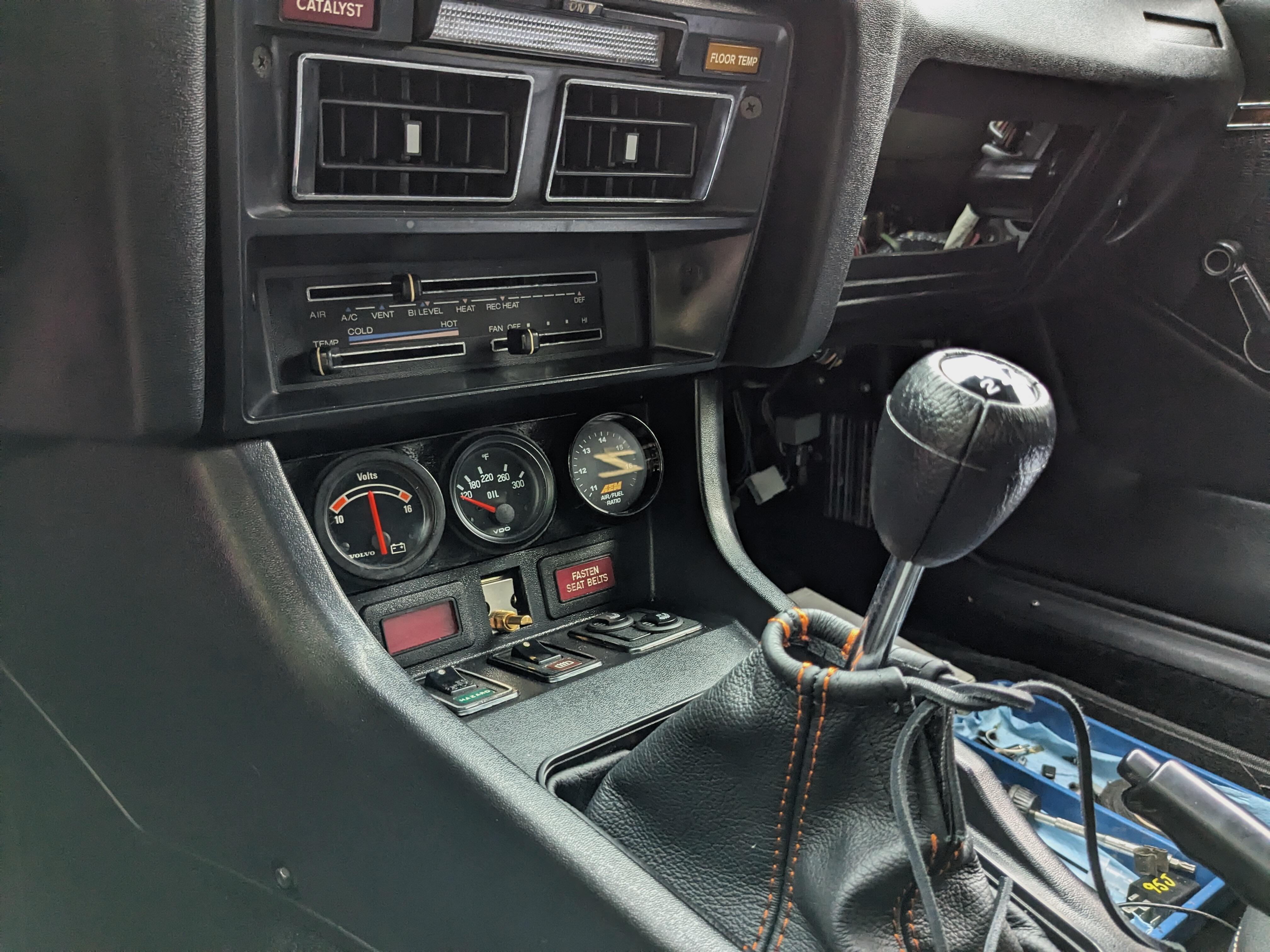

EDIT - forgot to add pics with the LED bulbs illuminated

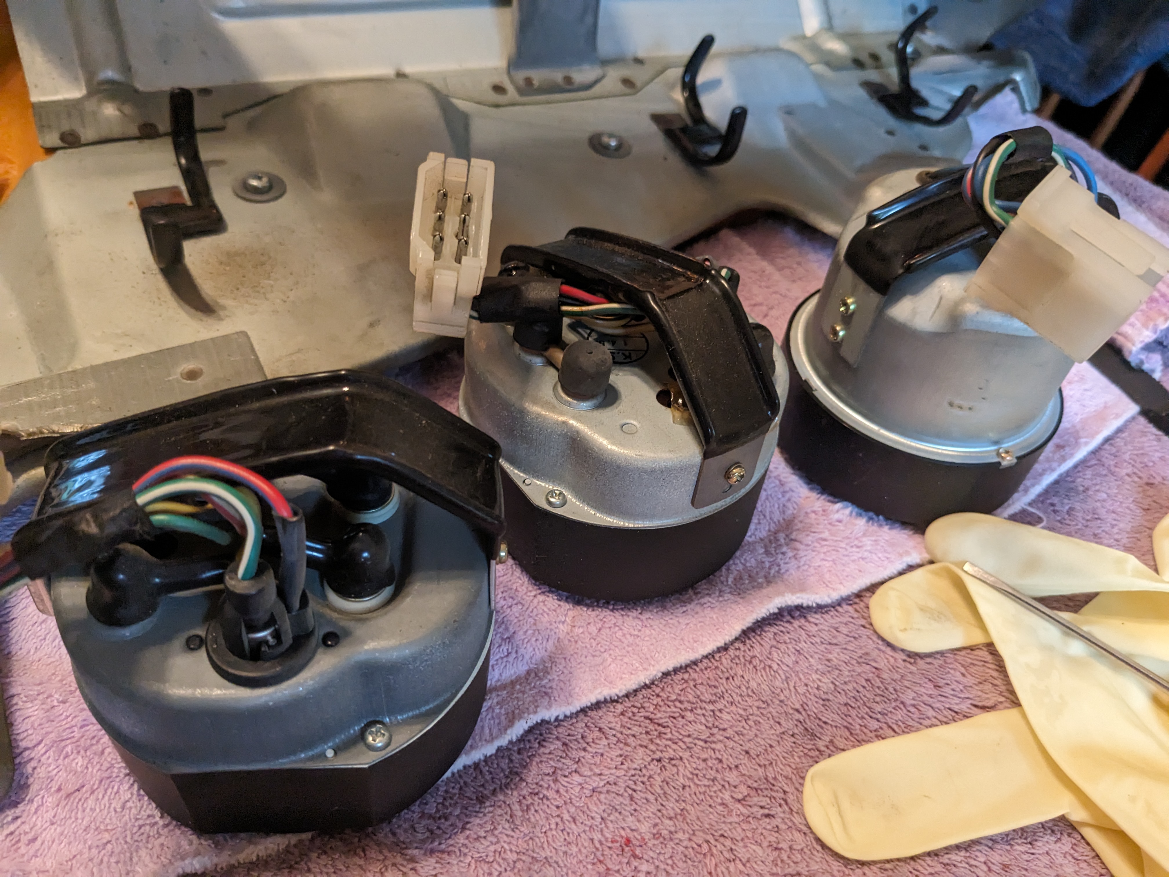

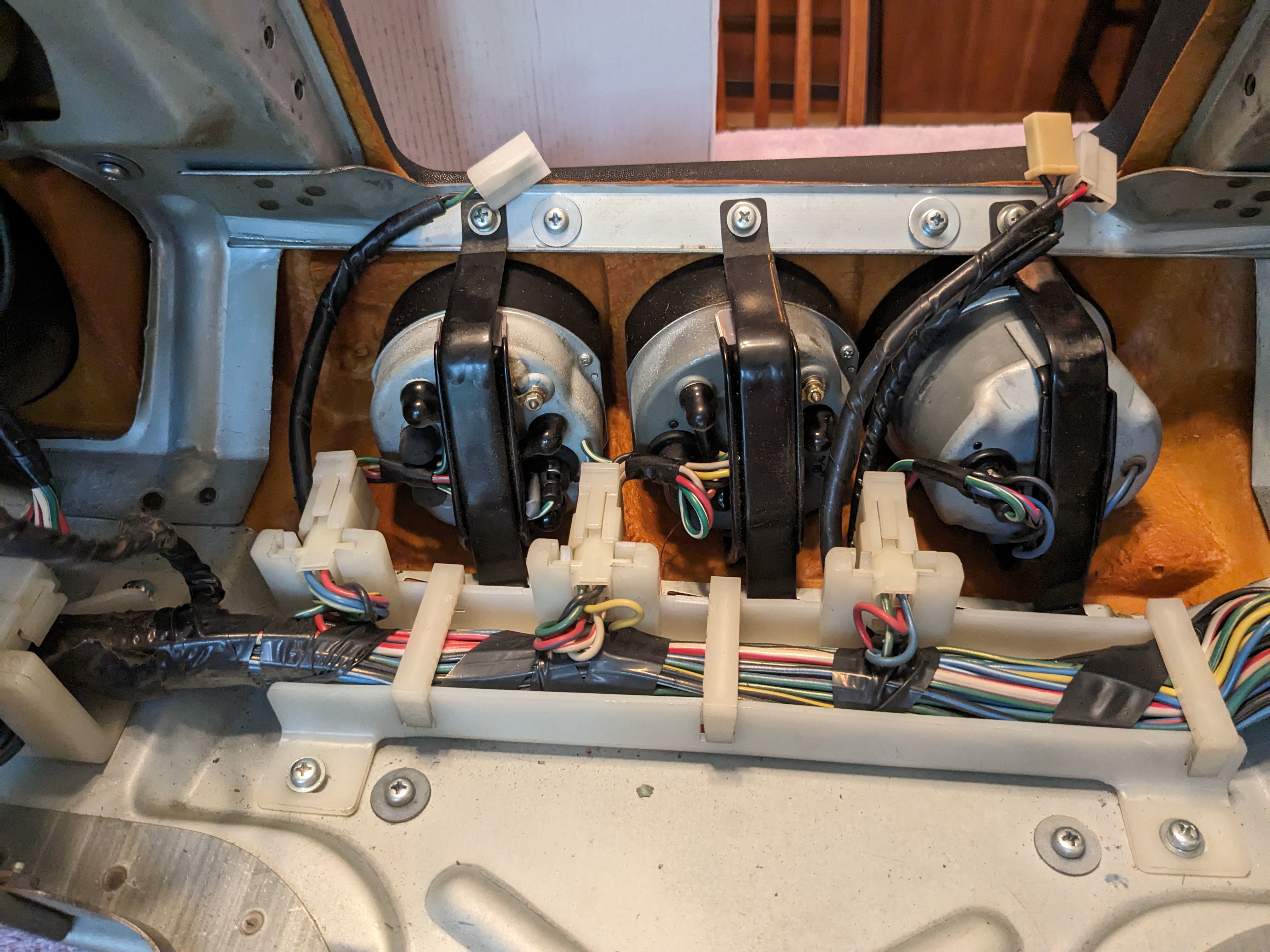

AS SteveJ mentioned somewhere the Tach lighting has reversed polarity sockets, so I use conventional bulbs there. Not quite as bright.

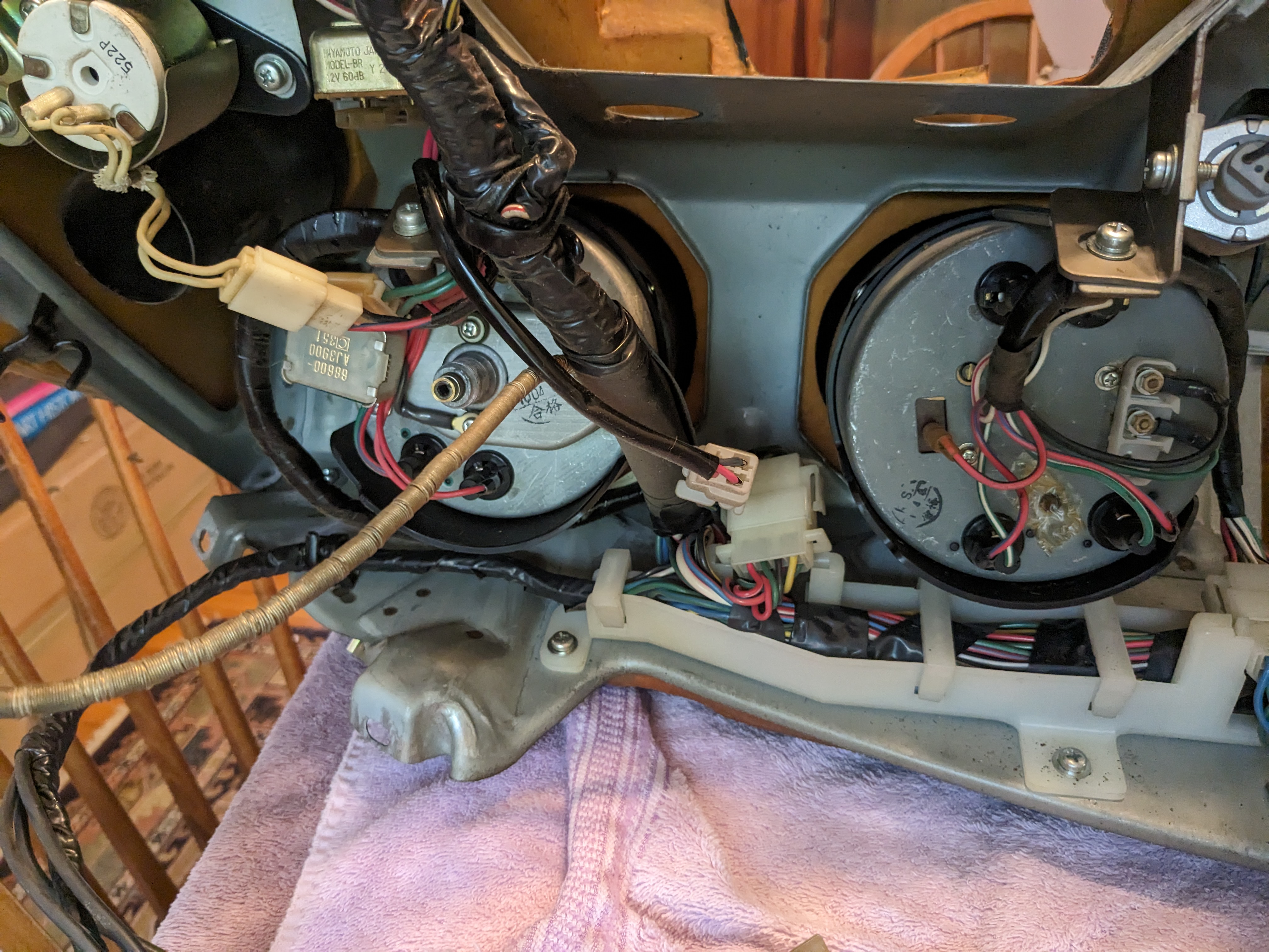

Had one of the new LED bulbs fail - the one in the AMP/Fuel started pulsing on/off. Swapped it out after confirming the power, ground & rheostat wiring to the gauge assembly were all not the issue. Interesting that they appear different color cast in the photo - they are all the same bulb. Secondary gauge pod have standard incandescents.
