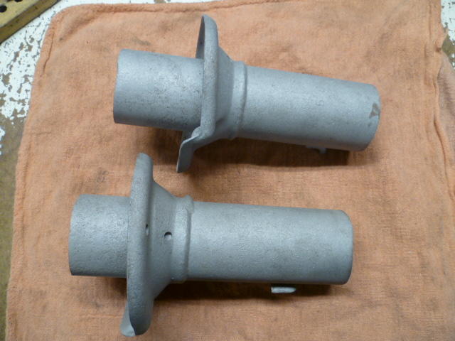

Here's where the project stands. I got the strut tubes from you (I thank you again immensely):
I chucked them up in the lathe one at a time and cut the spring perches off the tubes:

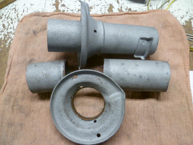

Here's what they looked like before and after they met Mr. Lathe:
And here's both of them done:
And that's where the project stalled. They've been helping hold down my workbench since this point.

So you spun up the tube and cut from the inside until the spring perch broke loose?  How did you avoid having the perch and the separated part of the tube create a jam when they dropped free?
The process went like this. Chucked them up in the lathe and cut off the remaining lower portion of the original tube:

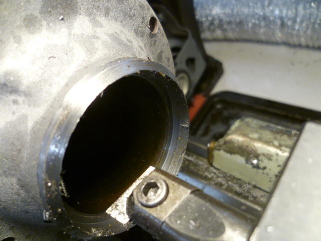

Then once that was out of the way, I went in with a boring tool and opened up the inside diameter:

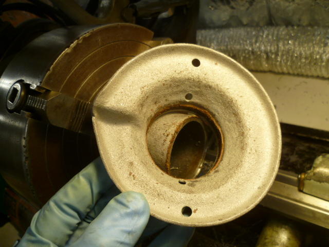

Bore out the ID a little at a time just until the original tube has been cut out of the perch ring. Once that happens, the perch can be pulled off:
