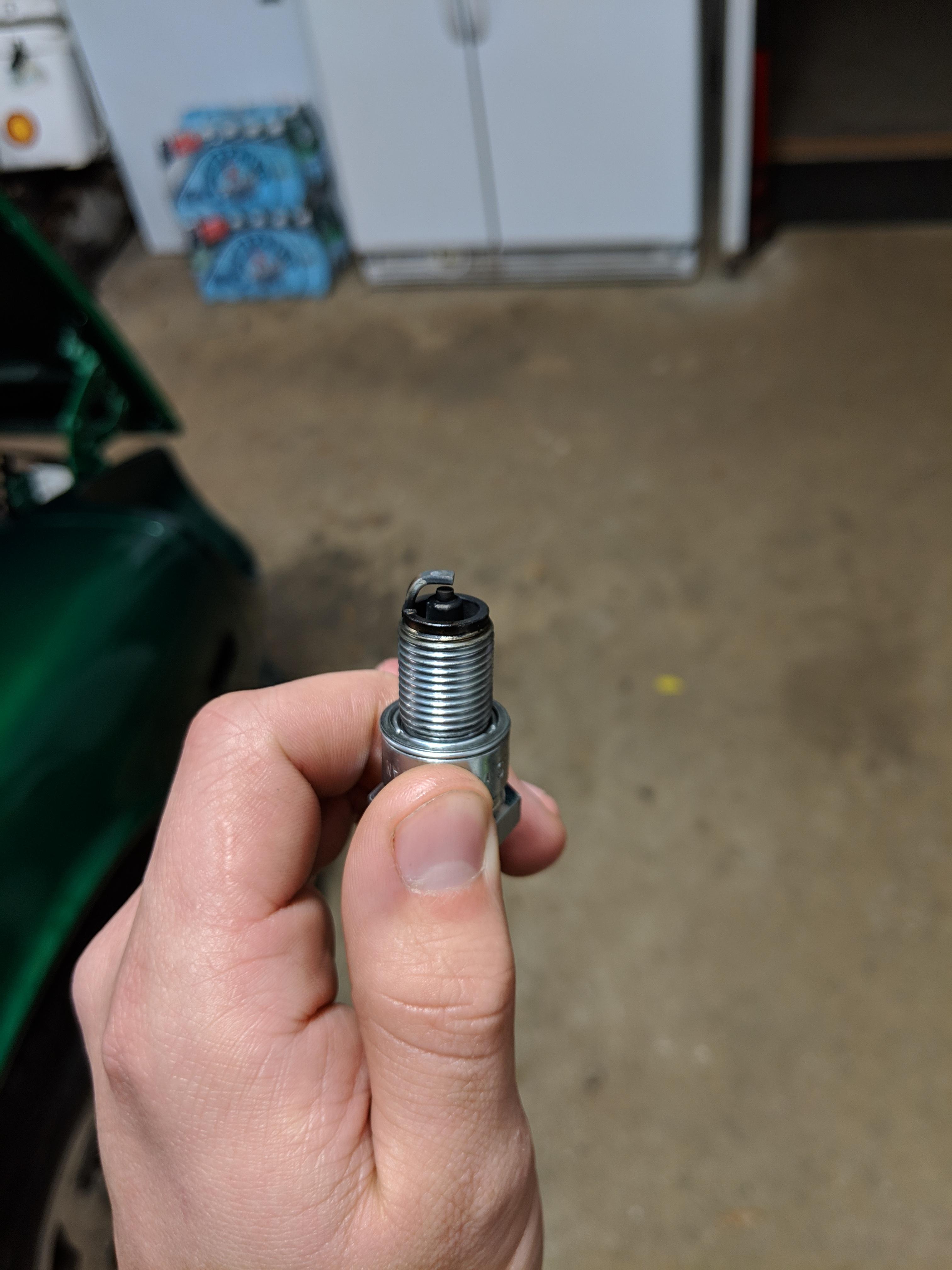

I have a 1978 280z that I've recently put back together after rebuilding the engine, rust work, and paint. I've gotten the car to the point that it has run three times for various lengths of time. The second time running, I timed it and got it as close as possible but ran out of adjustment on the distributor. When it ran this time I had it on for around 25 minutes and with the initial break-in done decided to go for a ride. I made it 1/2 a mile down the road before it died grabbing fourth and wouldn't run afterward. After an emergency tow home, it would briefly fire up for maybe one second and then die. The next afternoon I tested to see if I had fuel flowing to the rail (I haven't tested pressure) and there is definitely fuel flowing while cranking. Knowing this, I tried running it again and it fired right up and idled for about a minute until I pushed the clutch in to back out of the garage where it died and would not restart. At this point, I have done lots of troubleshooting to get it to this point and any help would be greatly appreciated.

Try cleaning all plugs with carb cleaner and brass wire brush then see how long it will idle.  If they carbon foul again then you have too much fuel.  There are a few causes. Give it a go then get back to us.
I cleaned the plugs this morning and after it fired right up and ran for 10 seconds and died, I could still hear the fuel pump running afterward though.
