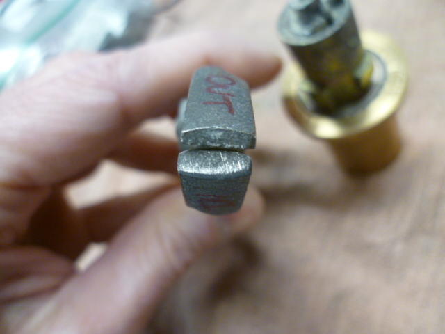

So for those of you that I haven't scared off yet, I got a couple minutes to take a previously unmolested door lock apart. Here's a lock, my anvil holding fixture, and my home-brew face cap pliers:
For the pliers, I ground one tip down a little so it's slightly shorter than the other leg:
And I ground a radius into the jaws to kinda sorta fit the curve of the face caps. It's not a perfect match, but the intent is mostly to keep the corners from digging in and creasing the face cap material:

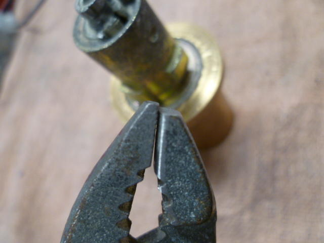

Here's another pic with a better view of the radius ground into the jaw:

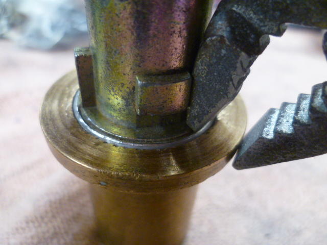

Using those pliers, I am able to catch the lip of the face cap and straighten up the bent bead around the edge. Like this:
And after a couple minutes of careful prying and working my way around the lock a couple times, I end up with the lip pried up straight enough that the face cap can be popped off the front of the lock. Takes some finesse and "the knack", but in the end, it looks like this:
