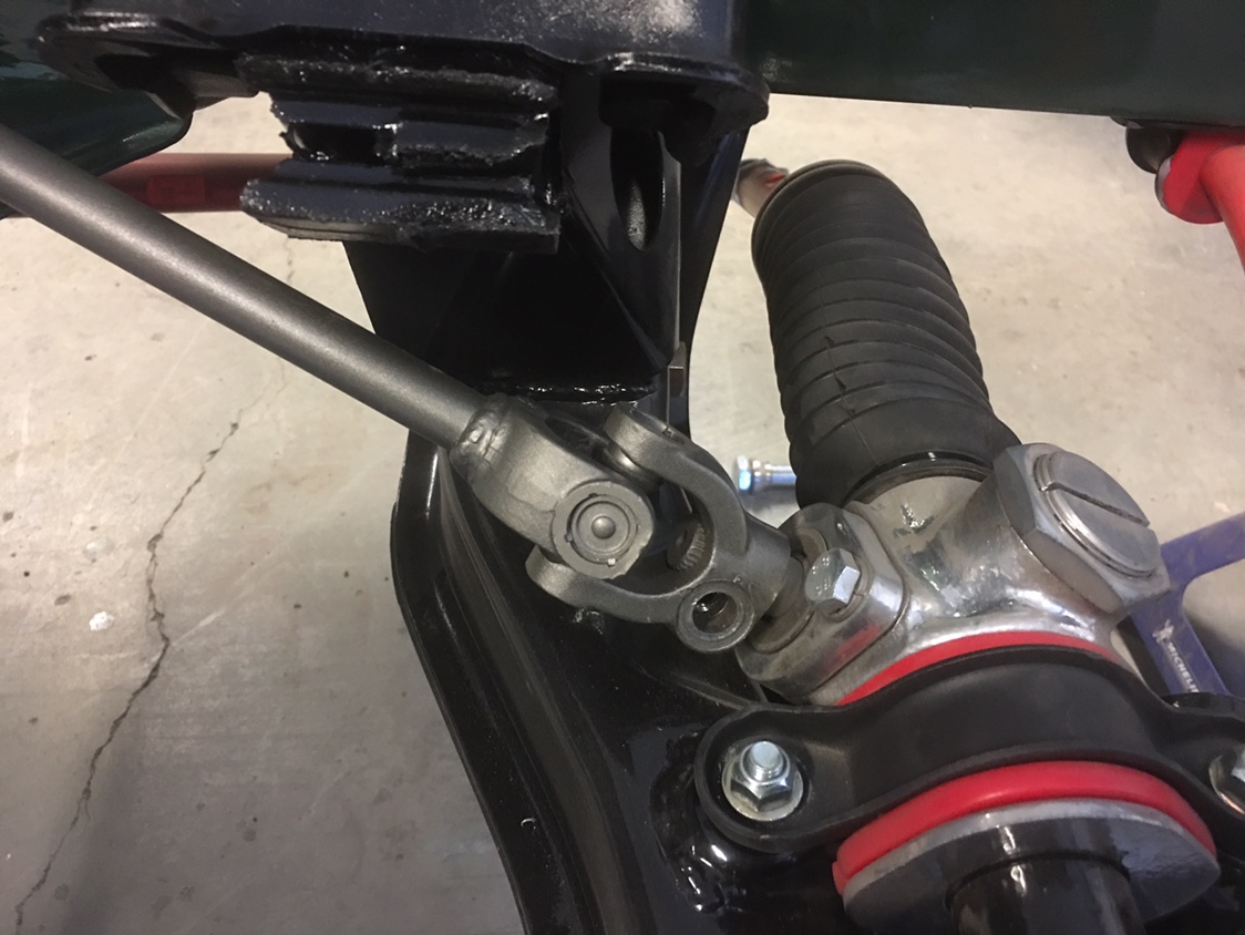

I might just put a bungee cord on the steering shaft and pull it towards the block a bit... that should work!
The shaft needs to move about 1/2” to work. I can try a twist downwards though.. good idea.
I haven’t been back out to the shop yet, but Granny’s idea kept me awake all night. That should work actually. I reinstalled the rack without a reference mark after doing all the powder coating. It’s quite possible I have it rotated too high even for factory steering shaft angles. I hope that’s it!
In theory, the rack should not be able to rotate at all. The bushings should establish the correct position and lock the rack into place.

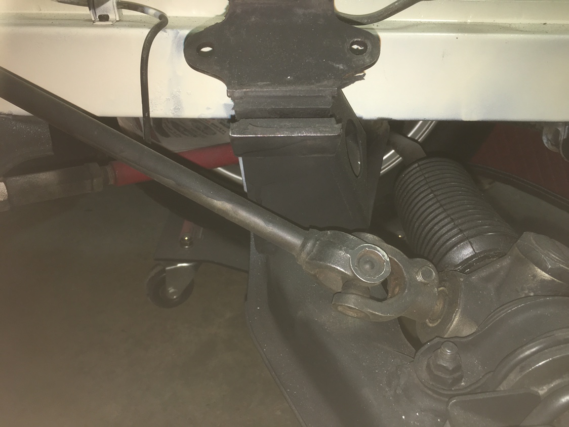

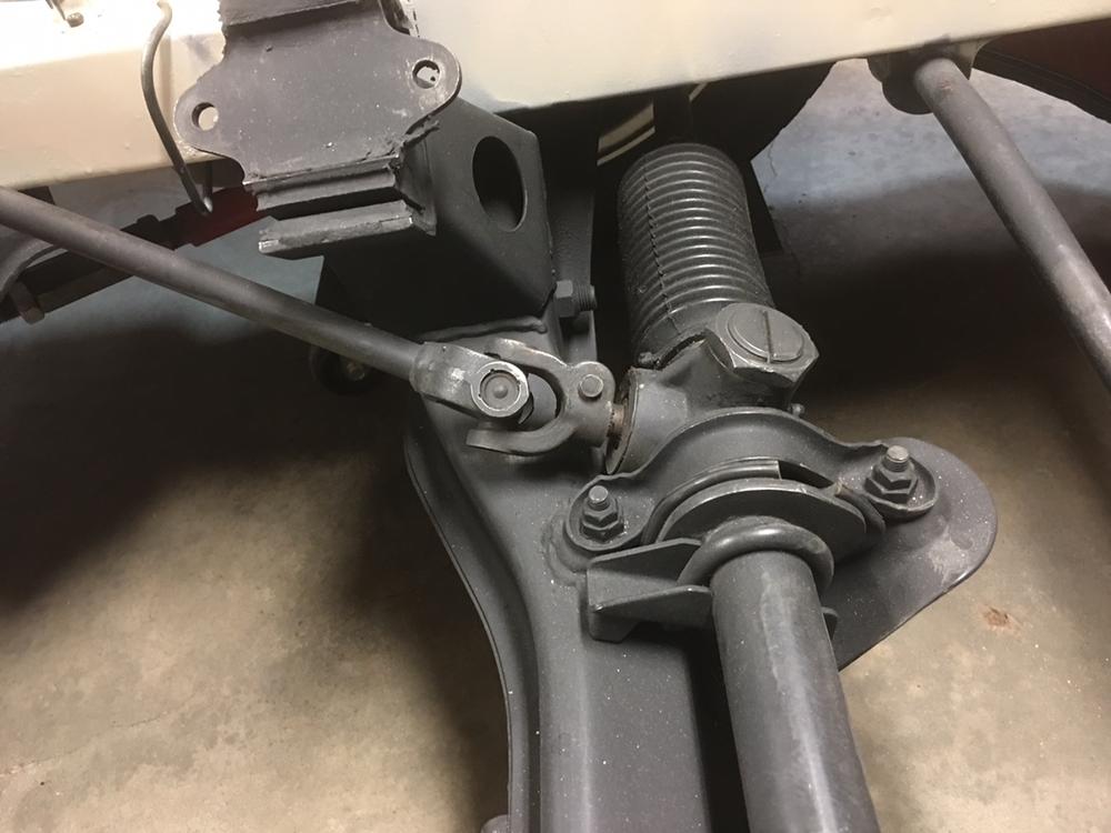

That said, I'm guessing there's some squirm that you could probably take advantage of and it sure does look like the angle at that bottom U-joint is off some. It's definitely different than the 240 pics you posted above.
Any chance you got the non-round side bushing in upside down or wrong somehow? Is that even possible? Here's your 280 for reference.:
The steering rack has plenty of rotation when it is all loosened from the bushings and the stop bracket. Mine is definitely rotated too far up as you can see by the different alignment angles at the knuckle on the 240 and mine.
Well I'm glad that it turned out to be such a non-problem, but is it really OK for there to be that much play in the rack position inside the bushing? I thought the whole point that the bushing on the right left side of the rack is NOT round is to prevent exactly that kind of rotation? What's to prevent it from rotating back to where it was before?
I guess I just never loosened mine up and collected all the tolerance in one direction...
Edited by Captain Obvious
Don't know my right from left...
