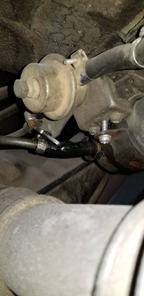

The source of my fuel pump leak...that was obvious. The other houses around the pump and damper look good, but the are some that I haven't replaced and will do the rest of them soon enough.

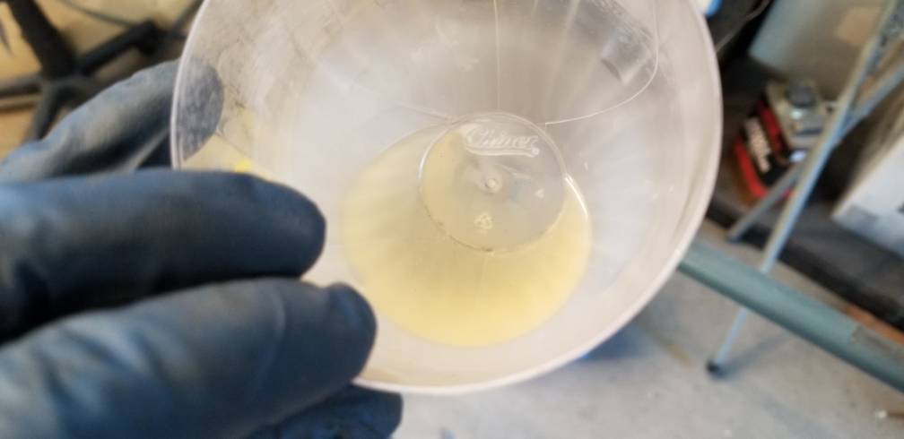

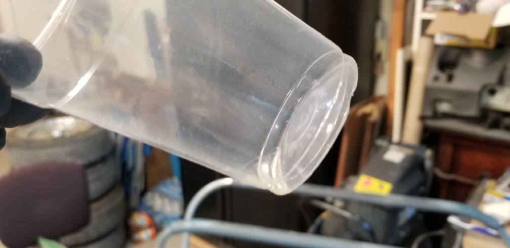

Anyway, when I fixed the pump, the same one-fire situation happened again. It really seems fuel related, so I pulled off the fuel rail to check the injectors. I've wanted to do this eventually, so this just forced the issue a bit.
Anyway, a couple of cranks later, I got this much fuel in each of the cups for the cylinders.

The facts are getting kind of random and don't fit well.  Your video showed that it l almost started, more than just a pop, it sounded like a short series of ignitions, on just gasoline.  But you said you didn't even get a pop before with a much more potent fuel, so the focus was on spark.  Now you're measuring output at the injectors but they really don't squirt much at low RPM.  Not clear if what's in the cup is a lot or a little.
You're kind of at the point where it might pay to just write down what you know and put a methodical plan of action together.
Many people get to this point via different ways.  A bunch of disconnected observations that don't really show a solution.  No offense, it happens to many.
If that's a lot of fuel for the amount of time cranking, and your temperature sensor reading at the ECU is in range, then bad ECU comes to mind.  Disconnecting all of the injectors might get it to run for a few seconds.  It might be flooding due to the ECU keeping the injectors open.
Just one thought, for the action plan.

There's some overlapping timelines in the posts. I tried starting fluid early on and it never fired with that. The almost-starts happened later on. With the amount of fuel in there, it's no surprise starting fluid didn't help.
And the cups from the cylinder injectors had maybe 1/4tsp of fuel. The CSV spit out a tablespoon or two. Now to figure out why...
I might do both, plus one.  Disconnect the injectors and it will probably start and run for a few seconds on CSV fuel.  Disconnect the CSV and see what happens with the injectors connected.  Disconnect them both and start it on starting fluid.
