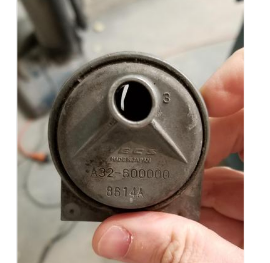

I still think the obvious explanation is that you are flooding your engine by trying to start an engine that was working properly when there was a significant bypass around the throttle plate (the AAR). You removed that bypass and didn't add extra air from somewhere else, but you kept the fuel the same.
This does make the most sense.  I feel bad for getting distracted with the other stuff.
The assumption was that you removed a functioning AAR but if your AAR was stuck in that position, never fully closing like it's supposed to then the idle adjustment bypass would have been adjusted down to almost closed to make up for the AAR opening.  When it was removed you're left with no air with the throttle closed..
If you want to take CO's suggestion one step further just open up your idle speed screw, the screw with the big head and a spring under it.  Turn it counterclockwise a few turns.  Then you'll still be on the idle circuit of the TVS, but with more air.  You'll need to do that anyway, probably.  Hope that's it.  Now you are an EFI expert.

I put the rail back on, opened up the idle screw one full turn and it fired right up.
Tried to turn it back a bit and it died. Looks like it had been turned in too far to compensate for the stuck AAR.
