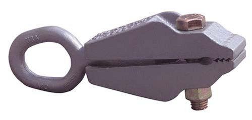

How did you attach to the backer plate? Did you bolt a strap to it? Some good frame clamps help a lot in this situation
Yes exactly.  I couldn’t get a decent grip so I just looped a strap from a scrap piece of sheet metal and bolted it on
I buy them off Ebay or Amazon. More challenging for those of you North of the border. I try to get one like this, then I have one that has more room behind the jaws to get around flanges and such and I have one that will join up 10 or so weld on studs to pull. I also have a wide one that has double jaws
https://www.ebay.com/sch/i.html?_from=R40&_trksid=p2380057.m570.l1313.TR6.TRC1.A0.H0.Xmo+clamp.TRS0&_nkw=mo+clamp&_sacat=0
Lots of styles and types. Some have dual points so you can load it in two directions at once. If your jig was fastened to the floor you could add pull points in the floor and some cribbing and basically have a 240z frame rack
