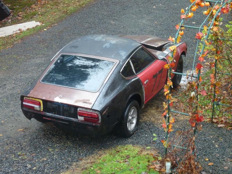

Sadly 147 has been stored like a bottle of wine ~150km away.  I have not had a good look-see ever.  When I opened the hood and saw those joint-like sections and the racing aspects, I figured it had  the front 1/8th replaced.  I'll have to scrape the paint and look for blue under that beautiful copper ?
Edited by 240260280
