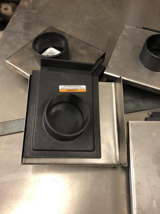

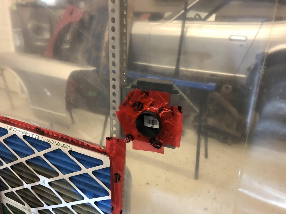

 More prep booth mods:  Blast gates !!! ?
Bent some quick sheet metal flanges to keep them compatible with the Adult Meccano and bolted them up...

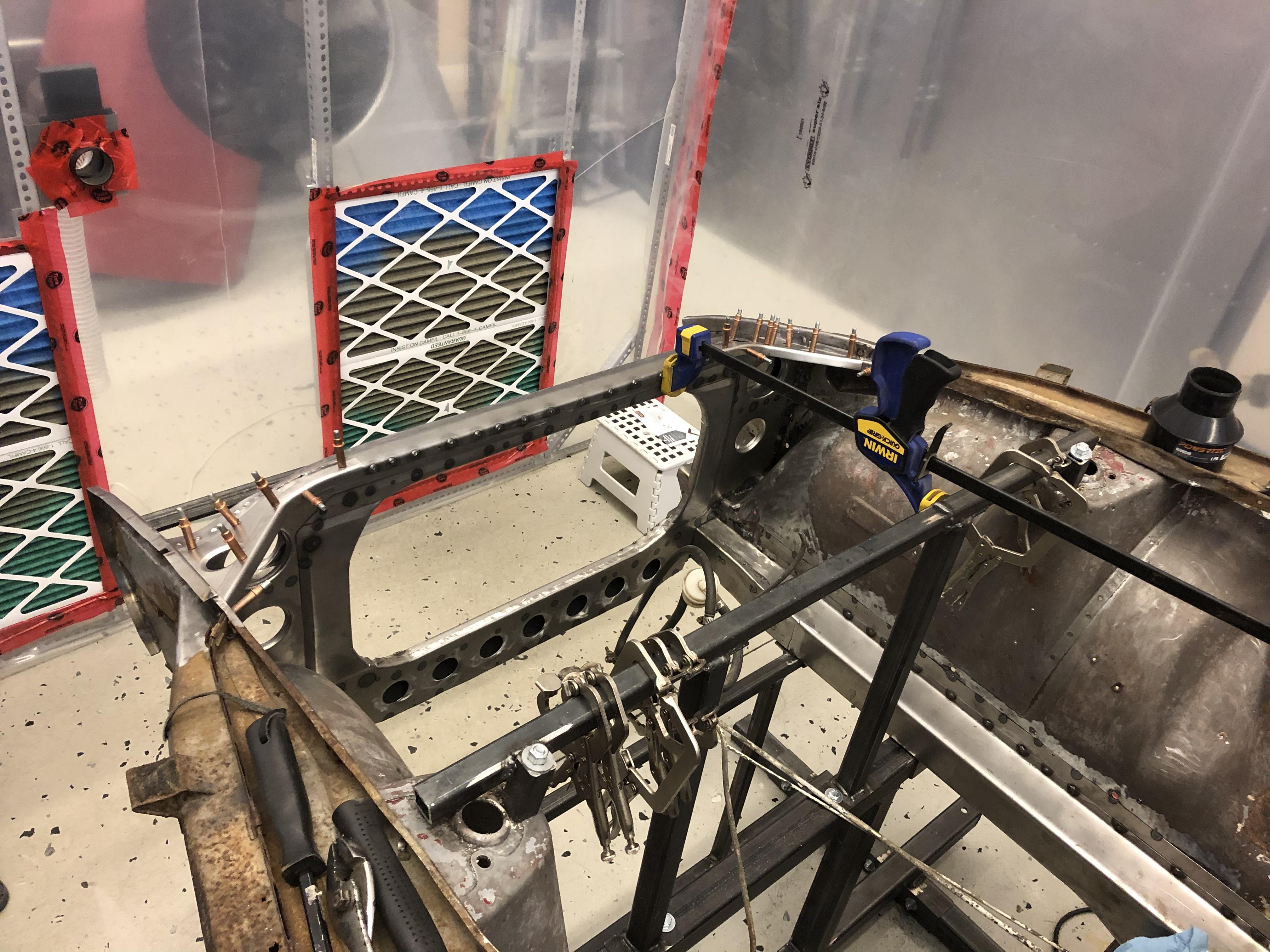

Sealed up with more Tuck Tape on the inside to prevent air leaks ....
Good to go ...

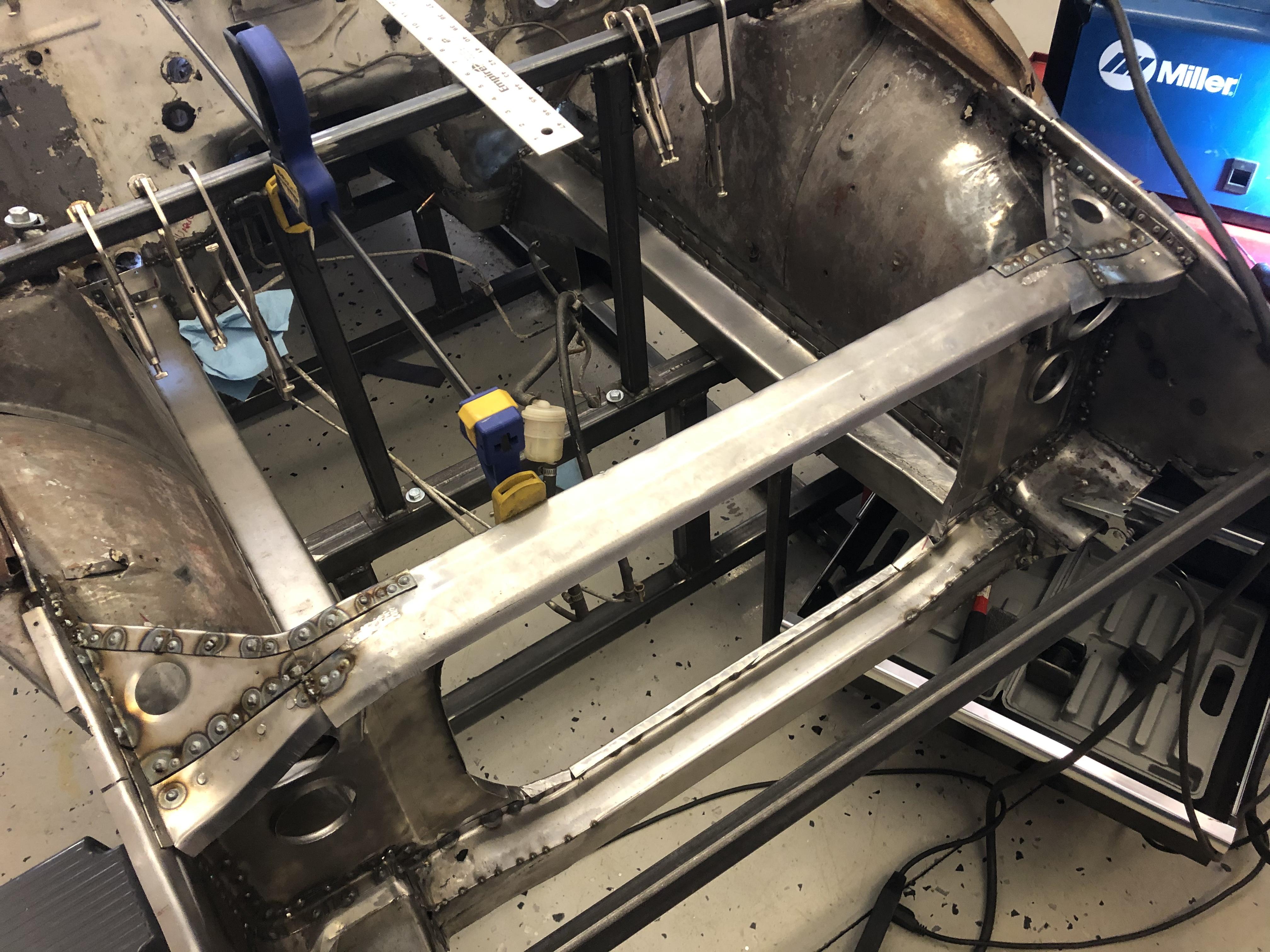

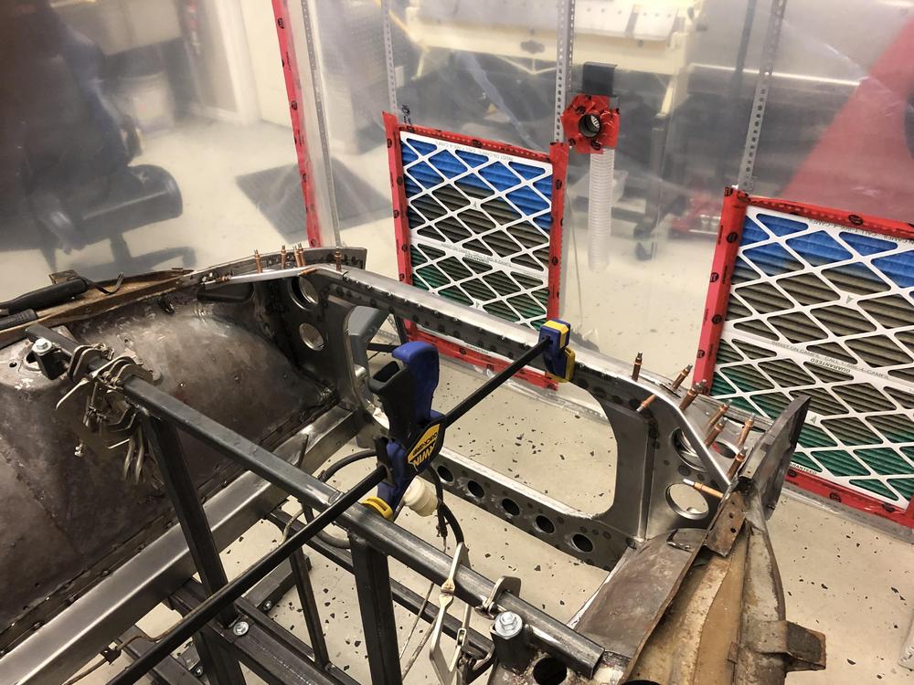

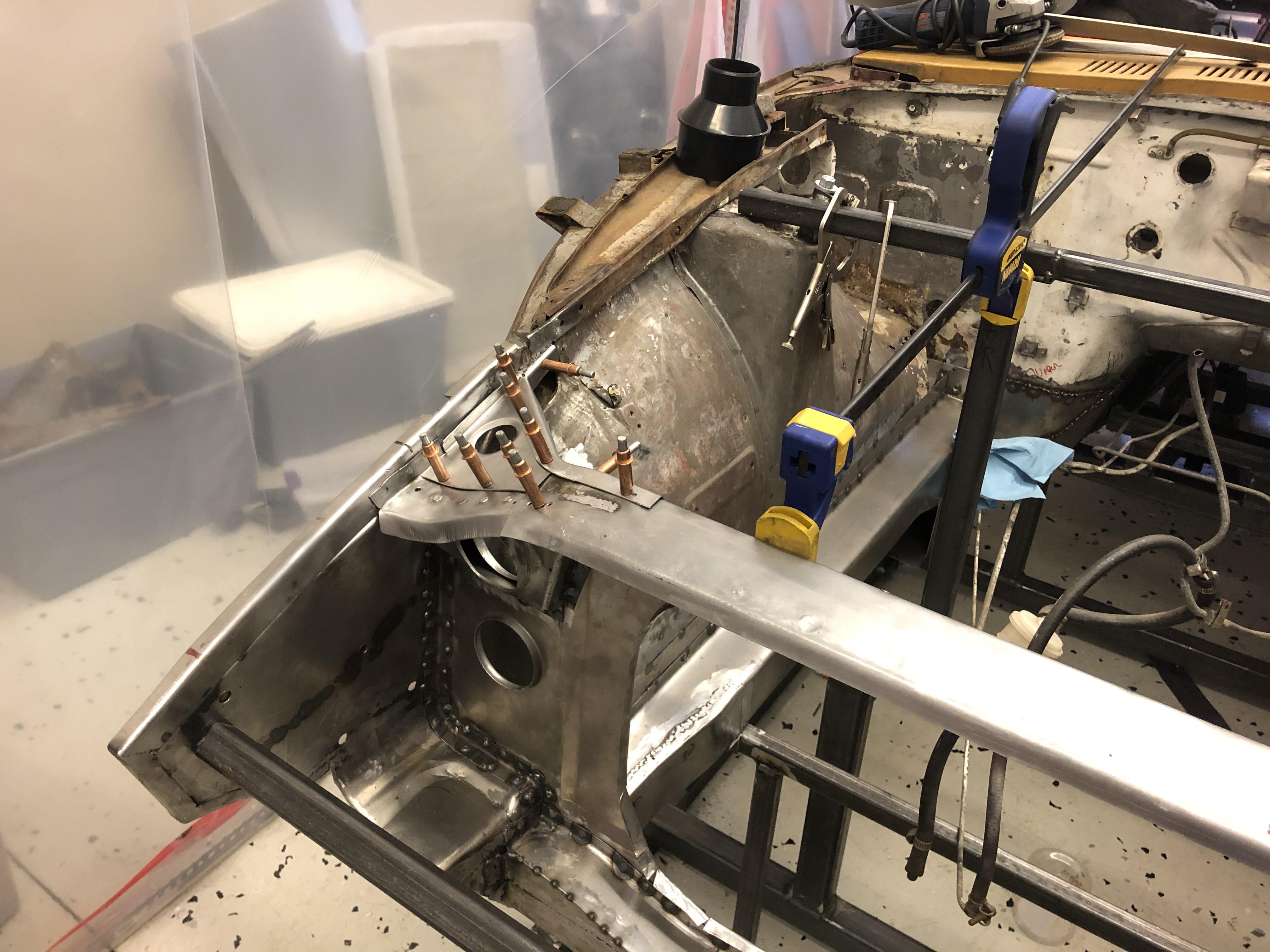

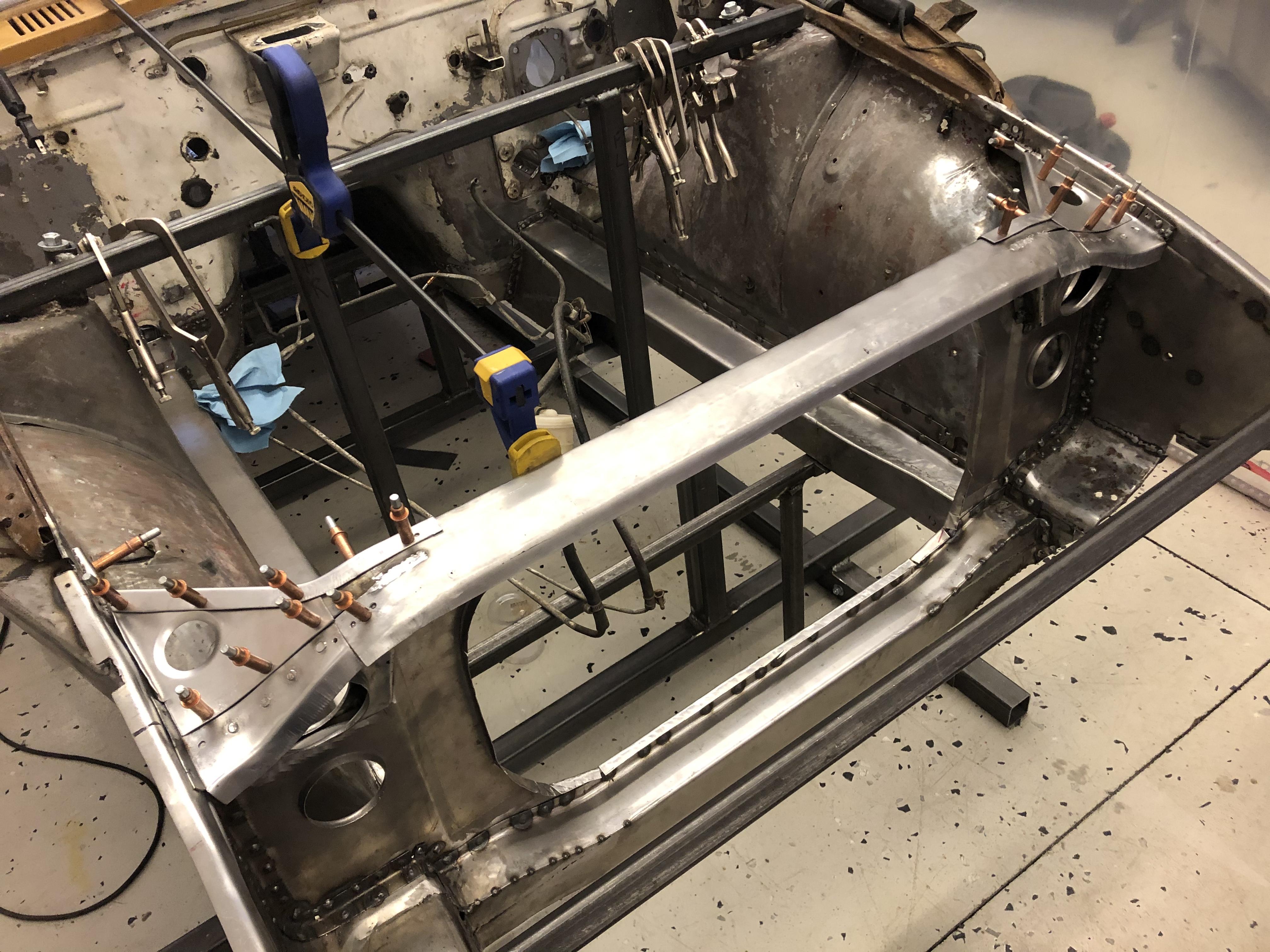

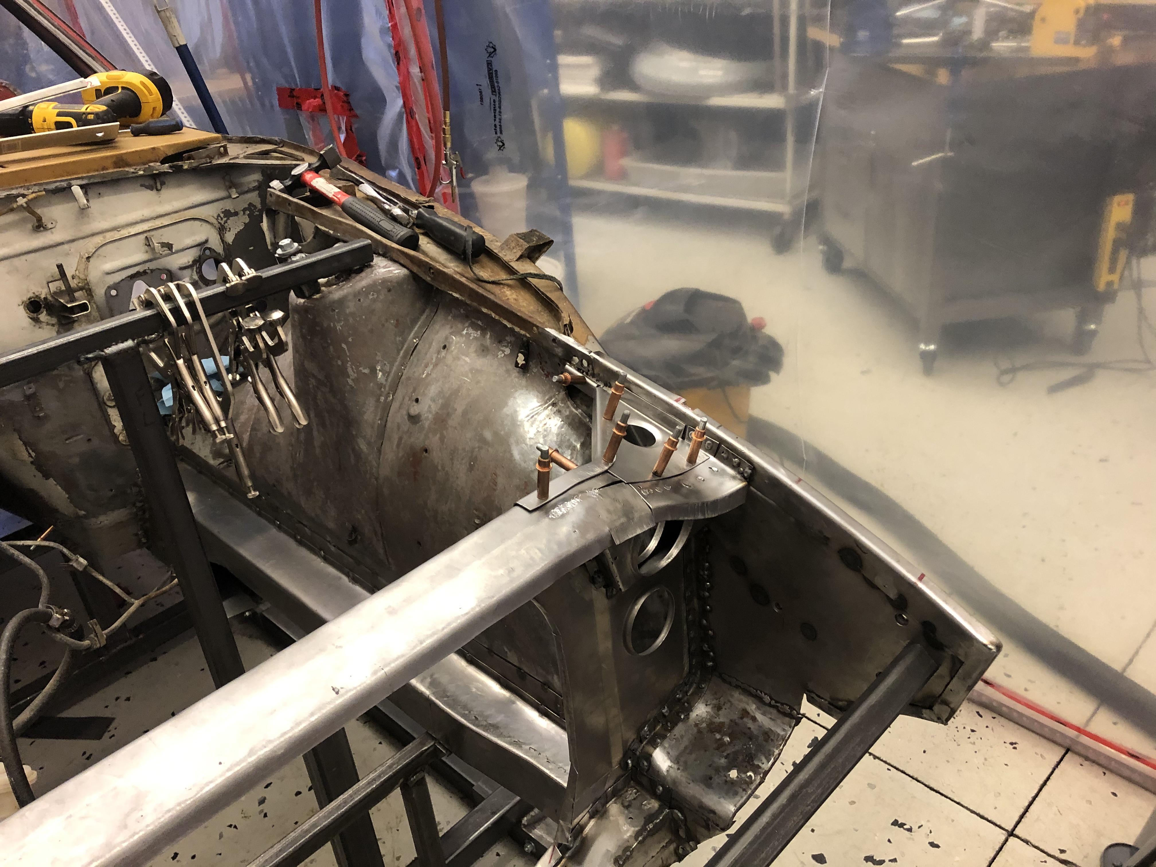

And moved on to putting the final touches on the radiator support....
I welded the new rad support in some time ago but I wasn't happy with the upper brace ends so I cut them out and started over ....
Went with dimples instead of beads, (for no particular reason?)
Still need to some fitting, trimming and hammer/dolly work, but I am happier with the direction this is going ....

27 minutes ago, wheee! said:
Welcome to Cleco-ville! Love it!
Yup - love me some Clecos!
One thing that doesn't get discussed often:  how many times does a part get attached/detached/re-attached before it gets welded in place?  I might be slow, but I probably average 6 - 10 cycles, maybe more ....
Edited by ConVerTT
That is the part that can really get on my nerves. you just have to accept that's what it takes to get it right.
