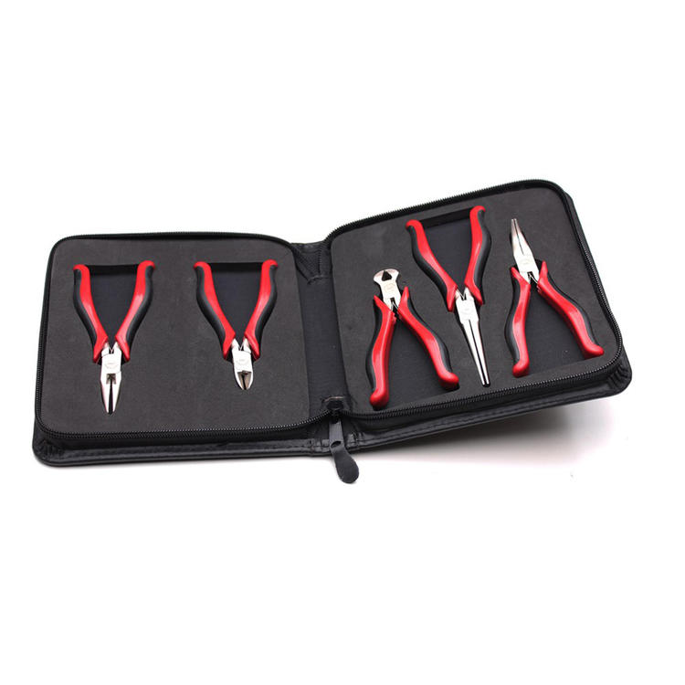

Cliff, I don't understand why you want to remove good glass from the mirror housing but to keep the costs down you could try the same lock face cap pliers that Zup linked to in my lock thread,  https://www.dhgate.com/product/new-model-car-door-lock-face-cap-plier-removal/396796240.html
It is the same application really as the door lock caps except re installing and rolling the lip back into place might not be possible.

Zup sent me a good mirror with a dented housing behind it.  I need to transfer the glass mirror he sent to my car.  I thought I could get it out fairly easy with these but it did not work so good and now I nervous about breaking the mirror and the 7 years of bad luck that go along with that. :ph34r:
Putting it back in will (should) be easier with a good round piece of hardwood, a section of an old mop handle from the restaurant is what I was thinking.
