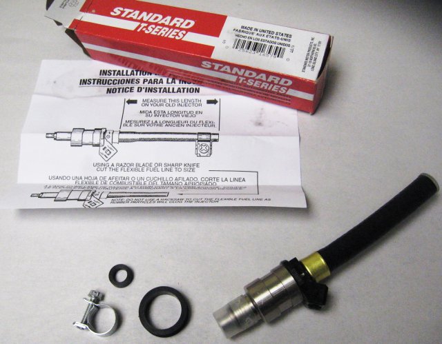

Sure. Did the rockauto ones came with O-Rings?
Also did u change the fuel pressure regulator? should i get that also from rock? there is a OE version on z car parts which is a bit expensive.
Mine came with both rubber seals and a hose clamp.
Here's the thread if you want to read a little.
On the FPR.  I put a fuel rail I built that needed a single inlet like the '78s have.  I'm pretty sure it came from rockauto for $70 something or another.
