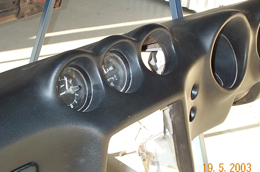

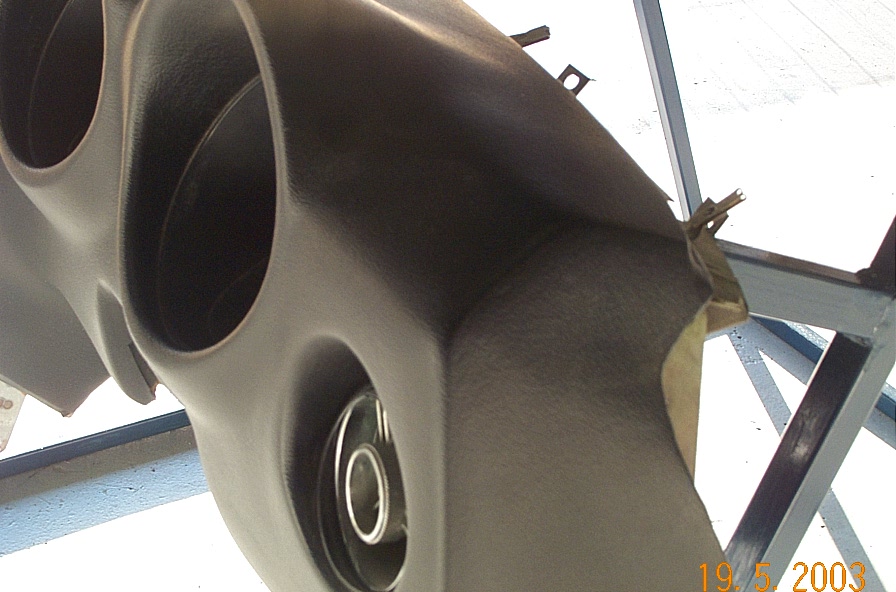

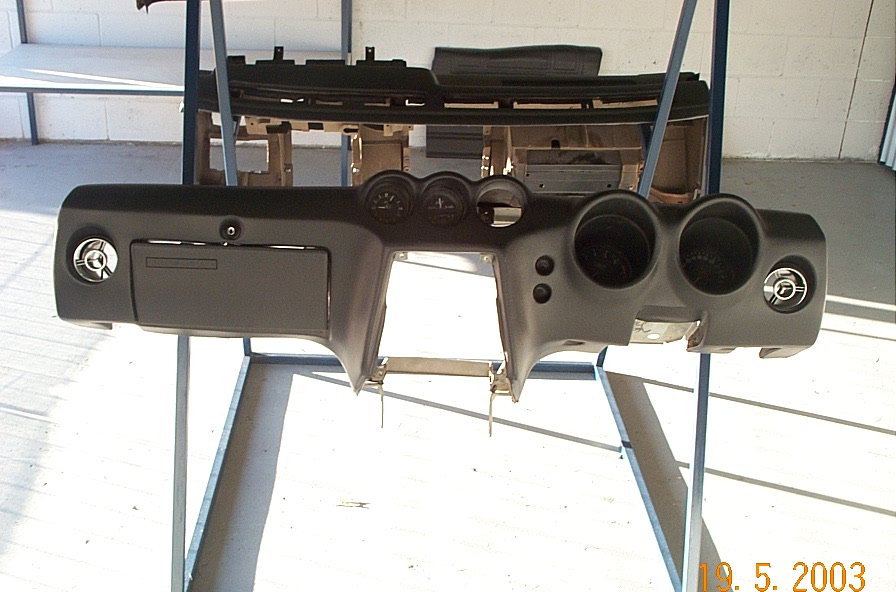

I have taken a couple of photos of the Zed dash they have in the shop which is out of a 260Z.
