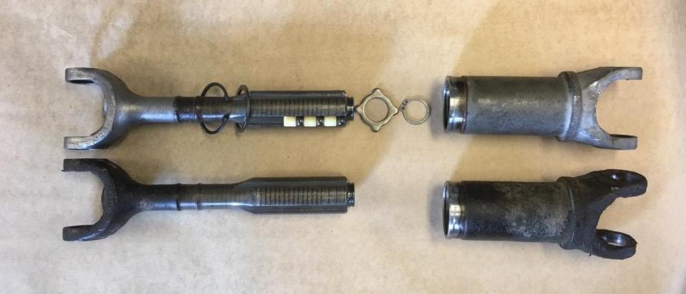

I placed the grease along the channel of each groove on the first smaller amount.
Then I placed the larger amount directly below the retaining washer and circlip at the end of the grooves. Not in the boot area.

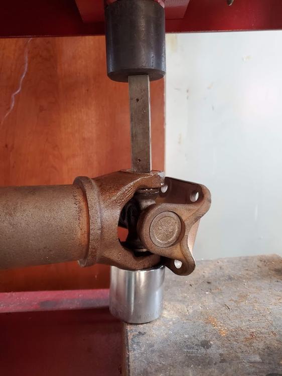

So much for plans to measure the bearing diameter.  I could not (cannot) break down the half shaft bc the u-joint won't cooperate.  Left it overnight with WD to soak and kept about 10(?) tons of force applied.  This morning - cups still will not move.  Can anyone confirm the flange is forged?  Really looking forward to NOT breaking it.
Yep, retaining clips are off both cups, and the socket is large enough.  I shall press on ?
