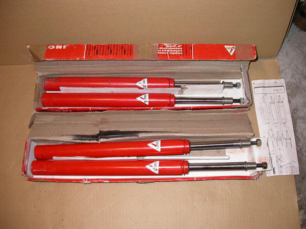

14 hours ago, Lumens said:
Looking at one of my old Koni's and I do mean old, it shows 8641-1031
and underneath that it reads 8703.
I am going to call to see if I can send in all 4 to be tested. The adjustments seem to have quit working.
Looks like Week 3 (January) of 1987 production.  Being the 8641 prefix, they are the externally rebound adjustable, twin tube low pressure gas version that were made  for a few years in the 1980s.  I believe that the 8641 versions were likely made primarily (and maybe solely) for the North American market and likely even built in a US factory in Virginia that operated from about 1982 through 1989 or so.
If the adjusters are not turning (probably from jamming  by hand or impact tool or internal bottoming most likely), then dyno testing them will be of no value and wasted money and time. Additionally, whomever tests them will need to have a dyno with fixtures to hold the Z-car's uncommon spindle attached strut housing. They could likely be rebuilt but it would actually be much cheaper, faster and have a full warranty if you were to simply purchase the brand new ones from Motorsport Auto.  You would be much farther ahead to start with fresh ones than pay the labor and parts to fix the old ones which would still not be entirely new.   It is definitely less expensive per unit to build new in a large production batch than rebuil;d them onesy-twosy paying for labor and parts.
19 hours ago, KONI Lee said:
What is interesting to me is that the 1980 date code on the newer design means that they must have started that conversion earlier than I'd thought.
I also noticed a difference in color.. (They have been cept in a box in the dark and conditioned.) one day i'll install these as they are on my 240z (i hope) and we'll see what happens !!
22 hours ago, dutchzcarguy said:
As said earlyer, these Koni's are new old stock.
I've heard that these were the shocks that where used in the south african rally cars?
I don't know where you heard it from, but it's not correct.
None of the factory works rally team 240Zs used KONI shock absorbers.
 A. Why would not the US Koni rebuild and test facility no have fixtures to test a simple common design Koni?
B. Why buy new? These are a lifetime replacement warranty.
I suspect there are a lot of warranthy exceptions for damage or normal wear. Most of these warranties are for material defects
A.  There is no longer a KONI North America Automotive damper service facility as it was integrated into our Railway shock service facility several years ago.  There are 3 outside businesses that are authorized KONI Automotive rebuild facilities in the US and their info is listed in the right side column of this link that can do testing and service for you: http://www.koni-na.com/en-US/NorthAmerica/Locator/  but you will have to pay them for their work. The Datsun Z strut with the attached spindle (used sometimes on ‘70s cars like RX7, 2002, etc. but rarely used since) is neither common nor simple so most companies with shock dynos do not have proper fixtures for strut housings, much less ones with spindles attached.  We have a special dyno fixture for inserts which must be compressed within an outer structural shell for testing but that is very uncommon outside a company like ours.
B. If you bought them brand new and have a purchase receipt in your name, have a current vehicle proof of registration still in your name, and there is an identifiable internal manufacturing or materials defect in the damper that is causing the problem, then it certainly is a candidate for warranty replacement for as long as you own them.  Because those dampers were discontinued 25+ years ago, that causes some complications but they can be addressed.  The warranty does not transfer to a non-original KONI purchaser, if sold on the car to a new owner, does not cover non-defect damage caused by external means (bottoming damage inside from hitting something, incorrect installation or usage damage, etc.).  In my 20+ years of experience, stuck adjusters are almost always of external cause and not internal defect cause.  It could theoretically be stuck from a defect cause but that is extremely rare and also extremely unlikely to happen to all four of the dampers in a single car set.
Your comment about having them tested and possibly serviced made no reference to defects or warranty so I commented based on that.  If someone is going to pay for service to be performed, the labor and parts cost will almost always cost more than a brand new one if an off-the-shelf modern replacement is available and you do not need a customized unit for racing, special needs, etc.  If the above warranty info fits your situation, then KONI North America will be happy to address it that way.  Most people 30 years later likely don’t fit that so a modern updated version is often the cheaper, faster, and better route for the future.
