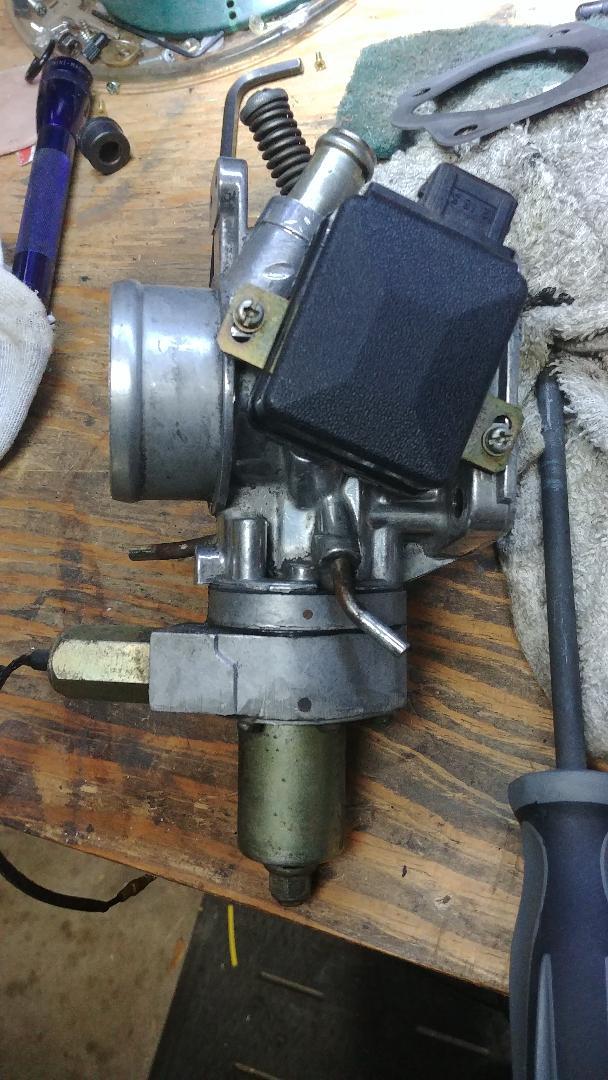

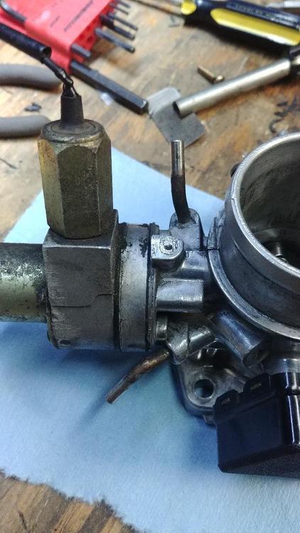

Looking for a throttle body and bcdd complete. A working bcdd. Long story short. I developed a vacuum leak at the bcdd that caused a 2500 rpm idle. After many attempts to repair, what I thought was wrong, I ended up installing a block off plate. Can't leave it that way, won't pass emissions. It has to be either a 77 or 78. These have 2 vacuum ports on the throttle body where 75-76 has one vacuum port. One port is for advance timing and the other is for the egr system. Hopefully someone has one. Here's a couple pics

Hmmm. Other things to consider...
In the later (latest?) years, 78 I think, they stopped putting the altitude correction nubbin at the bottom of the BCDD. Probably except for CA. So I don't know how detailed your visual inspection is, but you might need one from 77 or one from a CA 78 car. The final version still has an adjustment screw underneath, but doesn't have the bellows inside for altitude correction. Seems like the kind of thing that every state except CA would not have let them get rid of.
There's one of those stubbier BCDD throttle bodies sans altitude correction for sale right now in this thread:
https://www.classiczcars.com/forums/topic/61556-280z-oem-parts-fuel-ignition-door-stuff-grill-etc/
Other thoughts? Again, not knowing how rigorous your CA inspection is, but the energetic Z owner could be able to disable the BCDD internally and prevent any leaks while still having it appear externally as though it's fully functioning.  Not that I would encourage such behavior, but if it's a trade off of selling the car out of state or driving it...     :ph34r:

The FSM says you should be fine with just replacing the BCDD.  No need to do the TB too.
Yes long ago you could just remove the bcdd but due to age the gasket is extremely brittle and almost disintegrates when separating the two. I have tried on 2 others that's why my request.

Will post results and may even, time permitted, open up the entire non working bcdd to see what I can find. And just for fun.
There is another thread on it but I want to open mine up to compare.
