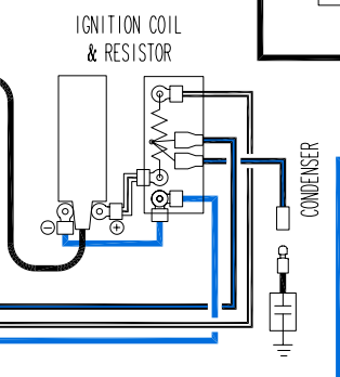

I think that is not correct condenser. Usually only one lead and the body if grounded.
so it comes off the main harness and the other end is not connected to anything? i was looking at the fsm and it should connect to the positive terminal of the ignition coil?
It is connected to +coil in your photo.  It is the other end that is not connected which is wrong. It should connect to ground.  Your car seems to have a dual lead condenser.
FYI Usually the Nissan condensers have just one single lead and the body is ground (see lower photo for typical 280z condenser).
Edited by 240260280
my 280z didnt come with a ballast resistor.. and its running the flamethrower 2 ignition coil..

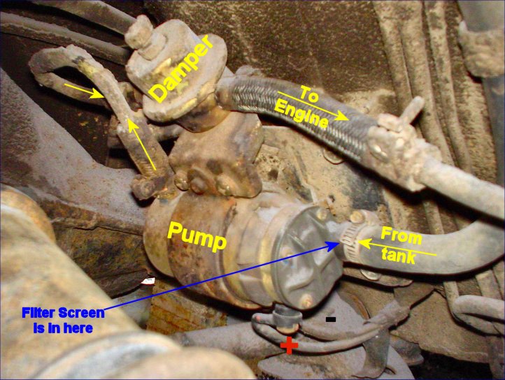

hello Av8ferg,
thank you for taking the time guving me advice.. i have drained the fuel twice now off the tank and it was clean .. i did replace the fuel filter .. and i opened up the old filter and it was also clean..
is that a factory filter? between the tank and the pump?
i noticed a small filter above the fuel pump.. it might be on the return line.. is that also a filter?
i know the dampner is different..
but theres 3 items underneath around the tank.. 1. fuel pump, 2. a black filter looking might be on the return line and 3. the dampner...
thanks!

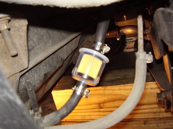

I’ve attached some pics to help you out. Having a filter on the return line make zero sense. The pervious owner may not have understood which line was which.
A pre-filter is not a factory thing. People starting do it as these cars aged and tanks got old. It makes sense to have a filter before the pump to protect it from clogging as it’s an expensive pump. This cheap fram plastic filter won’t hurt fuel flow as they have a very low resistance to flow. The great part is you can now visually inspect what coming out of your tank and change this in 5 mins for $3.
thank you for this image i will add a filter when i get around it this weekend.. its strange because it seems like its a factory location because of the mounting points .. its just the filter itself doesnt look oem..
