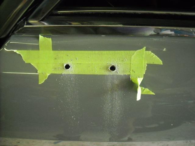

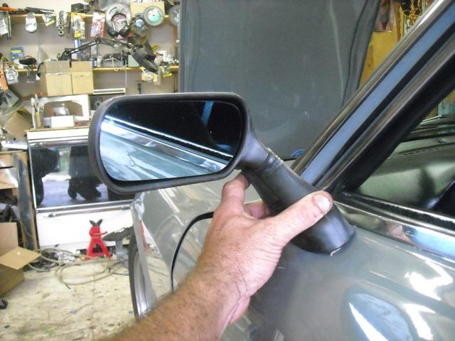

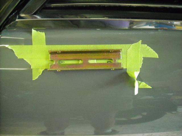

You know I don't think I did, these pics are about 5-6 yrs old now so the memory is not so clear but all the hardware is still in place, I think I might have removed the SS trim/window squeegee piece and the inner door card, rolled the window down all the way and got my fingers up there to thread the nuts on. At any rate it is worth a try before pulling the window glass.
I just installed mirrors on mine in January. With a combination of extensions and U-joints, contorted fingers, choice curse words, and eventually some band-aids, I installed them without removing the window frame or glass.
It can be done, but I don't know if I'd recommend it.
