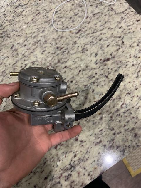

I have found a NOS Nikki fuel pump in my parts hoard. Still has zinc coating on everything, looks brand new. My question is there any advantage to have this pump over the standard fuel pump? I ask because I am one of the typical people with a built 280 motor and my su carbs seem to starve the engine and lean out on the top end. I have been wanting to add an electric pump but haven’t gotten around to it. And I know there can be many reasons why I’m leaning out, that’s not the discussion please.

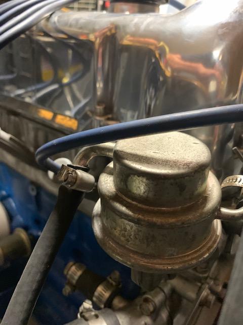

After doing more research it seams these Nikki pumps were original from the factory along with many other pumps. So now I feel stupid asking if it is better than the “regular”. What’s on my 240 is very different looking. I’ll try to get a picture.

The beer can looking fuel pump is aftermarket and not serviceable. The Nikki is serviceable if you can find the parts. If you need more fuel, electric is the right option. Run a fuel block off and add a relay to prevent the pump from running in an accident
