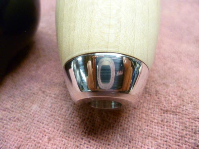

Nice. And cheap too! I've made a number of shift knobs to date, and I wouldn't sell them at that price.
Of course, mine are better.   LOL
Those ebay knobs look OK from a distance, but the shift map is the stumbling block. Well worth the money though if you don't need something closer to original!

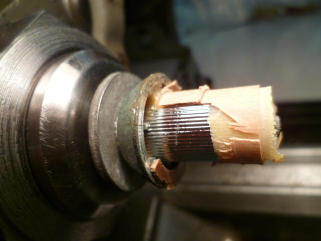

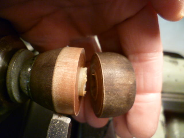

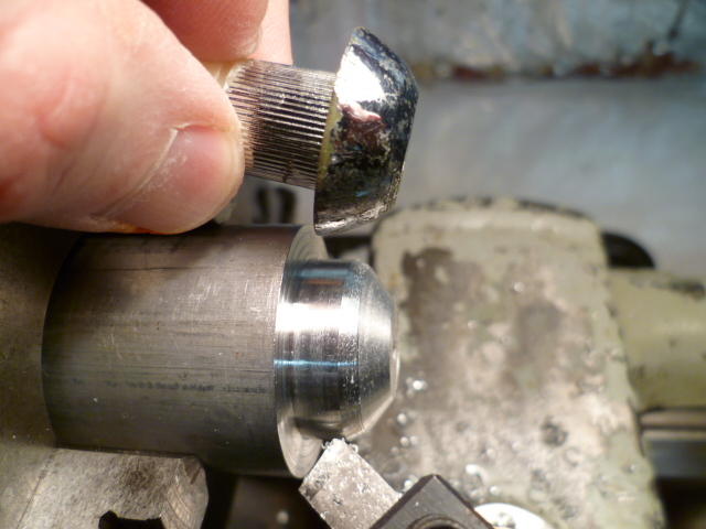

I've not had good luck getting the plastic chromed mount out. I had one original knob where the glue joint failed and that one was easy, but if you can't simply knock it out easy, then I don't have any suggestions.
I've not been able to salvage both the plastic and the wood on the knobs and one or the other had to be sacrificed to save the other. Here's one where I saved the plastic:
Sorry... That's all I got.
great pics and info. That's not very reassuring to save parts. I'm going to try to press out the plastic. I also am planning on using it as a template to make a replacement out of aluminum or stainless.
