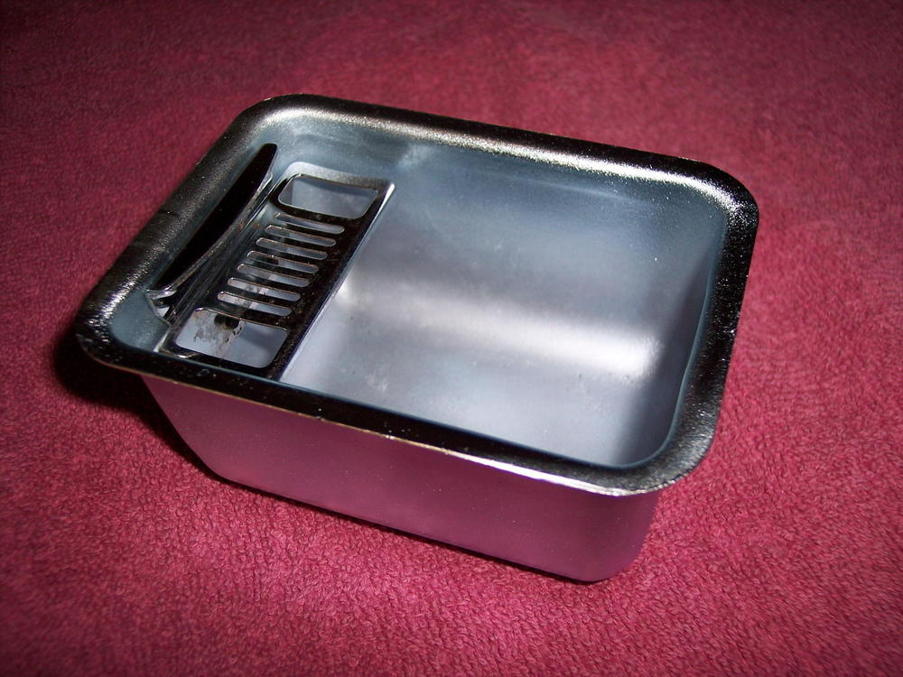

Speaking of ashtrays, this one just completed (soon to be listed for sale :love:):

1 hour ago, Patcon said:
Were the ashtrays clear zinc and not chrome?
The body of the ashtray is clear zinc, the fittings are chrome.
