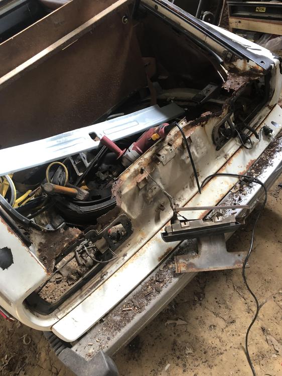

3 hours ago, startt21 said:
Would anyone near the Houston, Tx area happen to have a parts car that they wouldn't mind cutting removing the back panel from about the mid taillight up?
It makes a better repair to just drill out the spot welds and get the whole panel, my 2 cents
https://www.classiczcars.com/topic/61724-78-280z/#findComment-570104
5 hours ago, startt21 said:
I have that panel new cause that was my plan then the rust kept going and this is what I am left with.
I suspected as much. The license plate panel actually goes all the way to the bottom. It's one piece. There are about 50 spot welds but you have already done about half of them. It is a much more invisible repair if you just do the whole panel and get a donor from a wrecking yard
https://www.classiczcars.com/topic/61724-78-280z/#findComment-570128
