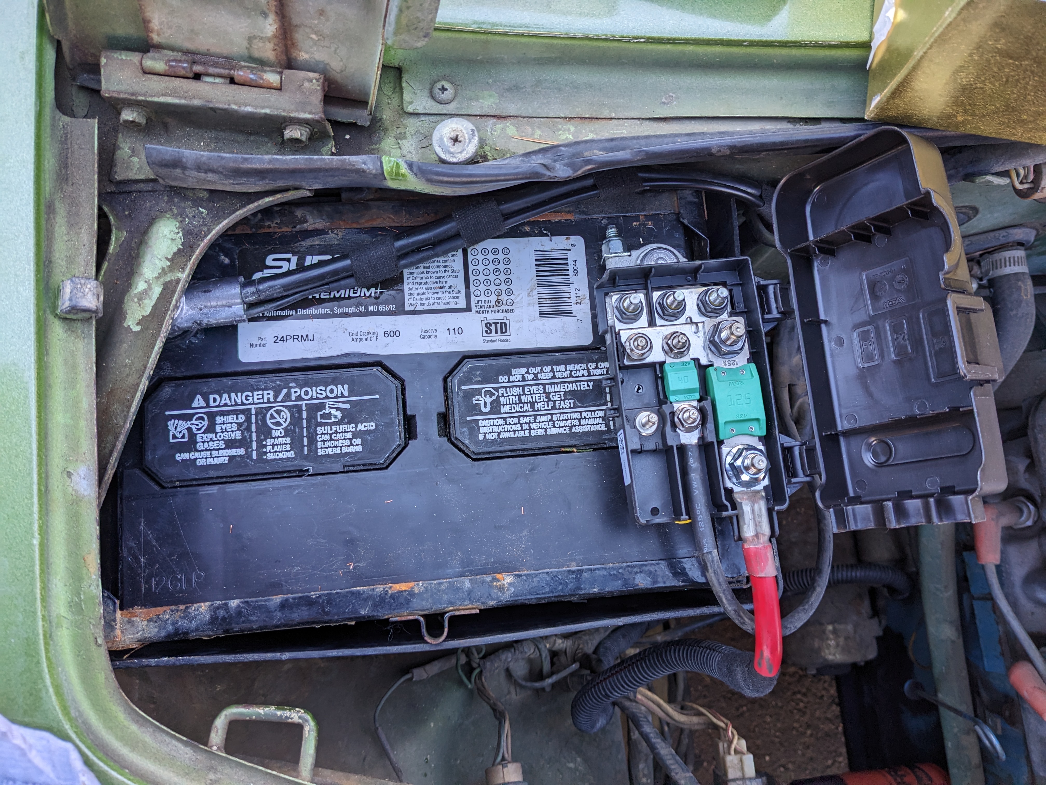

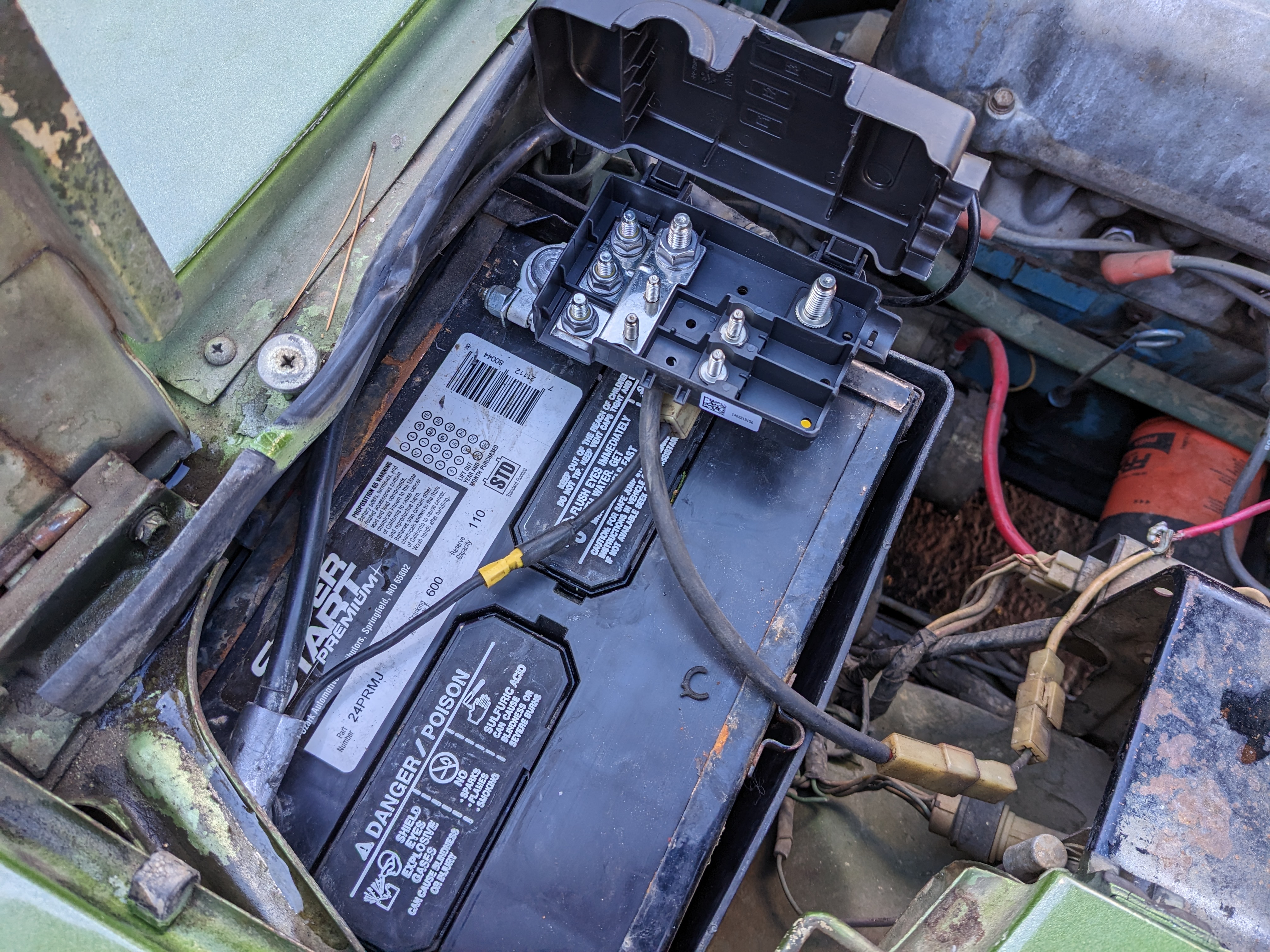

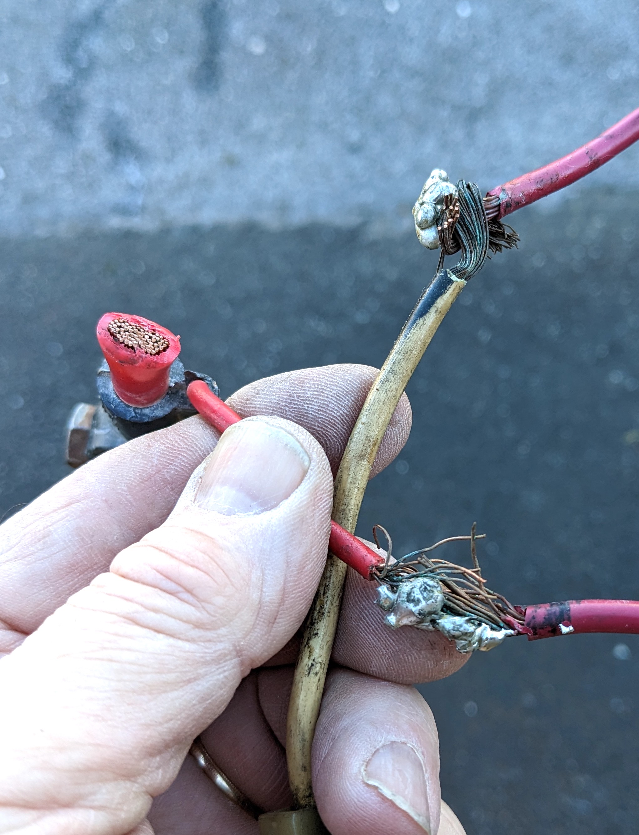

This is what someone did to 'repair' the fusible link for the EFI.
The ground side pulled right out of the butt splice seen below. I'm adding the fuse block
New cable ends crimped for EFI feed and starter cable
Clears hood inner frame
I can't put my finger on it, but something about your solution appeals to me more than the one done by the IPO (idiot previous owner).
  • Haha 3

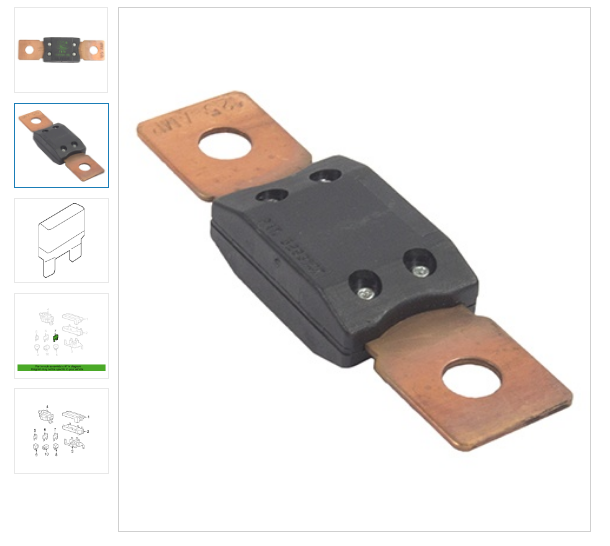

What brand is that fuse panel?  Looks pretty nice.   Many newer cars have similar panels mounted next to the battery like that.  Those fuses look much more robust than the typical Maxi-fuse.
Ford calls theirs a Mega Fuse.  Not sure how many sizes there are.
https://www.oemfordpart.com/oem-parts/ford-main-fuse-f87z14526ba
Edited by Zed Head
Its an MTA 0300839.
Connector ID is a US distributor. The cable terminals & fuses are sold separately, but listed with the main component so it's easy to figure out what you need based on the gauge wiring you are using.
EDIT -  uses Midi & Mega fuses
Edited by HusseinHolland
typo on company name

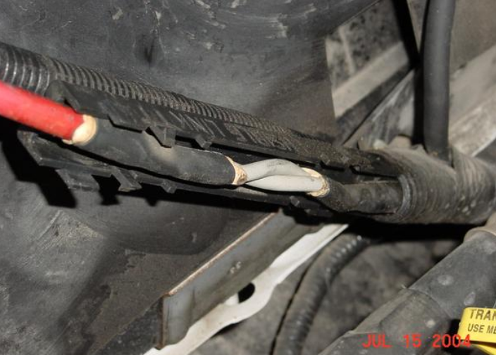

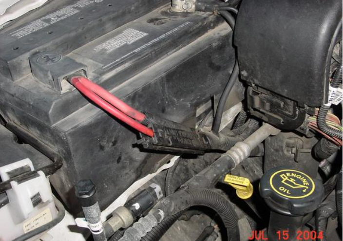

Thanks.  Ford also used the older style fusible links up by the battery for quite a while.  My 2003 has a set.
Here's a link to your panel and a picture of a Ford fusible link, just for fun.  Borrowed the picture from the internet.
https://nexelec.com/MTA-0300839/
