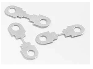

Also I have thought about playing around with this: https://www.amazon.com/gp/product/B00902G49U
It has four slots for fusible links and a plug that is connected to ATO fuses. It would be a matter of figuring out where to mount it to reach the battery.
This one looks closer to what I have (looking on Amazon), with more posts, however the circuit rating is fixed
I found the Littelfuse brand strip fuses that should fit the VW link box above on DigiKey and Mouser. Apparently the style is called HSB, and they are available in ampacities that are suitable for the Z. I'll definitely consider it for when I build the engine harness for my 240Z.
