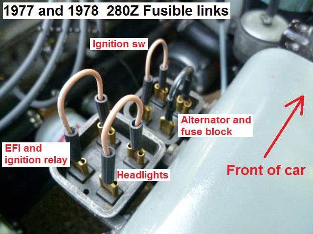

Yes, I do believe the mis-placement did carry over from 77 into the 78 year. I think the location of the biggest (black) link never changed. I think they got it right on the diagram in 76 (right front), and then screwed it up in 77 which carried into 78.
It would sure be nice if any other 77 or 78 owners could verify the position of the links just for additional data points. I know I've checked my 77 and positively determined the positions of the links. And I know that @240260280 did the same on his 77 some number of years ago. But I don't have any hard 78 data points.
So for any of you 78 (or additional 77) owners out there who would like to participate? The easiest way to verify the link positions...
Turn your headlights on.
Remove the link that is closest to the fender and closest to the firewall (right rear) fusible link and the headlights should go out.
  • Thanks 1
17 hours ago, Captain Obvious said:
What change? I'm not sure what change you're talking about. The 77 and 78 manuals both look the same as far as the links go.
If you've got a 77 or 78, the links should look like this:
77-78links.jpg&key=600e9d6accac5e957e40b
My 5/77 is this exact way.

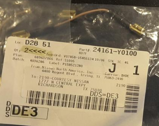

I replaced all my fusible links a little while ago (still need to post up a public service warning thread about that whole thing, but...) and I believe I saved my old ones. I'll take a look at my old red ones (that are truly red) and see if there's any writing on them. I keep then in the center console as emergency backups, but I may donate one to the cause and open it up. I should be able to measure the wire inside.
I can tell you anecdotally that the brand new 0.3 "sorta brown, sorta tan, sorta salmon" links I have installed run nice and cool. Implication being that they are large enough.

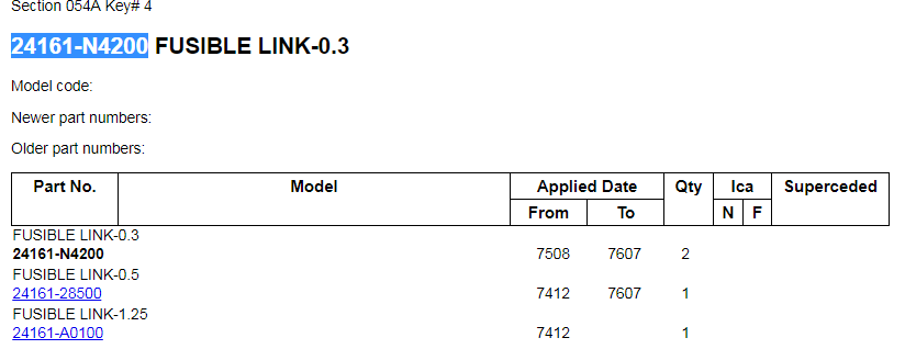

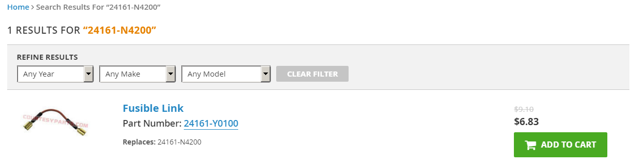

Actually they started in Brown.  Somehow red got in to the picture and sucked many people in, apparently.  EuroDat had all of the info to the right path in his first post, I see after looking at the supercesion trail.
So, what is MSA doing?  They have the wrong diagram, putting weak links in to high current spots, plus, maybe, they are doubling the area of two to three of the links even if they end up in the right spots.  Fat red, 0.69, for thin brown, 0.33.  Go through Nissan for fusible links.
