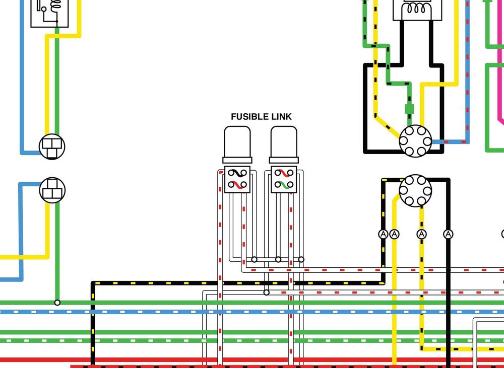

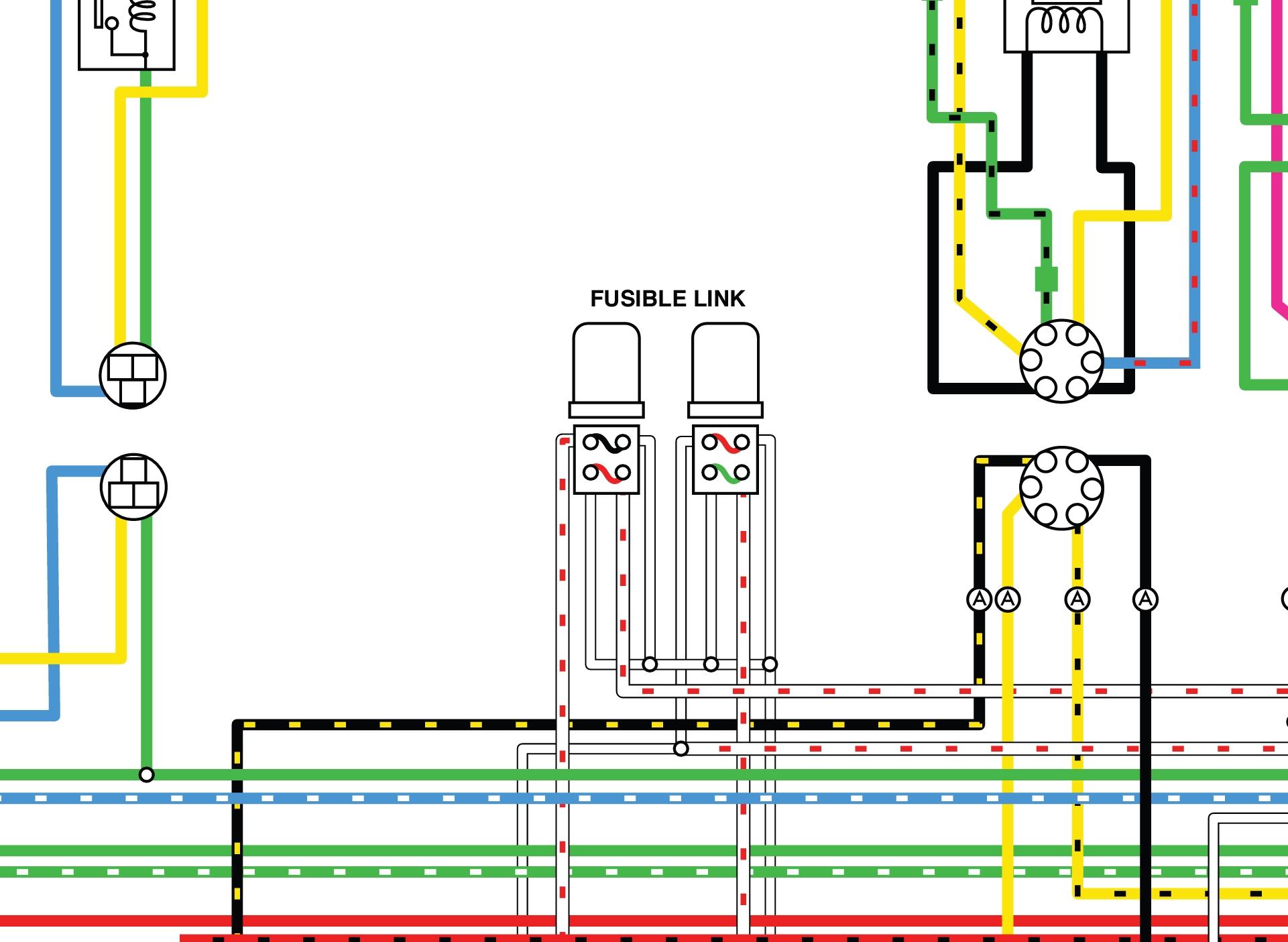

8 hours ago, Zed Head said:
 1976 doesn't even have the colors indicated.  They did change the wire colors though.  1978 is all W-WR through the links.  76 has only two white wires indicated.
Yer, I noticed that as well. It's three in your screenshot and the color diagram. Looks like the color changdd in the branch off in the loom. Thats (not) great for tracing wiring.

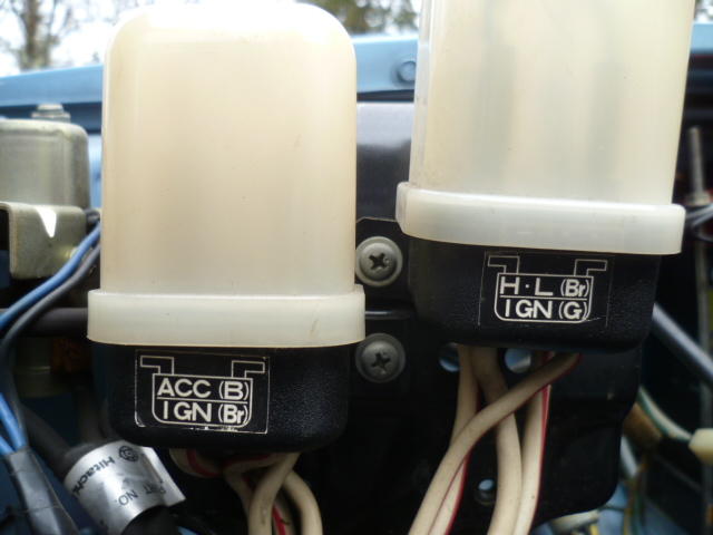

In this pic, from a very well kept unmolested 76, you can see that the front block has (at least) two W/R wires going to it, and the rear block has (at least) three:

So with that in mind... First thing that can be deduced? The 1976 color wiring diagram floating around out there is wrong.
Here's the previous snippet that shows four white and four W/R wires going to the link blocks (like the 77), but the photos of actual cars clearly show different:

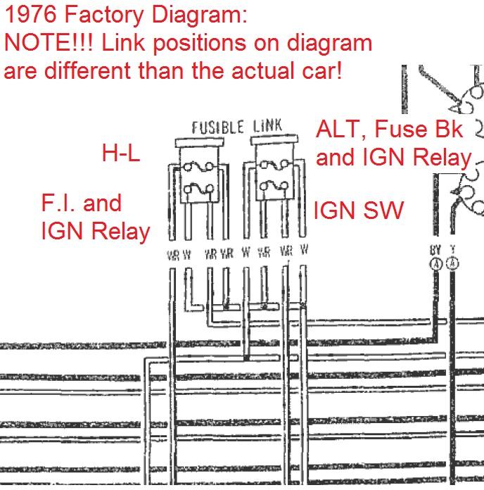

The next thing that can be deduced is that the factory wiring diagram suffers from the same link block positioning issue that exists for 1977. If you trace the circuits and then compare them to the links on the cars, you'll see that they have the link positions wrong in the 1976 FSM. They have the blocks reversed on the FSM wiring diagram:
The only thing that seems to have made life easier than the 77 owners is that the stickers on the links themselves seems to have been of better quality and lasted longer than the labels from 77 and 78. Maybe Datsun changed their label manufacturer and went to cheaper labels that didn't last as long.

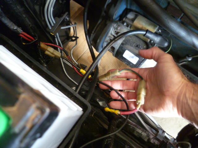

grannyknot, That thing you pictured below? I don't think that's the EFI fusible link. The fusible link for the EFI has connectors on both ends and one end plugs into what you show here while the other end plugs into a wire that leads to the EFI system.
2 hours ago, grannyknot said:
There is one fusible link that hasn't been discussed and that is the white fusible link on the positive battery post that protects #10 on the ECU and #39 on the Air Flow Meter. Are replacements available? IMG_1237.JPG
The only pic I currently have of the EFI link from my car is pretty crappy. I can tell you, however, that on my car it's green in color. So if one is to assume that all the fusible links came from Yazaki, then it would be the FLWX-0.5 green wire. Here's what I have. Note that it looks like there are actually two wires, but in fact, there is just one. The other white thing is a non-conducting plastic string between the two connectors. Presumably a strain relief so you don't yank on the fusible link itself:
It's the connector wire between the fusible link and the battery.  Shown in the diagram.  There's a black one too, but it connects directly to the harness.  Both harness connection wires are red (edit - screwed up statement about connectors here).  If the ends get damaged you can't tell which is which.
