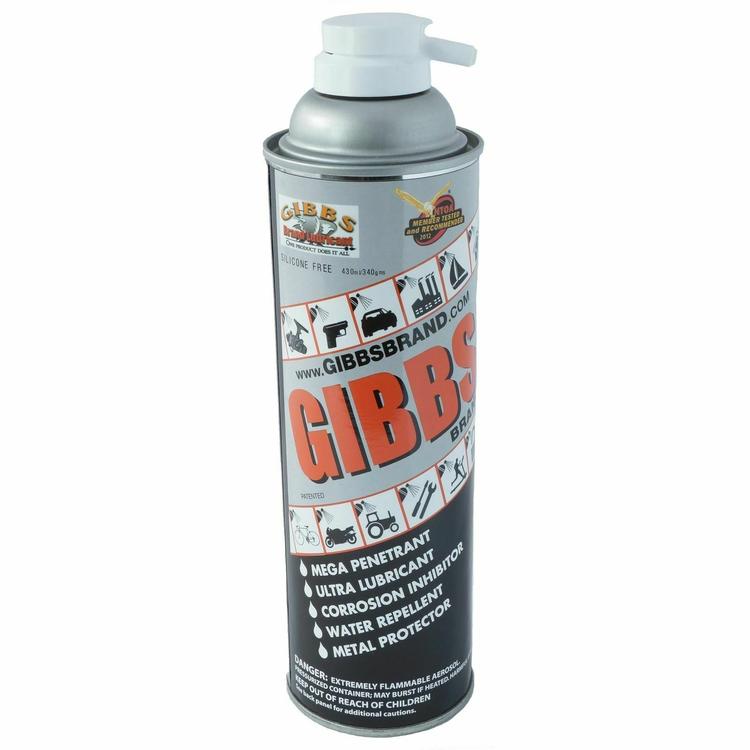

Carl, Gibbs has a number of lubricants, is this the one?

I have ordered the Gibbs oil and am going old school. I have all four wheels stripped and three bead blasted. Next will be the polishing of the outer rim then Gibbs oil. Thanks Carl. JLP
