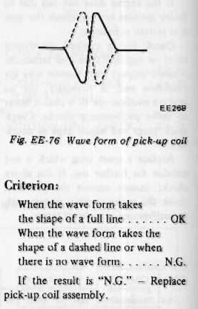

I'm really only aware because it's a common problem when people do the GM HEI swap.  Watching the timing light flash is how you tell if you got it right, if you don't have a good writeup.  If it's steady, it's right.  If it jumps around and gives an unstable idle, it's wrong.  N.G. as Nissan would say.
I also believe that the original ignition modules are looking for the negative to positive going transition.
And as Zed Head mentioned, if you get them hooked up backwards, you end up with a lot of spark scatter and unpredictability.  It's because you are spending a whole lot of time in the transition zone with a slow changing signal. Kinda like a very slow ramp on a CMOS input. They don't like it and can go indeterminate. You want the slope as vertical as possible and if you get it hooked up backwards, it can go metastable.
The only predictable area is physical transition when the reluctor stops approaching and starts retreating. At that point, the magnetic field change reverses, and the induced current will reverse as well. And... If that's not all... (we talked about the amplitude before being proportional to the speed of rotation) When designed correctly, the signal slope at the transition point is relatively unaffected by the rotational speed unlike the slope elsewhere which is very dependent on rotational speed.
If I haven't beaten this to death yet, here's a pic showing the waveform with the polarity switched. Note that the important positive going transitions are that flat indeterminate area with almost zero slope. Bad. What you really want is infinite slope on the positive going transitions. Here's the wrong polarity:
And here's what the waveform should look like. Note that the positive going transitions are the vertical slope areas. Correct polarity:
