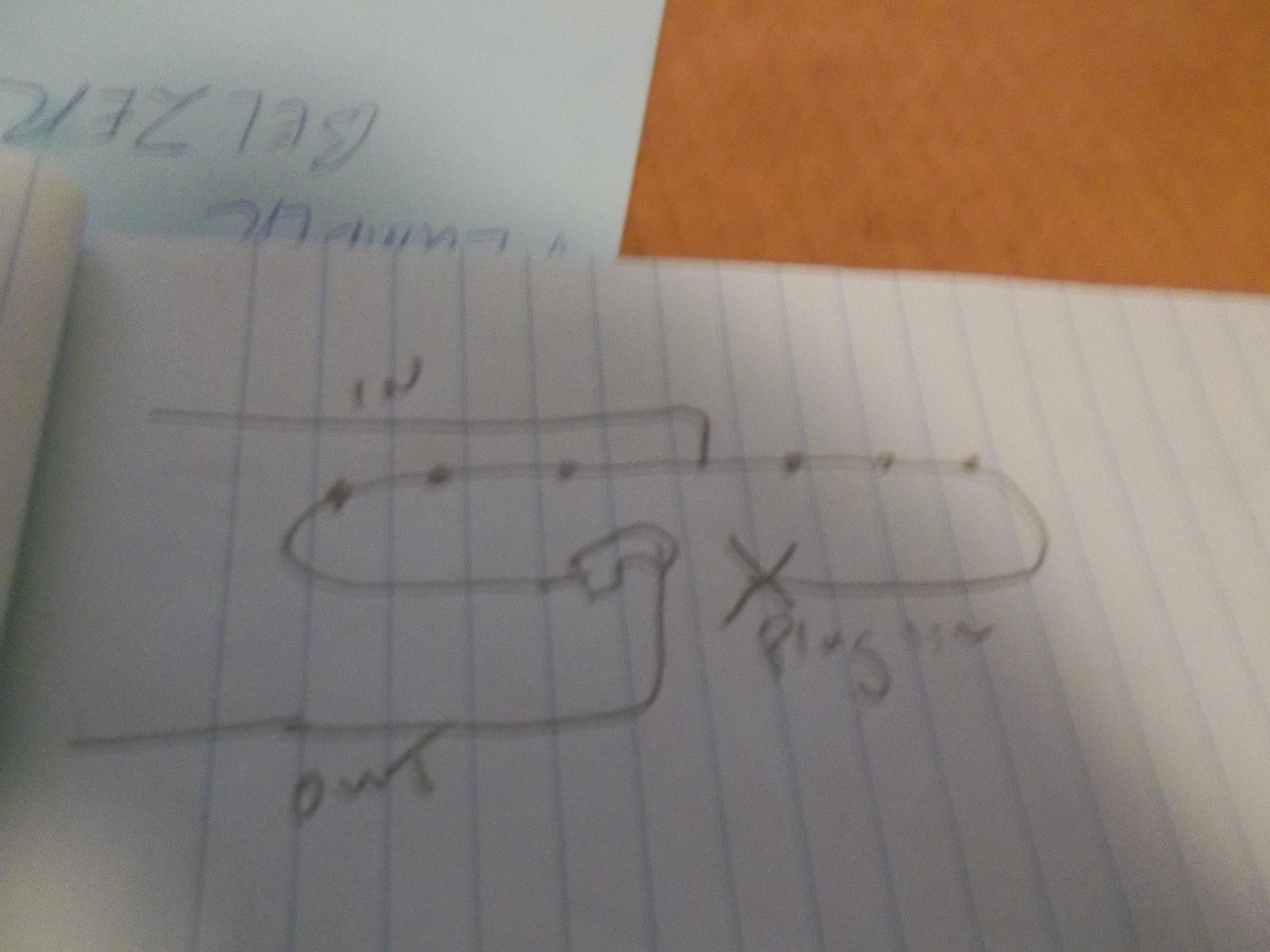

DaveWM, what about a set up like this....?
And, if this will work, let's make sure I understand the test and the potential results.
Without the FPR in the way of the fuel return line, the unrestricted fuel flow should go right back to the tank and the fuel pressure on the gauge should drop.
If the fuel pressure does not drop, then I have a CLOG somewhere in the metal fuel return lines going back to the fuel tank, which is causing the high fuel pressure.
Do I understand this correctly?
as you can see the fuel will flow along one side of the rail and return to the tank with no restrictions, should have very low recorded fuel pressure. Two pieces of hose one for bypass one with a bolt in it to plug is all you need.
