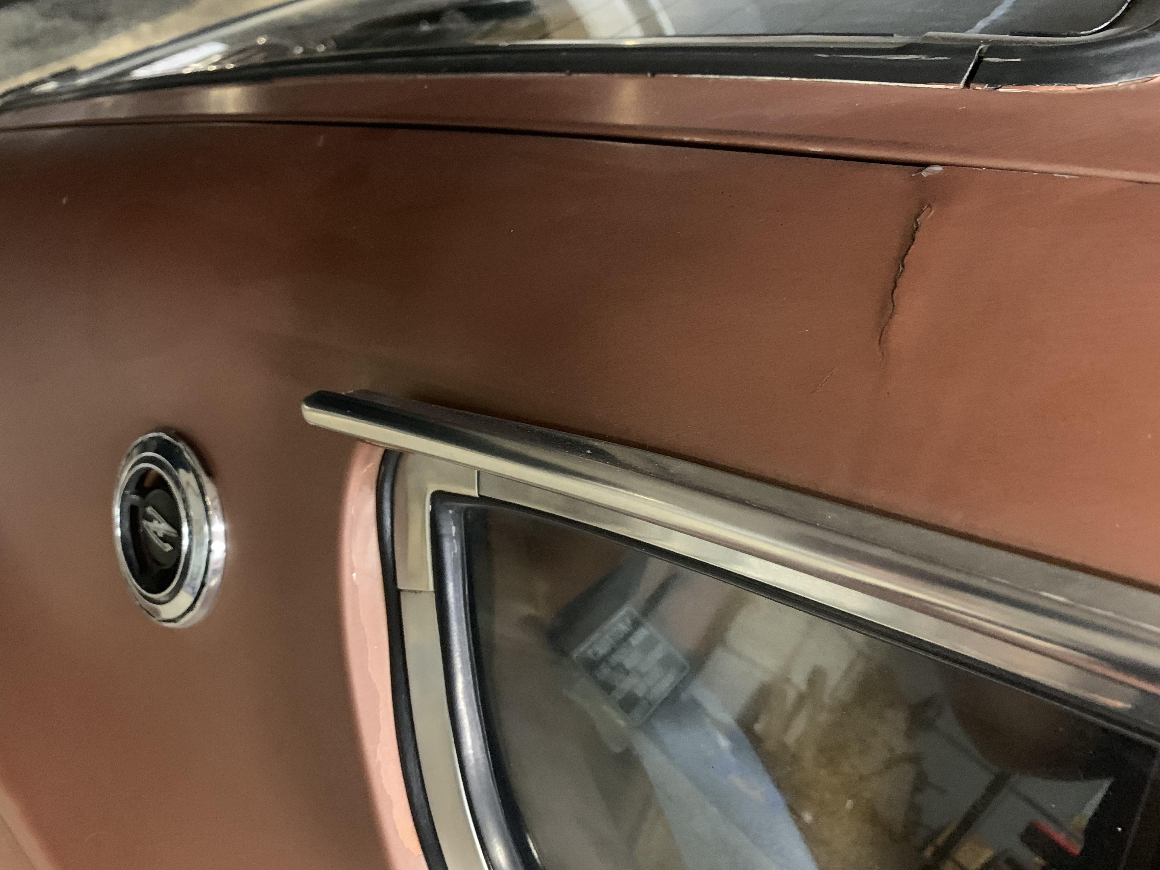

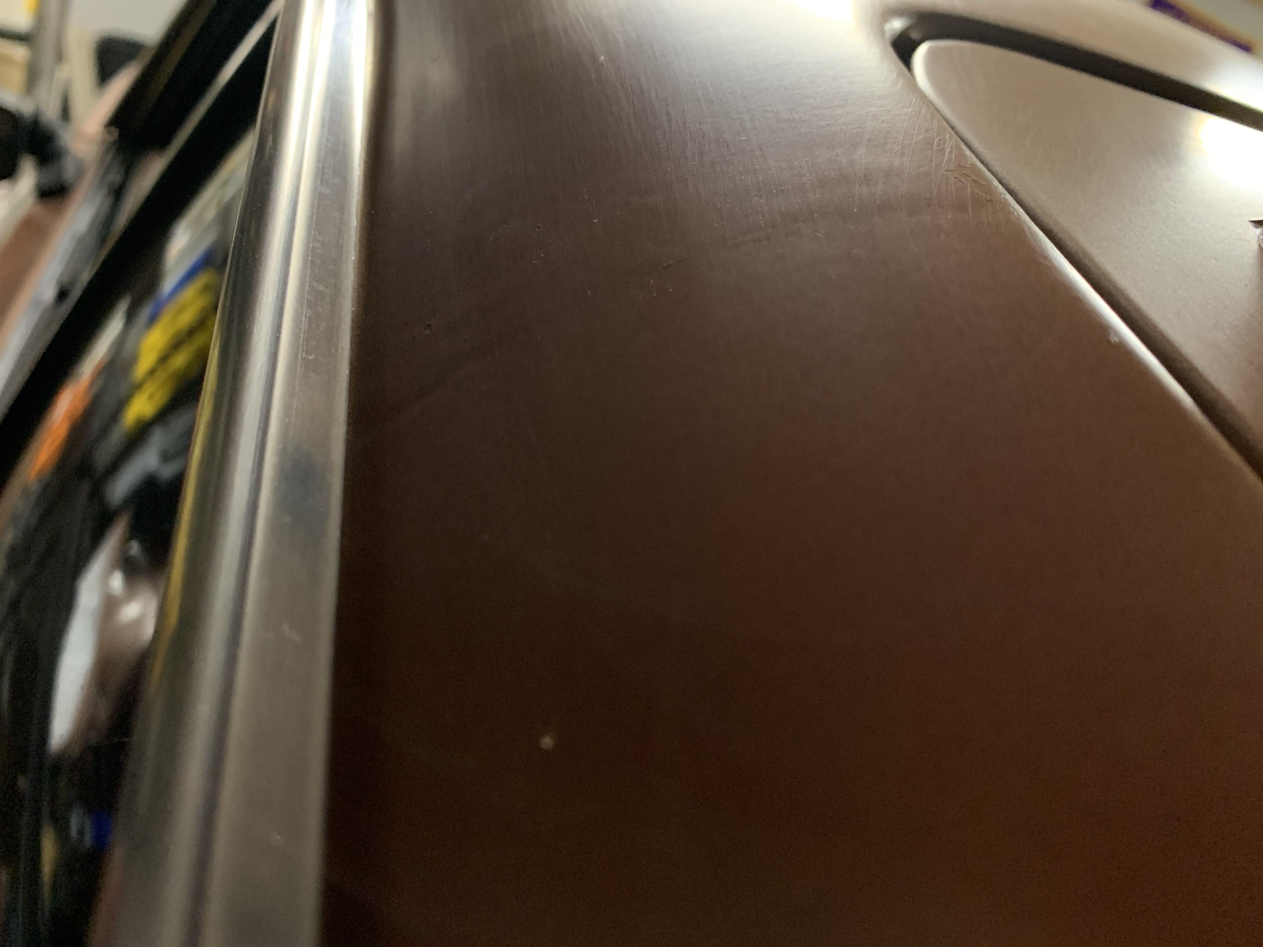

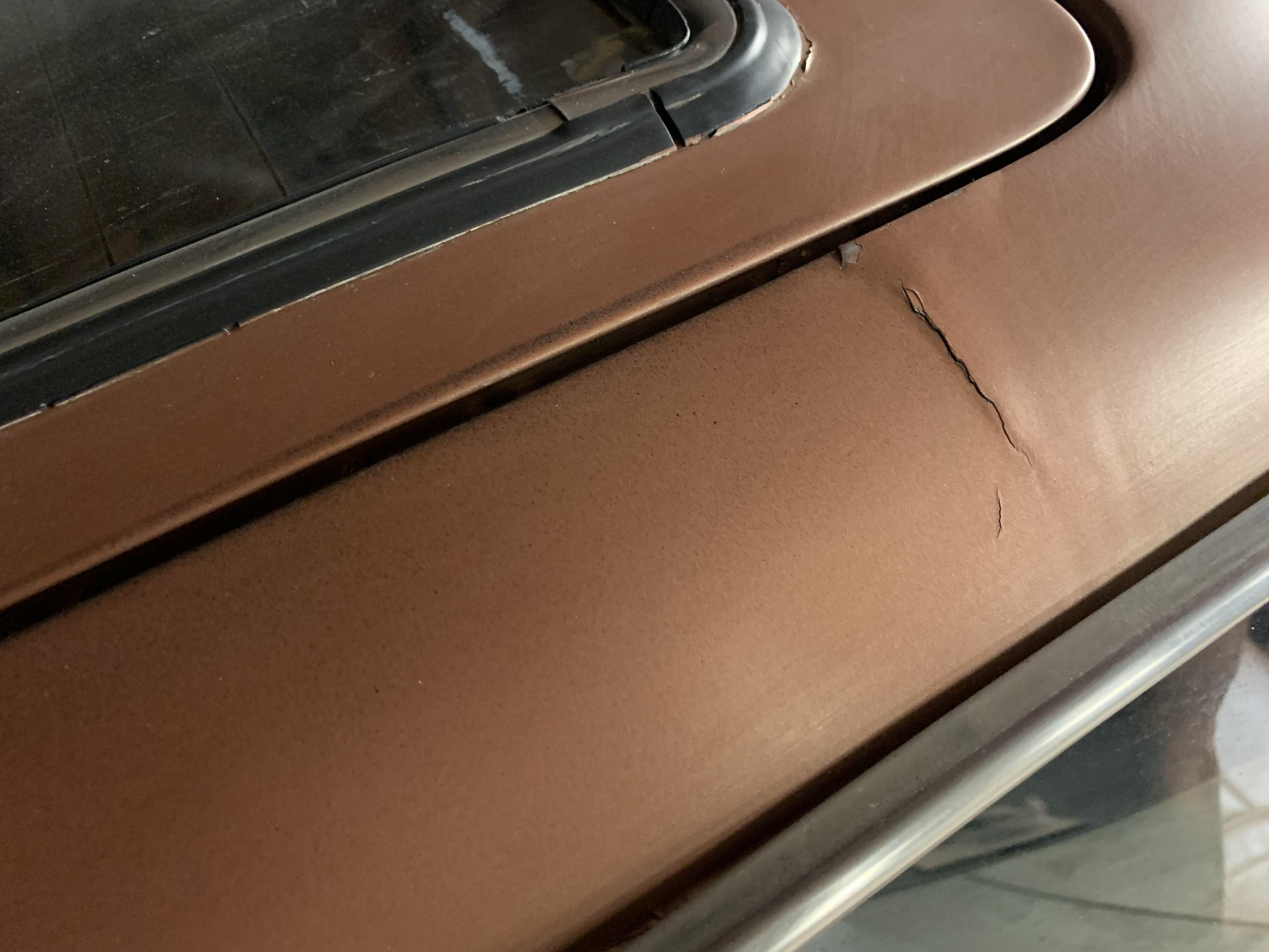

I been meaning to ask what this crack near the passenger side quarter panel could be. The driver’s side is slightly raised (middle photo). Is this frame damage or rust? Can it be fixed?
Today I fixed a leak! The transmission leak was caused by the mechanic not tightening the drain bolt?
Edited by BayAreaZ650
That is the lead weld that holds the roof to the rear quarter panels or sails.  They used lead so the joint could flex a bit and still stay smooth. Most Z's don't have a problem with the joint cracking but sometimes, if the car has been thrashed on the track and the body has been over stressed you will see cracks forming at that seam,  also, sometimes water gets to the lead, it oxidises/expands and a crack forms.
The D/S looks okay it just needed a bit more smoothing before it was painted, the P/S looks like the water has gotten to it.  The only way to fix it is take that area down to bare metal and dig out all the punky lead, hopefully the water hasn't gotten to the steel yet.
Bayarea
Don't get the idea to weld the roof joint up solid. The car needs to flex some and the designers selected this area to flex. If you make it too ridgid you could crack the A pillars or some other area on the car!

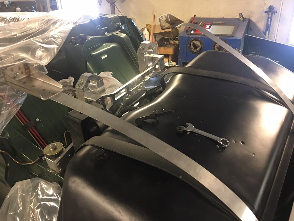

Today I dropped my fuel tank to be cleaned by my local radiator shop. The tank had a bit of rust.
What would be good to use to replace the rubber liner that goes between the fuel tank straps and fuel tank?
