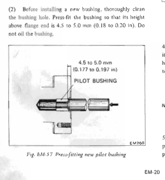

Like Mark said, the pilot bearing/bushing in the crankshaft aligns the input shaft. Check it before you fit the transmission. If it is a bronze bush, lightly grease it before installing the transmission. If it is a bearing, it should turn freely.
 If you haven't installed the pilot bushing, bearing, slide it onto the input shaft just to be sure it fits. Same advice for a new clutch disc. VOE.
Nissan has the stuff for that project all spread out in the FSM.  The pilot bushing is in Engine Mechanical, but it should be in Clutch or Transmission.  I've had one get stuck when installing, had to break it out and buy a new one.  Wide tolerances on aftermarket parts.
