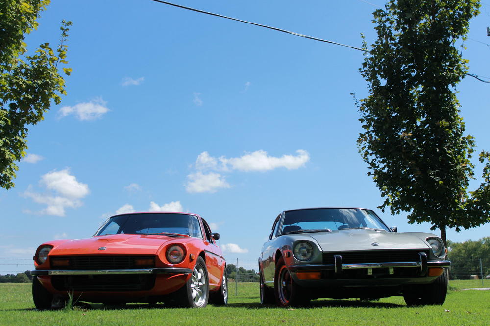

I will look for a better side pix to post.    Orange car is my lowered 77.
Oh cool! Your z looks phenomenal!

Here is a side shot with my 15" cold weather, off season setup ....
