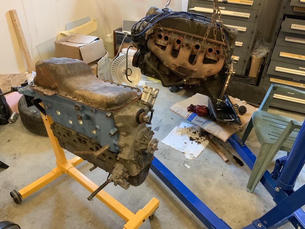

F54 block has this adapter sticking out The side. Can this just be removed and the filter installed as per the regular manner (straight to the block)? It unscrews, however the filter fastener is in the adapter knuckle.

25 minutes ago, Sailor Bob said:
ZH, i was hoping that was the answer. The Courtesy nissan link doesnt seem to be working. #14 looks like threaded pipe.
Sometimes the CZCC site will take a pasted link and sometimes it won't.  It's not consistent.  Looks like it didn't this time.  Have to click the little chain link, then paste, then save.
Here it is after a bunch of extra effort - https://www.courtesyparts.com/oem-parts/nissan-oil-filter-stud-15213w040a
35 minutes ago, Zed Head said:
If you Google the part number you'll probably find a few sellers.  Your local Nissan dealer might get it for you with free shipping.
Don't even tell them the car right off, just run the part number. The youngsters like to argue what your asking for. My experience locally. Next day pick up if they have one close by usually.
