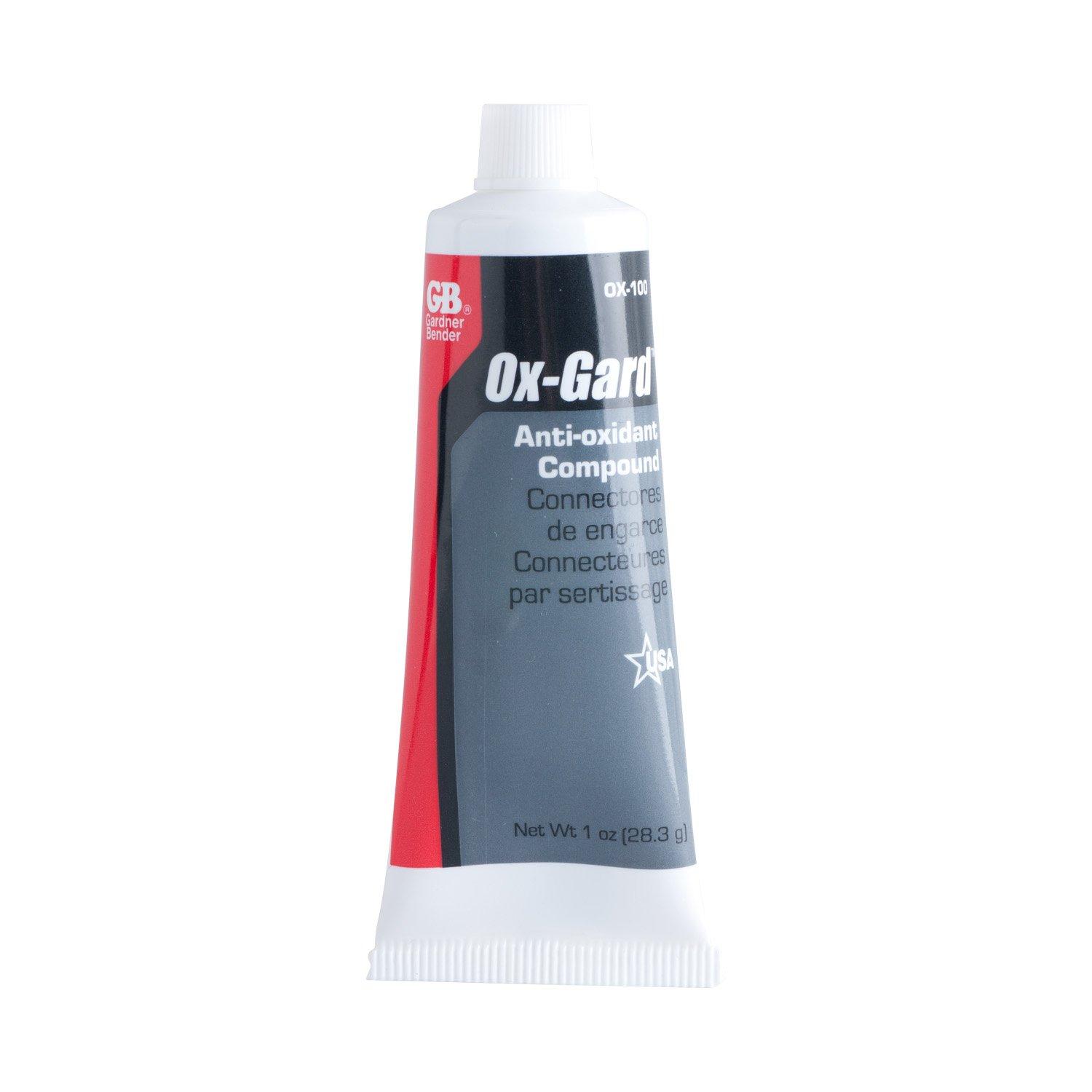

Dialectic grease as I understand it seals the contacts from further oxidation once the contacts are clean, it is not conductive itself.  You can use this stuff, a conductive graphite paste that increases surface area but it is only good on single circuit contacts like you are describing.  This paste is also excellent on freshly cleaned grounding contacts, battery terminals and such.
 Sounds to me like you have something else going on in the starter solenoid, there are 2 large copper contacts in there that need cleaning every 40 yrs or so.?

So I gave the ox-gard a shot and just like with the cleaning spray, it helped for a few days and now I'm back to the labored first start problem again (I also changed the plugs/wires to the proper NGK branded products but that didn't help either).
