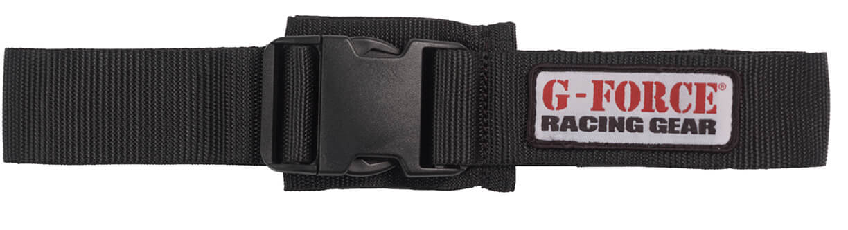

BTW - this is also called a Torso Strap.  G-Force sells them, and it's just a strap made from Nylon webbing with a big plastic pinch clip.  They just sell them, and don't tell you how it's used or installed.
