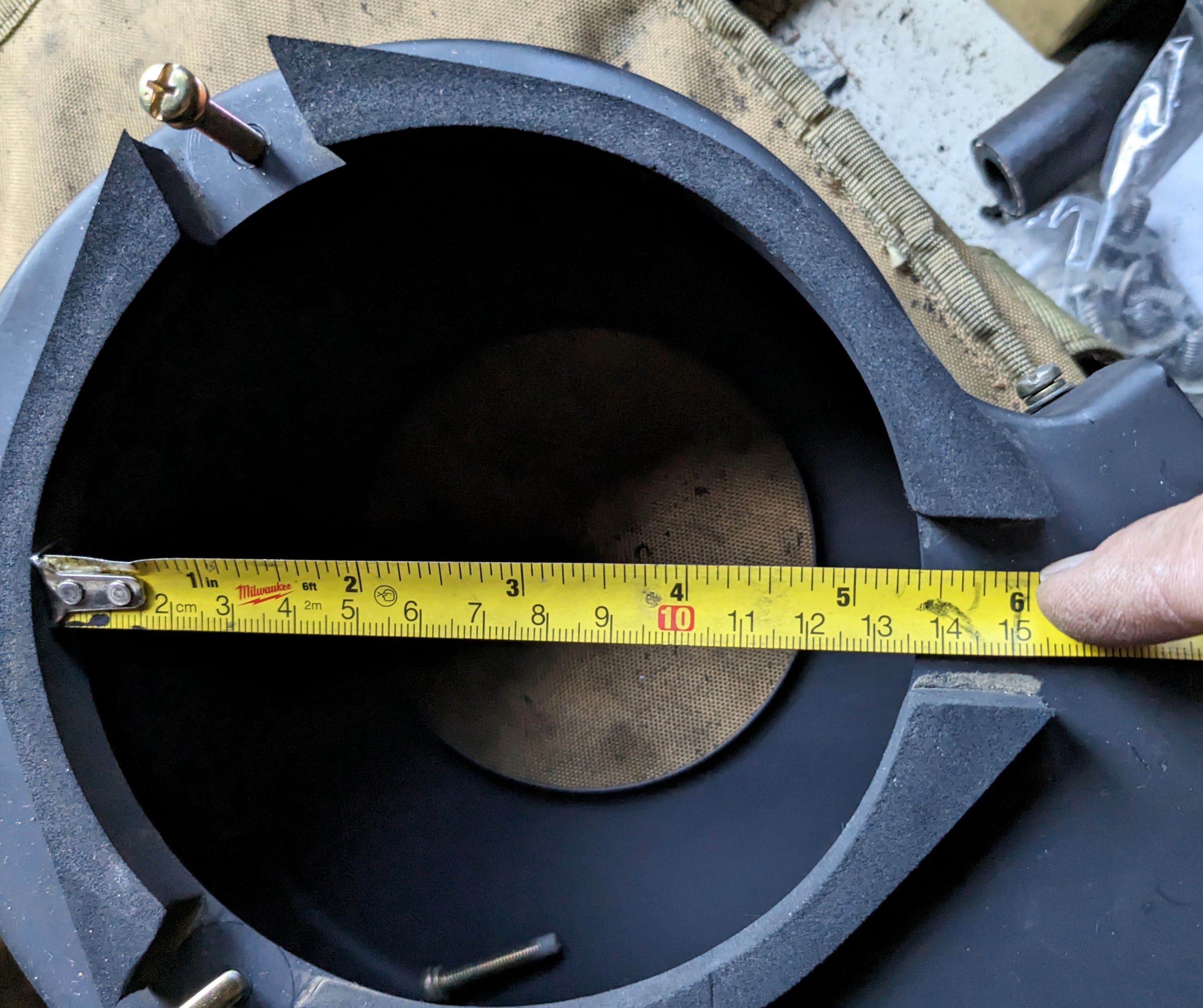

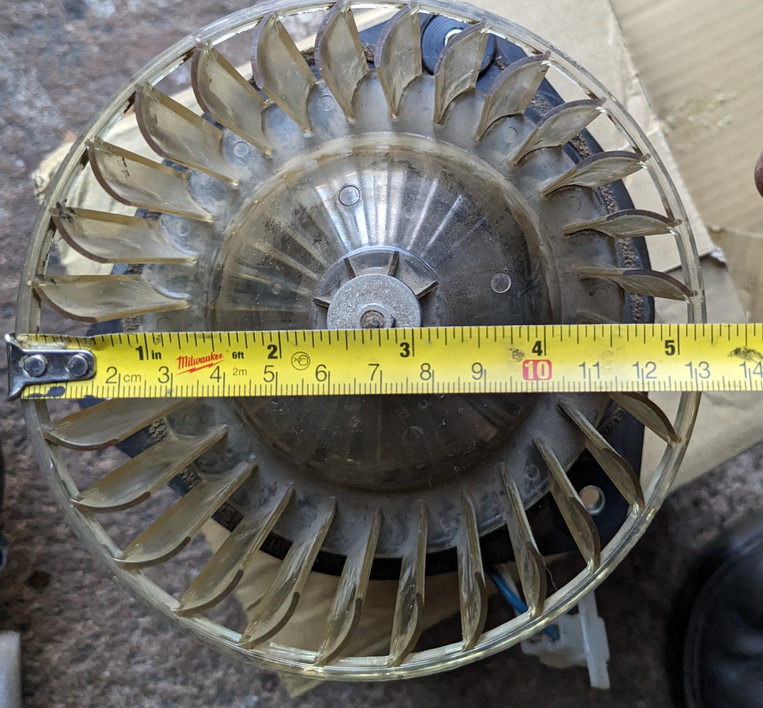

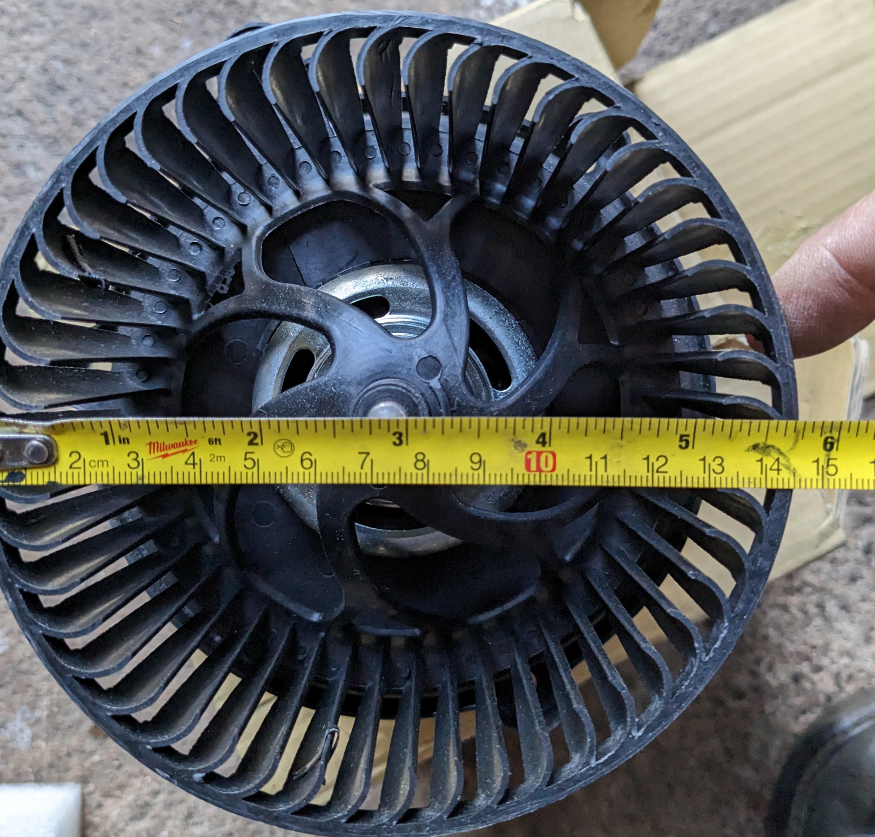

Pics of my box opening, stock motor cage & Kia (4Seasons) cage. Cages are not interchangeable, shaft design varies
5 3/8" opening
Stock cage just under 5 1/4"
Kia Cage 5 3/4" (!) 1/2" is too much meat to remove - the wall is pretty shallow in the 2 o'clock area above
