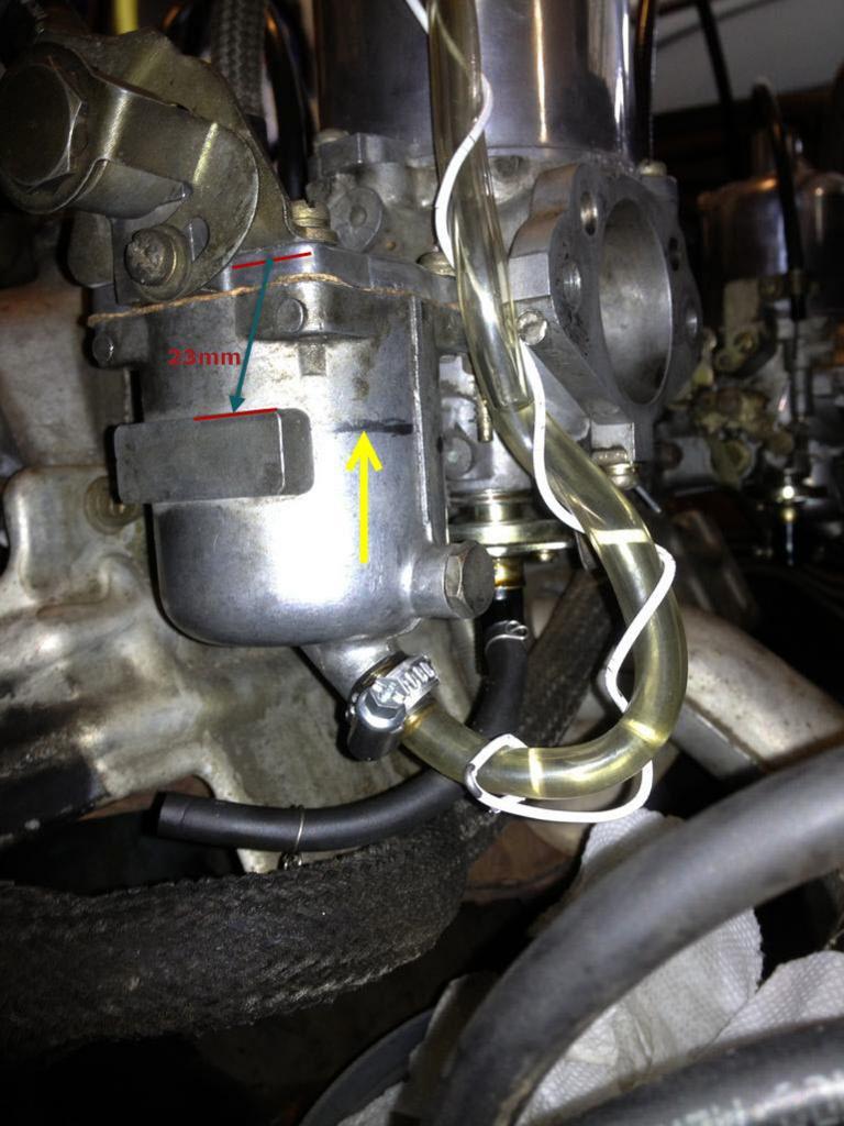

As a quick and inexpensive way to check fuel levels I used this first and saw how low mine were then went deeper, pun intended.
Edited by siteunseen
