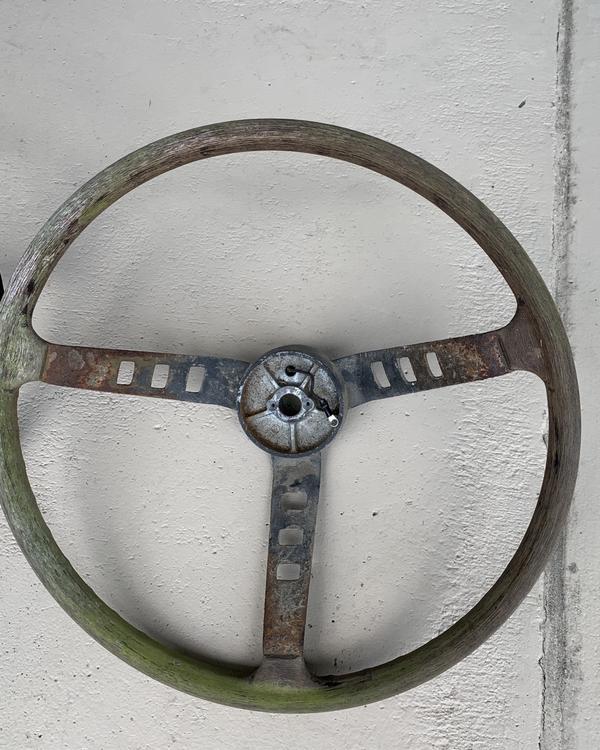

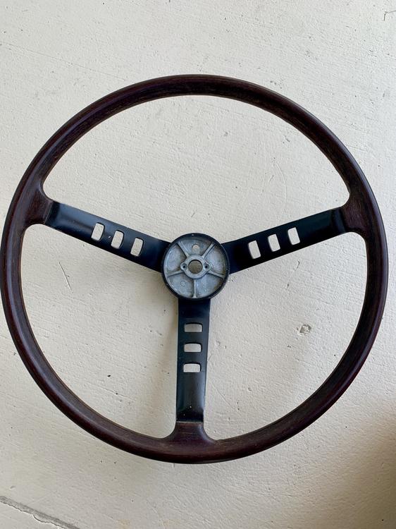

Av8ferg Posted May 24, 2019 Author Share #25 Posted May 24, 2019 Upper left "Natural" looks like factory. Yeah, you’re probably right. I’m not sure I’m a fan that. I have three steering wheels. This will be my test case. Interesting, the nicest one I have had a leather wrap on it when I bought it from a guy in Montana that owned the car for a decade. The wrapped looked like it was from the 70’s. Under it was pretty dark so I’m doubtful it was ever refinished. They may have changed the colors as the production progressed. Here a pic of that wheel. Sent from my iPhone using Tapatalk Link to comment https://www.classiczcars.com/topic/62221-steering-wheel-restoration/?page=3#findComment-576196 Share on other sites More sharing options...

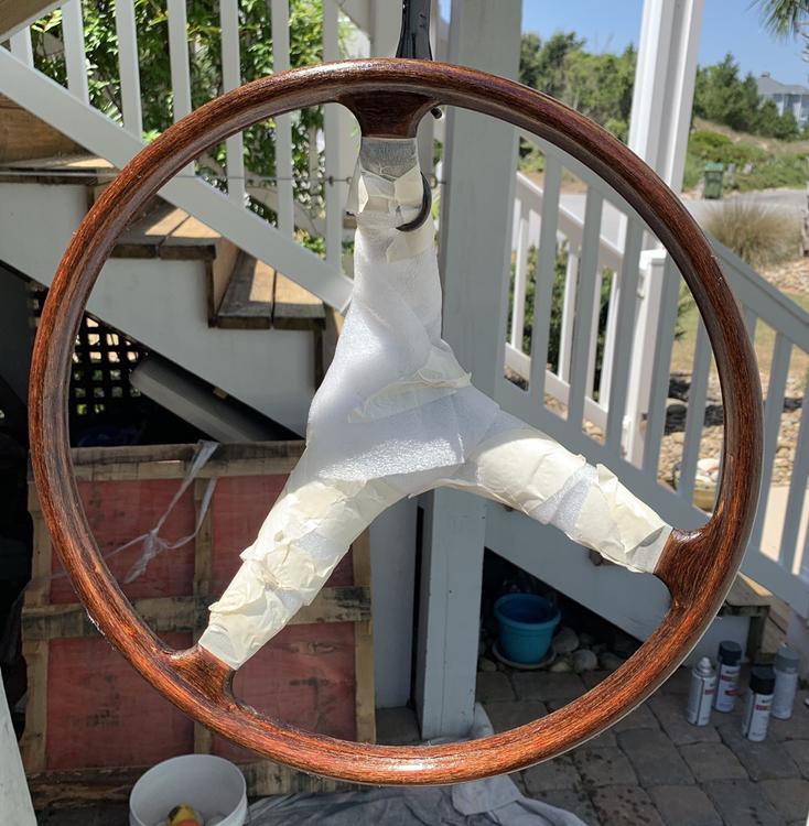

jfa.series1 Posted May 24, 2019 Share #26 Posted May 24, 2019 1 hour ago, Av8ferg said: Going for Red Sedona Sent from my iPhone using Tapatalk Keep in mind that stains respond differently depending on the type of wood and type of stain. My stain was Behr, an oil-based stain. Your results may vary! Link to comment https://www.classiczcars.com/topic/62221-steering-wheel-restoration/?page=3#findComment-576197 Share on other sites More sharing options...

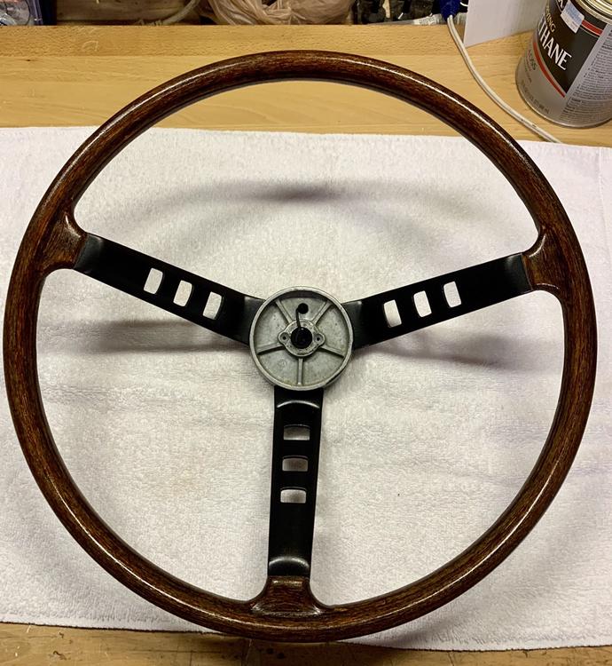

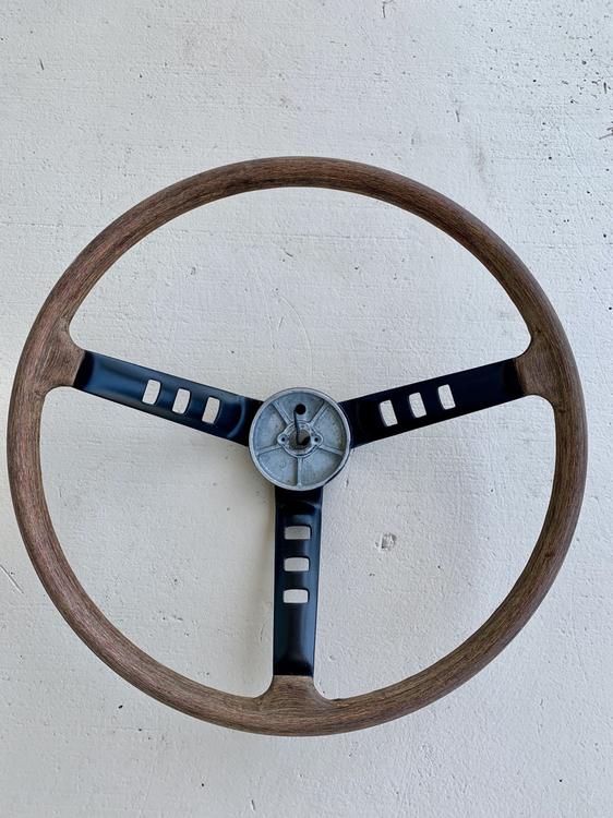

Av8ferg Posted May 24, 2019 Author Share #27 Posted May 24, 2019 Good point JFA. Change of plans. Going to just put to poly on and see what happens, I can always sand it off if it looks bad. She looks pretty good now with the wheel prepped. Check it out. Sent from my iPhone using Tapatalk 2 Link to comment https://www.classiczcars.com/topic/62221-steering-wheel-restoration/?page=3#findComment-576200 Share on other sites More sharing options...

Popular Post Av8ferg Posted May 24, 2019 Author Popular Post Share #29 Posted May 24, 2019 Okay, first coat of Poly on and I’m glad I didn’t stain it. The poly brought out the natural color nicely. I’ll let it dry a couple days, wet sand it smooth and put another coat of poly on. So my advice so far for people looking at this thread in the future. Don’t stain it! Sent from my iPhone using Tapatalk 6 1 Link to comment https://www.classiczcars.com/topic/62221-steering-wheel-restoration/?page=3#findComment-576202 Share on other sites More sharing options...
Av8ferg Posted May 24, 2019 Author Share #30 Posted May 24, 2019 Still needs one more coat of poly and a wet sand but here’s the before and after pics. I’m pretty happy with the outcome. Sent from my iPhone using Tapatalk 2 Link to comment https://www.classiczcars.com/topic/62221-steering-wheel-restoration/?page=3#findComment-576236 Share on other sites More sharing options...
Duffman Posted May 24, 2019 Share #31 Posted May 24, 2019 Kinda missing that green ... ? Nice work!! Link to comment https://www.classiczcars.com/topic/62221-steering-wheel-restoration/?page=3#findComment-576238 Share on other sites More sharing options...
Dave WM Posted May 24, 2019 Share #32 Posted May 24, 2019 they clean up nicely. Good work. Link to comment https://www.classiczcars.com/topic/62221-steering-wheel-restoration/?page=3#findComment-576240 Share on other sites More sharing options...
