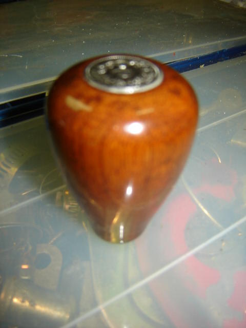

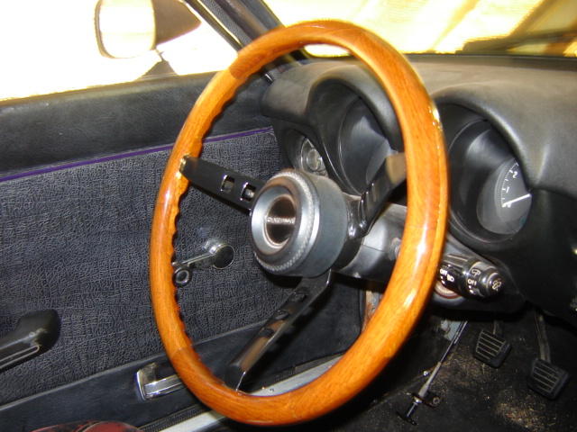

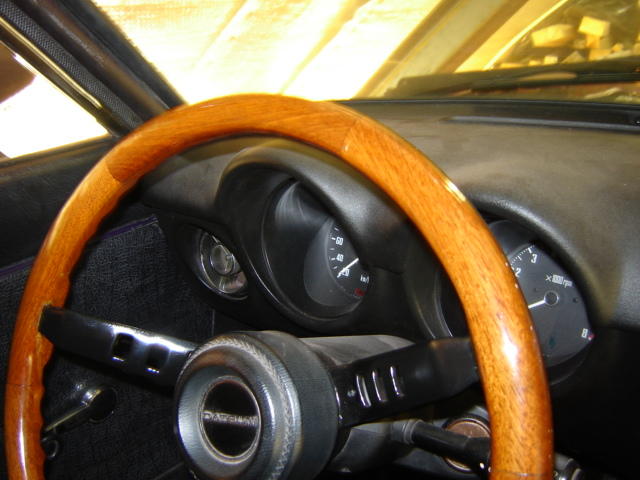

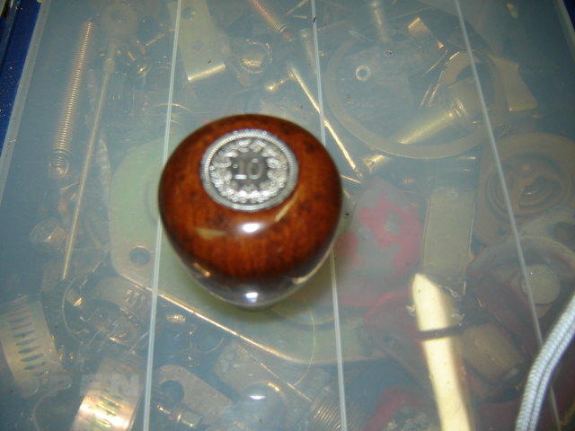

dutchzcarguy Posted May 25, 2019 Share #38 Posted May 25, 2019 In 2007 i took an old wheel and pulled the fake wood (resin and wood powder mix) off and made myself a fat mahogany wooden wheel! It was 38 hours of work.. 8 layers of blank laquer.. and lots of sanding was involved.. came out nice.. (metall in semi gloss black) There is a ring of 6.5 mm in the wheel.. I made 6 parts on the front hollow and 6 massiv parts at the back, glued the front parts with 2-comp. glue to the metall and the wooden parts with prof. wood glue (water resistant) together.. With a matching gearknob, made on a wood lathe. joke from myself.. the 10 means 10 years of work on my Z ? 2 Link to comment https://www.classiczcars.com/topic/62221-steering-wheel-restoration/?page=4#findComment-576268 Share on other sites More sharing options...

dutchzcarguy Posted May 25, 2019 Share #40 Posted May 25, 2019 Funny is the parts box with all kind of Datsun stuff under the knob (also a few non Datsun parts..) 1 Link to comment https://www.classiczcars.com/topic/62221-steering-wheel-restoration/?page=4#findComment-576270 Share on other sites More sharing options...
siteunseen Posted May 25, 2019 Share #41 Posted May 25, 2019 I just realized that! Very cool wheel. 1 Link to comment https://www.classiczcars.com/topic/62221-steering-wheel-restoration/?page=4#findComment-576271 Share on other sites More sharing options...
Av8ferg Posted May 25, 2019 Author Share #42 Posted May 25, 2019 Dutchzcarguy,That’s some varsity work, way outside my novice ability. Pretty impressive!Sent from my iPhone using Tapatalk Link to comment https://www.classiczcars.com/topic/62221-steering-wheel-restoration/?page=4#findComment-576272 Share on other sites More sharing options...
