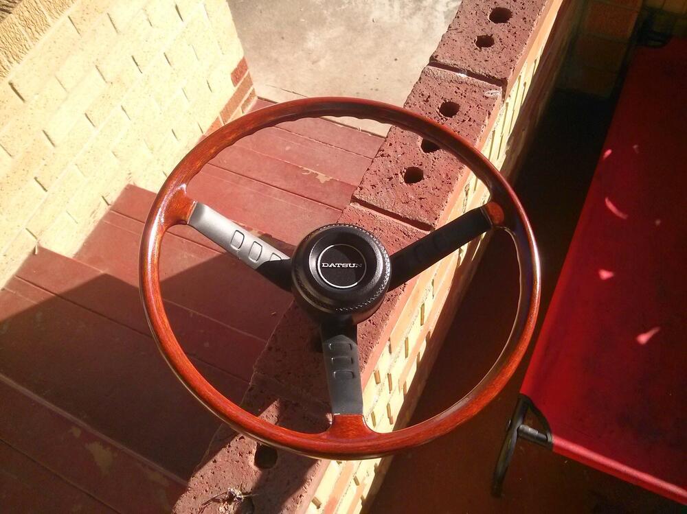

2 hours ago, dutchzcarguy said:
At first you did this:
And then desided to go original!  Yep i like your wheel! You've  done a good job on it! 👍
Thanks! I'm glad it turned out so good. As for the carbon fiber spoke I was just trying to get an idea how it would look....I have a big roll of the stuff and nothing to do with it 😅

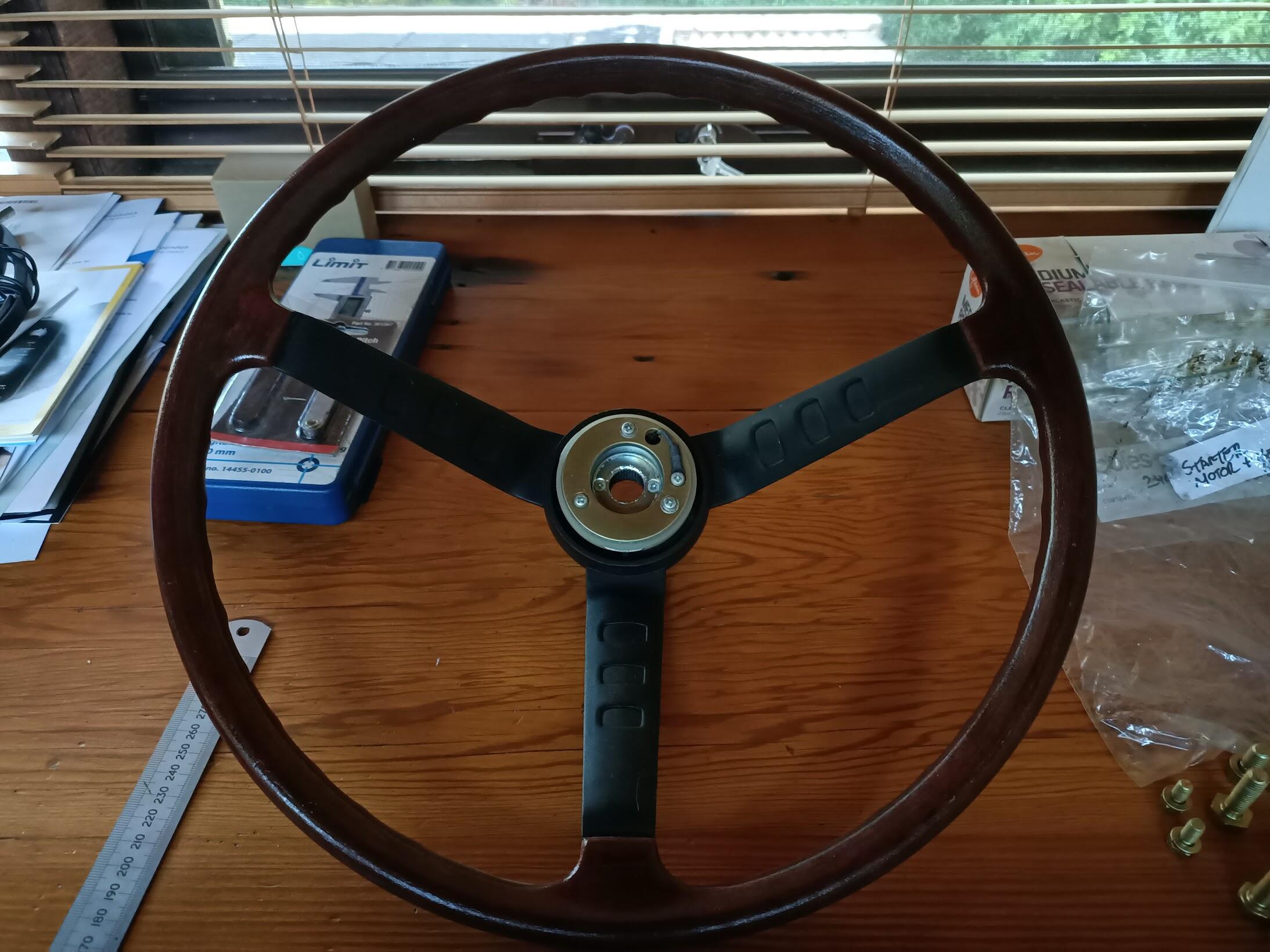

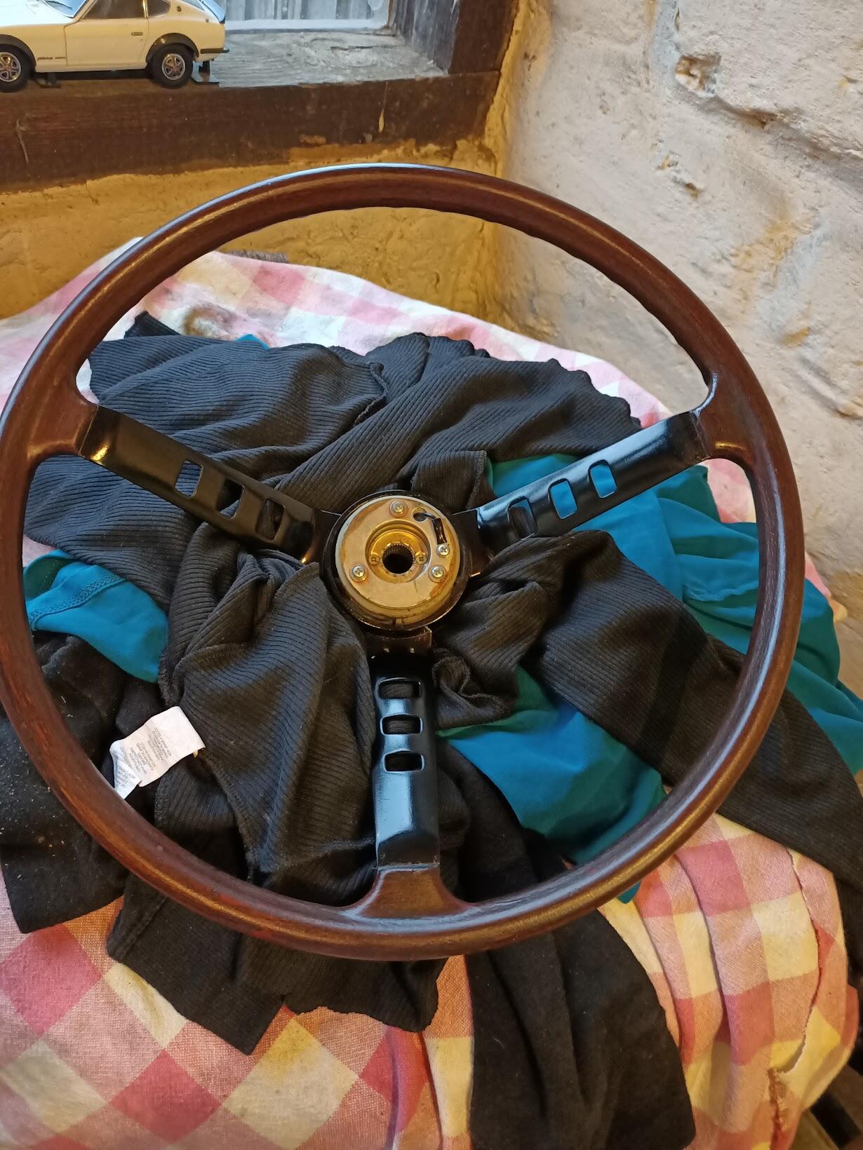

Well I pulled my steering wheel to refinish the rim. After cleaning and steel wool It looks like this.
I may just use polyurethane on it like others here. I think that will still keep some patina.
In some areas with very little wear, I can definitely see it has a cherry color to it.

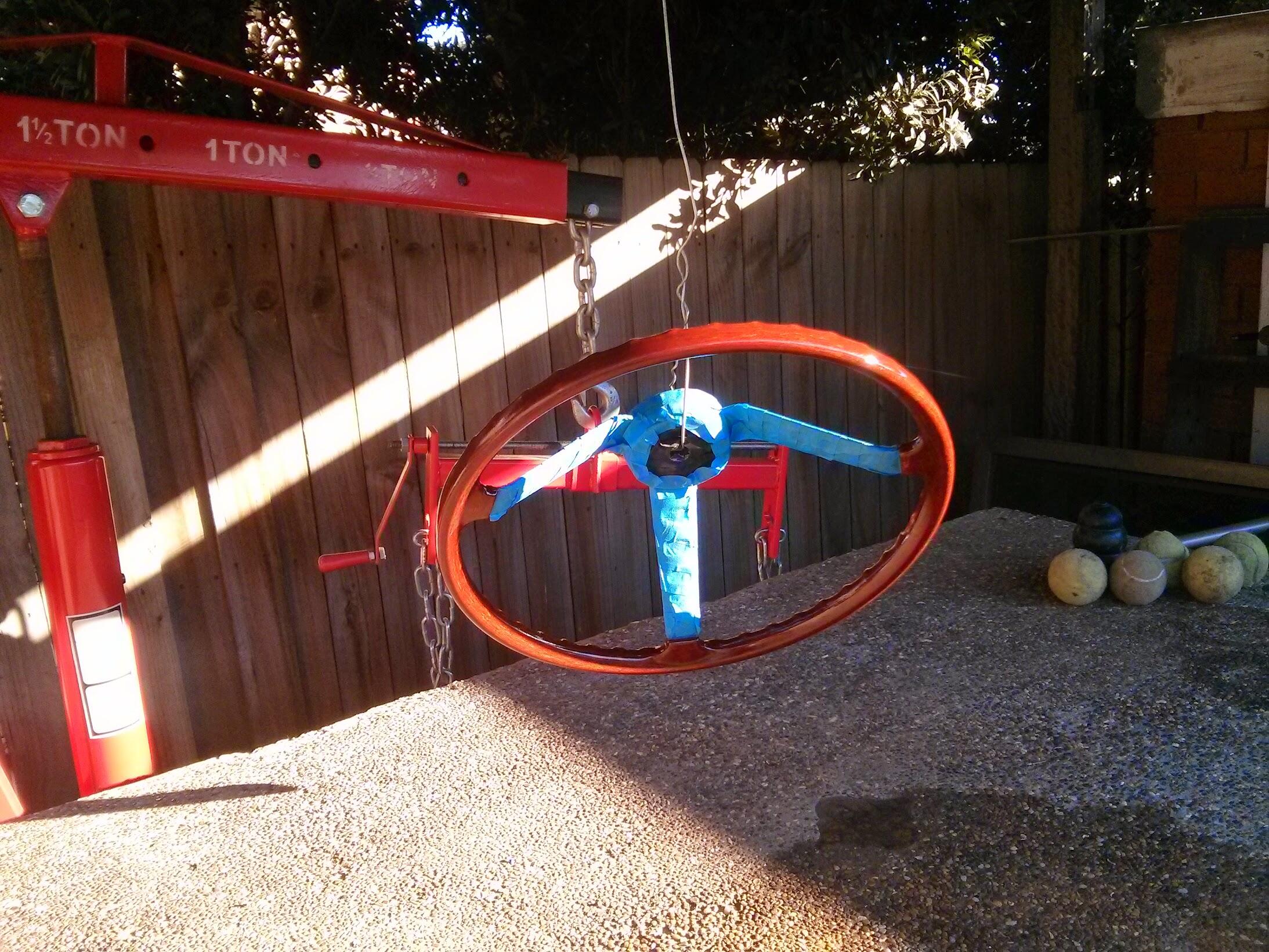

I've done a few of these wheels now, first photos are of 1 I stained and used polyurethane to refinish the wooden rim.
The flat black paint was too black, I may re-do it in future.
Next wheel I used roll bar paint in a semi-gloss black and it looks much nicer and closer to the original wheel finish for the paint.
On this wheel I used a more flat rather than gloss polyurethane finish but I prefer the "pop" of the wooden rim above. However the spokes look better.
Here is another wheel with re-plated hardware.

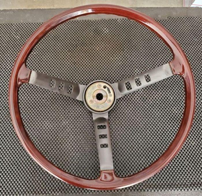

And here is 1 refinished by Romas (from Facebook).
He used automotive clear coat to get the glossy rim, which I like.
For comparison, here is a NOS in the box wheel.

I took was confused by the "blonde" looking colour in brochures, but have decided over time they must get darker and I'm fine with that as I actually prefer the dark redish colour. And I quite like the gloss on the wheel and semi-gloss black on the rim and of course the re-plated hardware. Some day I'll refinish 1 of these "just right". ha.
Yes, very nice .. but i ask myself if that clearcoat is strong enough.. i used 7-8 coats of boat lacquer, the one you would use on those hardwood boats..
