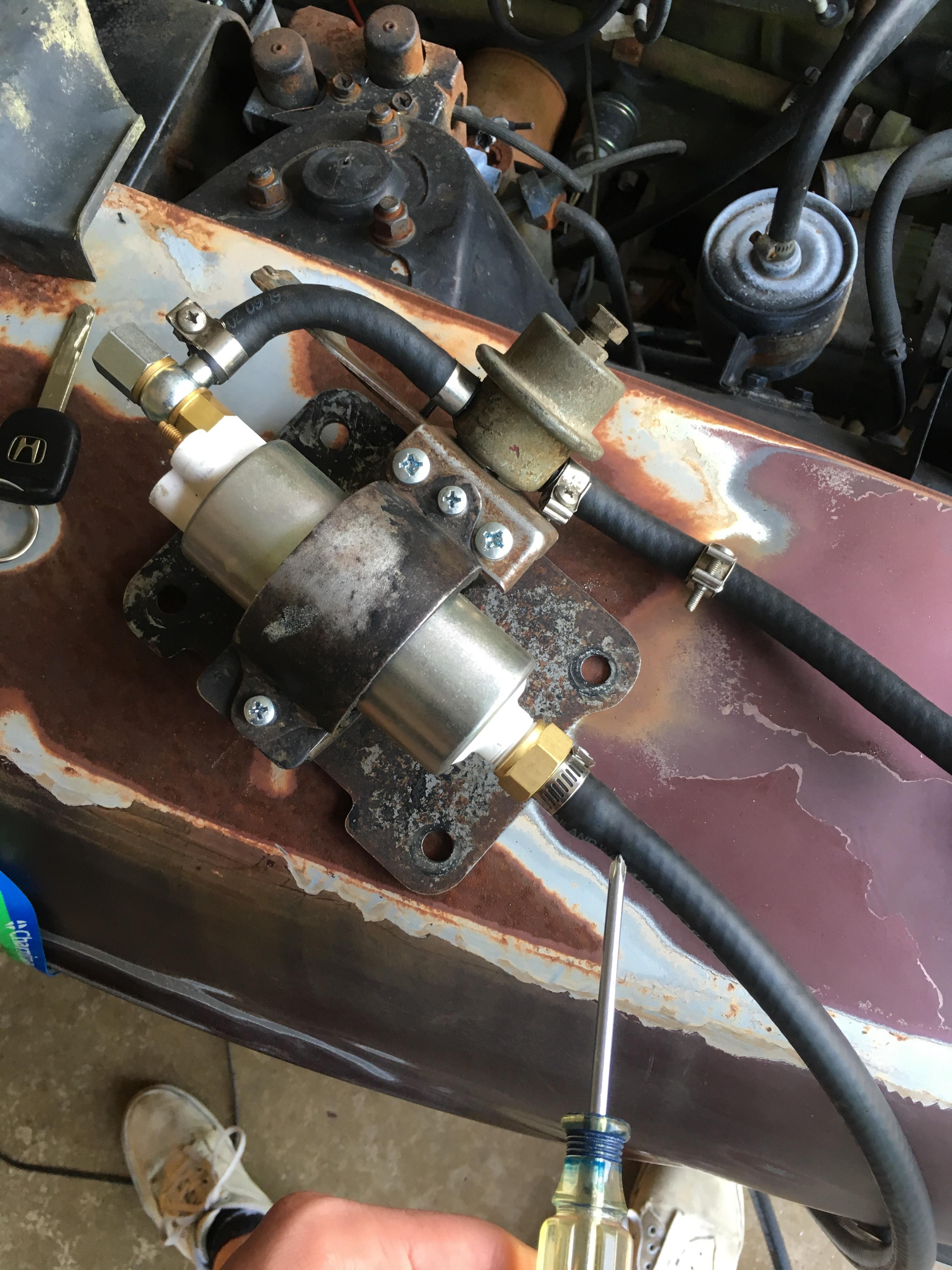

I just bought this new pump and got it installed in my 1977 280z,  but nothing seems to be happening. I don’t even hear it priming. Any suggestions? I even used the multimeter to make sure I was getting power, and I was I indeed. I don’t recall how much power I was getting, but it wasn’t a full 12v. Would that be an issue?

Make sure the positive and negative are correct and tight.
Also if you are in the car trying to listen for it you might just not be hearing it some are pretty quiet.
I hooked my battery direct to mine to verify
You should be getting very close to full battery power at the pump. Test at the battery to verify it’s voltage.

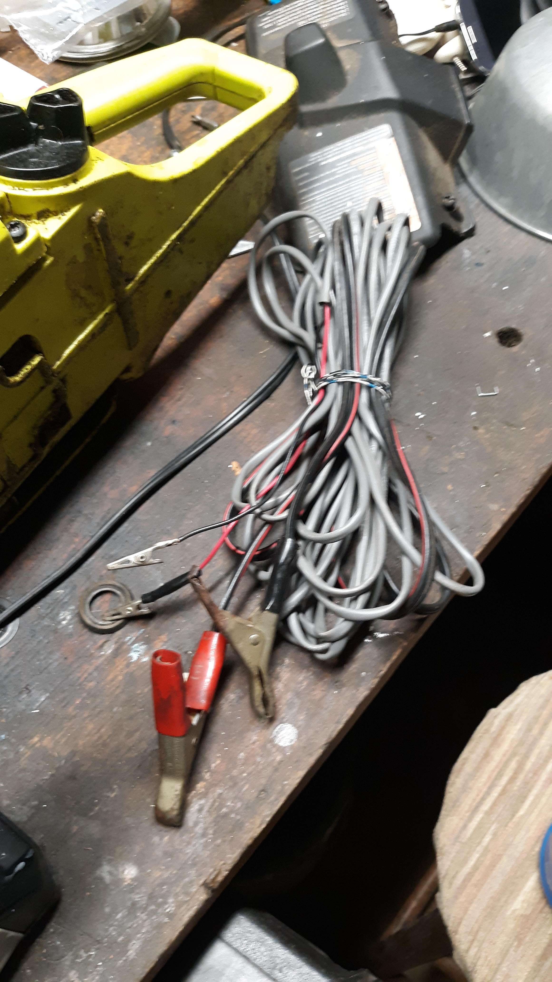

I did try connecting to the battery, but that was only with some spare speaker wire. I’ll try again with some lower gauge.

I used the same thing a Cliff. Speaker wire and alligator clips when I was troubleshooting my fuel pump problems. It worked fine.
