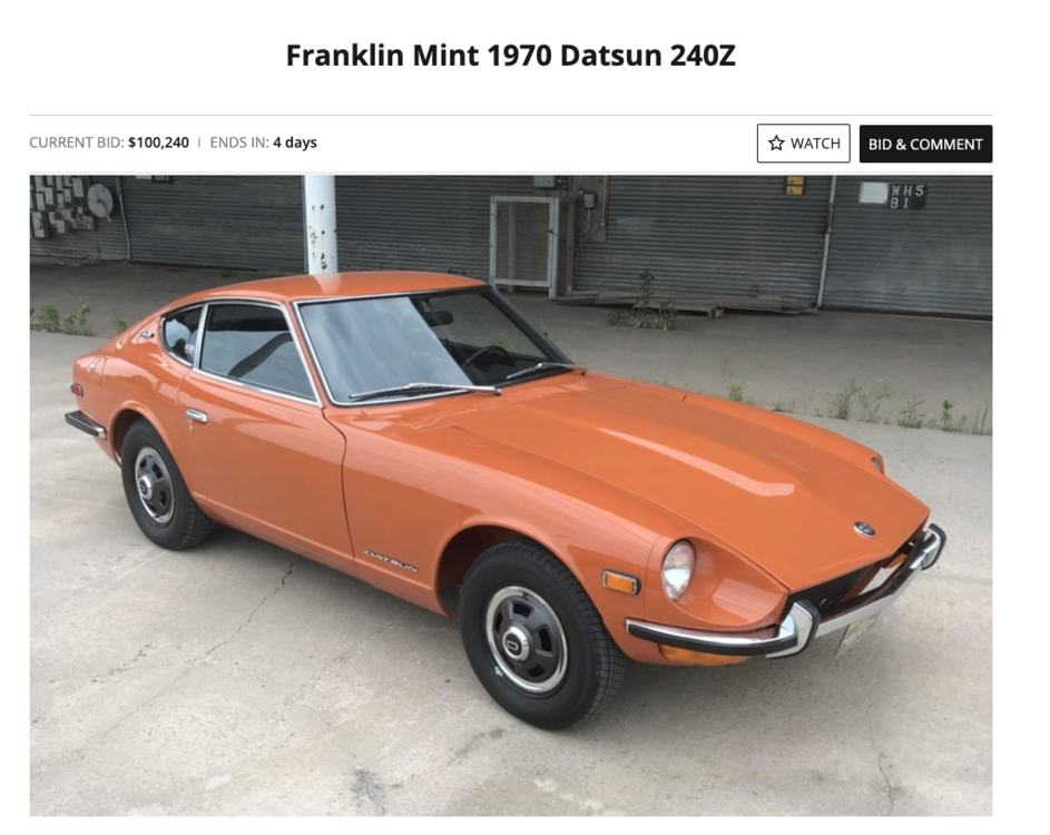

@motorman7 I like your "Where's Waldo" analogy to spotting items that may not be technically correct.  I had to look long and hard, but I found three. First I would comment that it feels petty even mentioning them on such an immaculate car but here they are anyway, please correct me if I am wrong.
- Later gas cap with bar type handle
- Later replacement alternator, should be "grapefruit style"
- Has series two dash with provision for cigarette lighter and on/off marking for hazard light switch
Again there so much to like about this car that these type of issues are eclipsed by what is right and its history.
