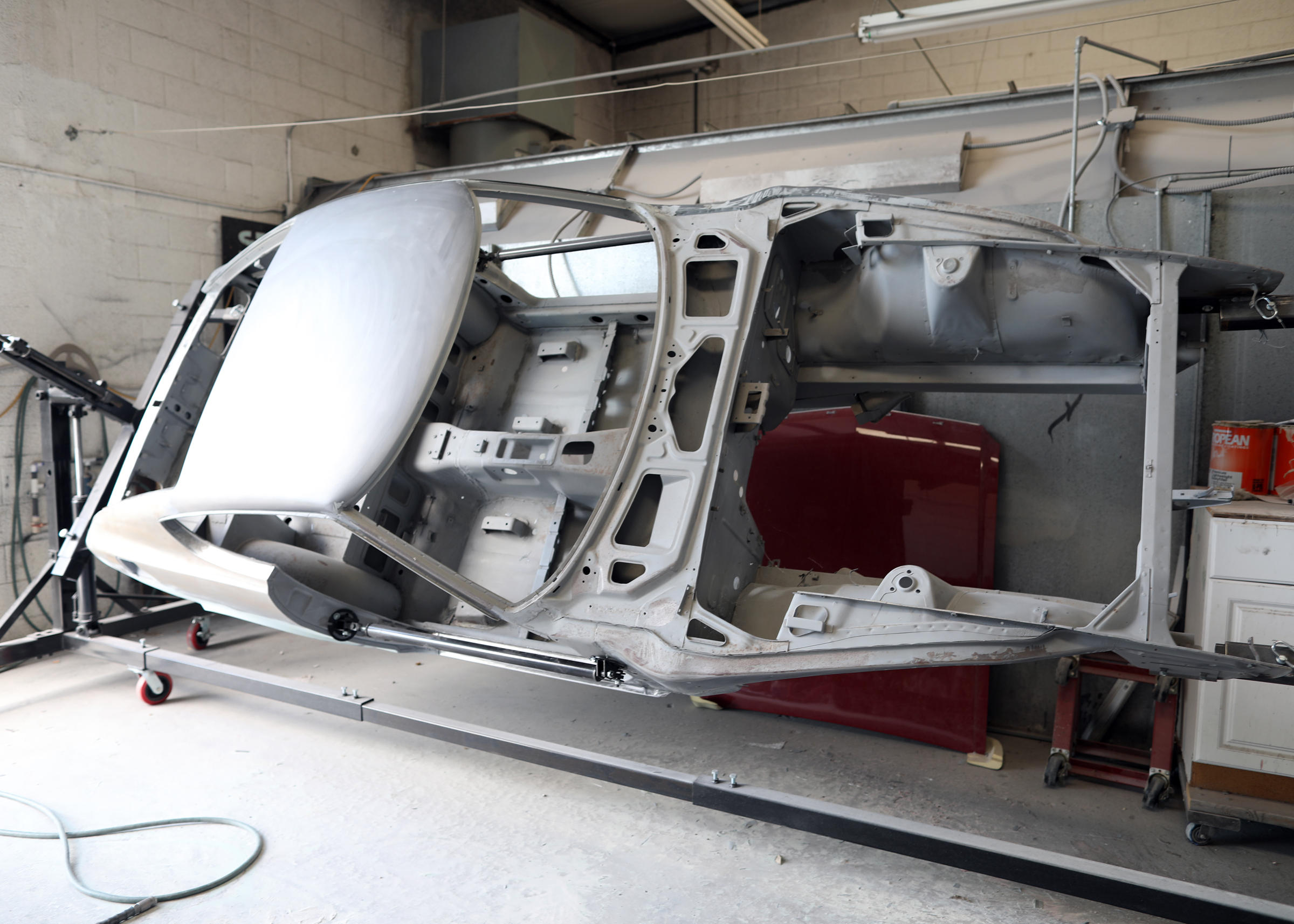

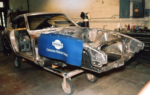

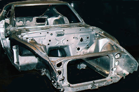

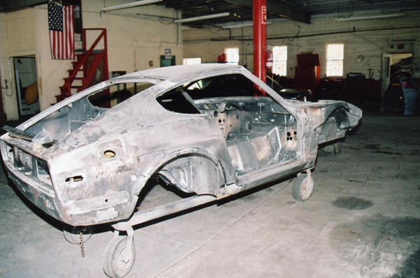

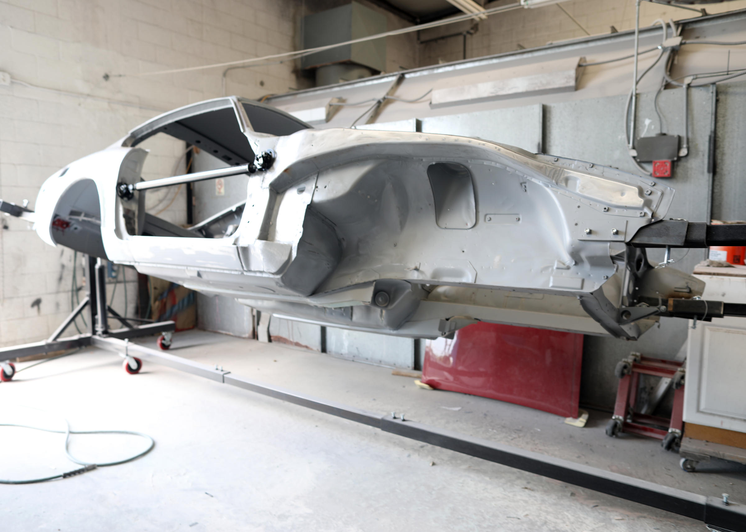

There is a place in Wachula, Florida that provides a complete rust removal process called reverse electrolysis.  The body shell is immersed in a big tank with electrodes and a sacrificial anode to remove all the iron oxides resulting in bare, rust free, metal.

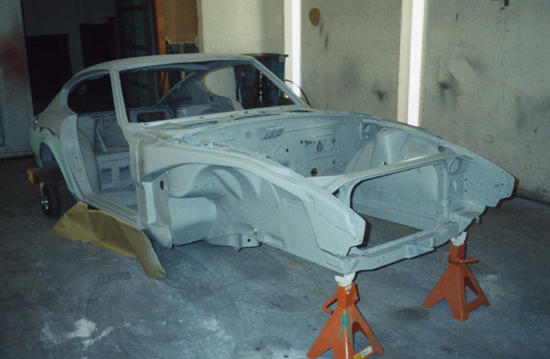

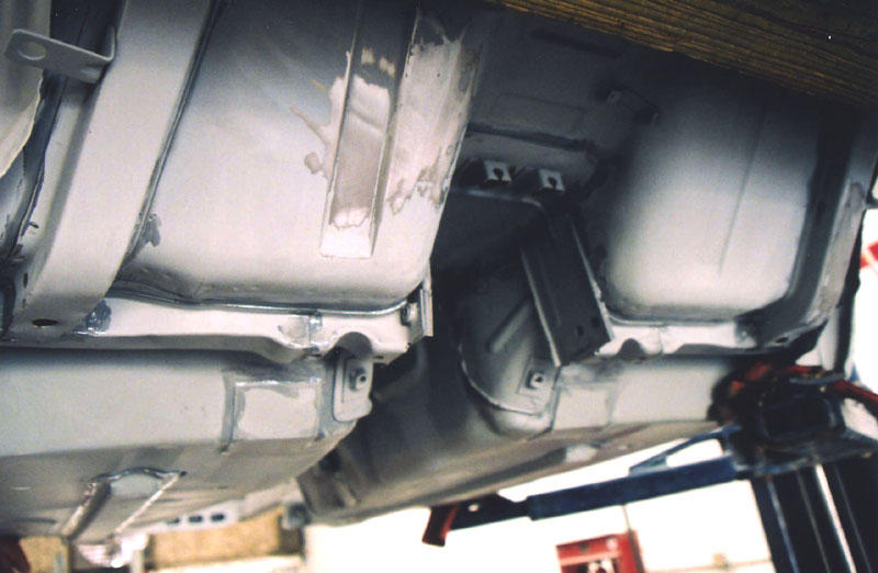

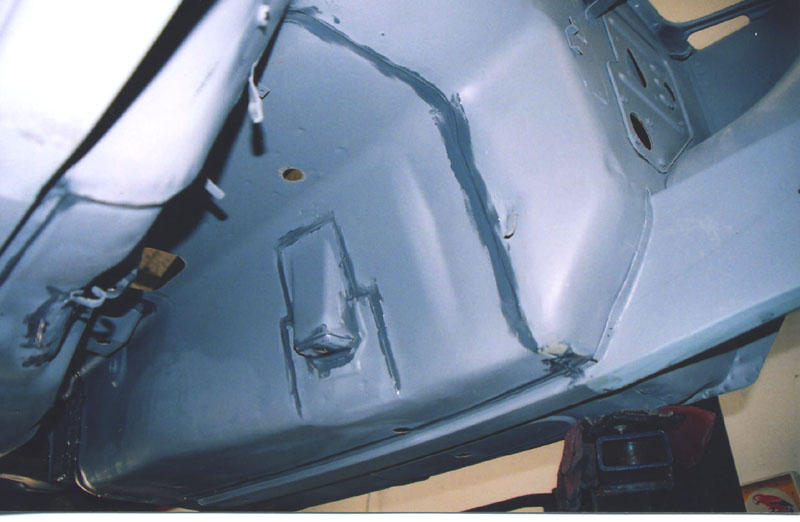

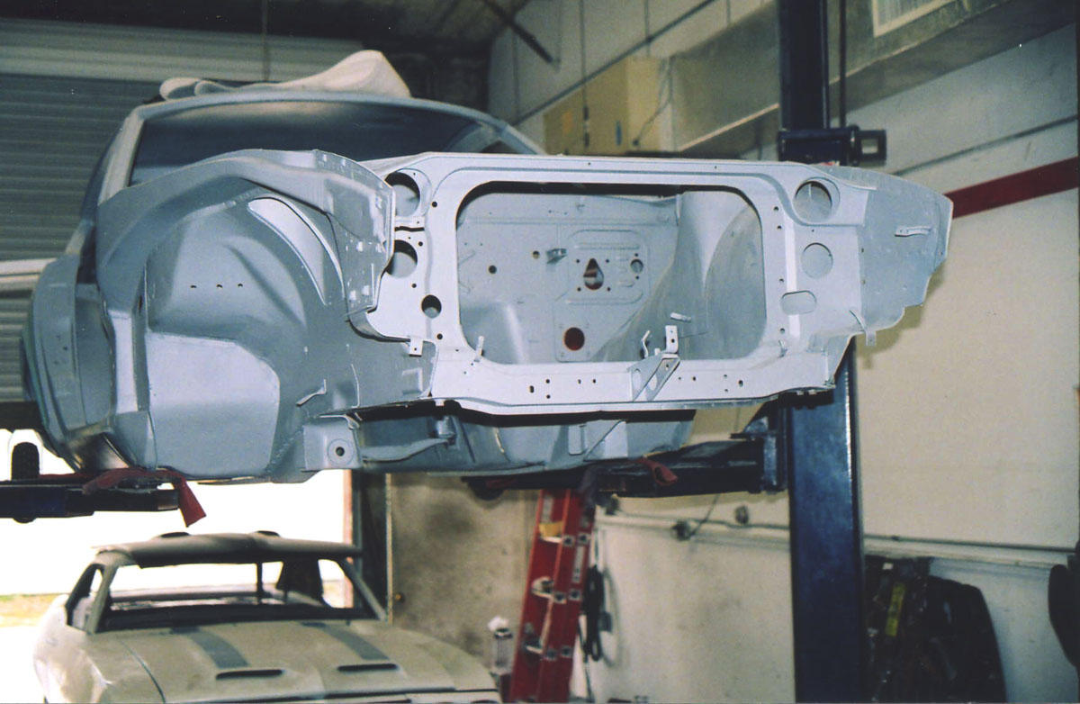

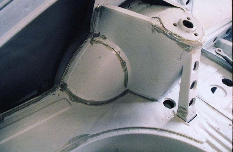

To insure that the interior chassis areas would not start rusting again, etching primer was sprayed inside the body panels with a garden pump sprayer and a long plastic wand.  All the seams had to be sealed.  The complete body had to be wiped down with a metal prep etching wash.  This was all done on a lift.
Finally the whole chassis was sprayed in a continuous primer.  I started to place the sound deadening "tar mat" sections, but didn't like the material and that's about the time that the economy fell on it's ear and my income went to hell.

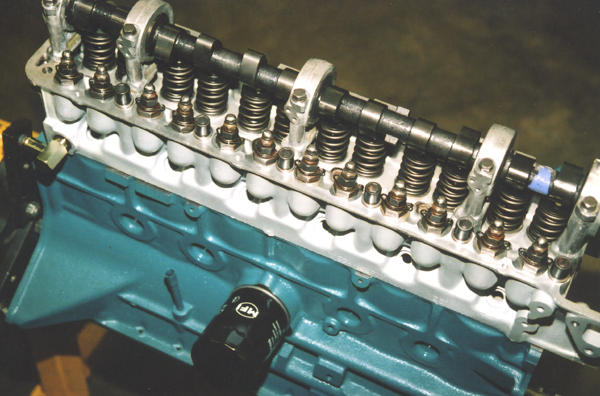

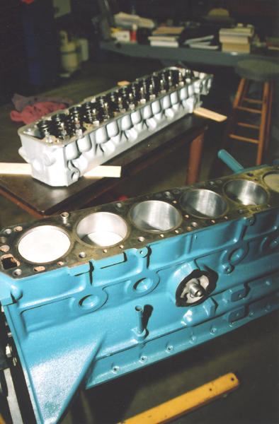

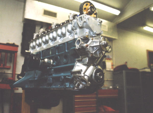

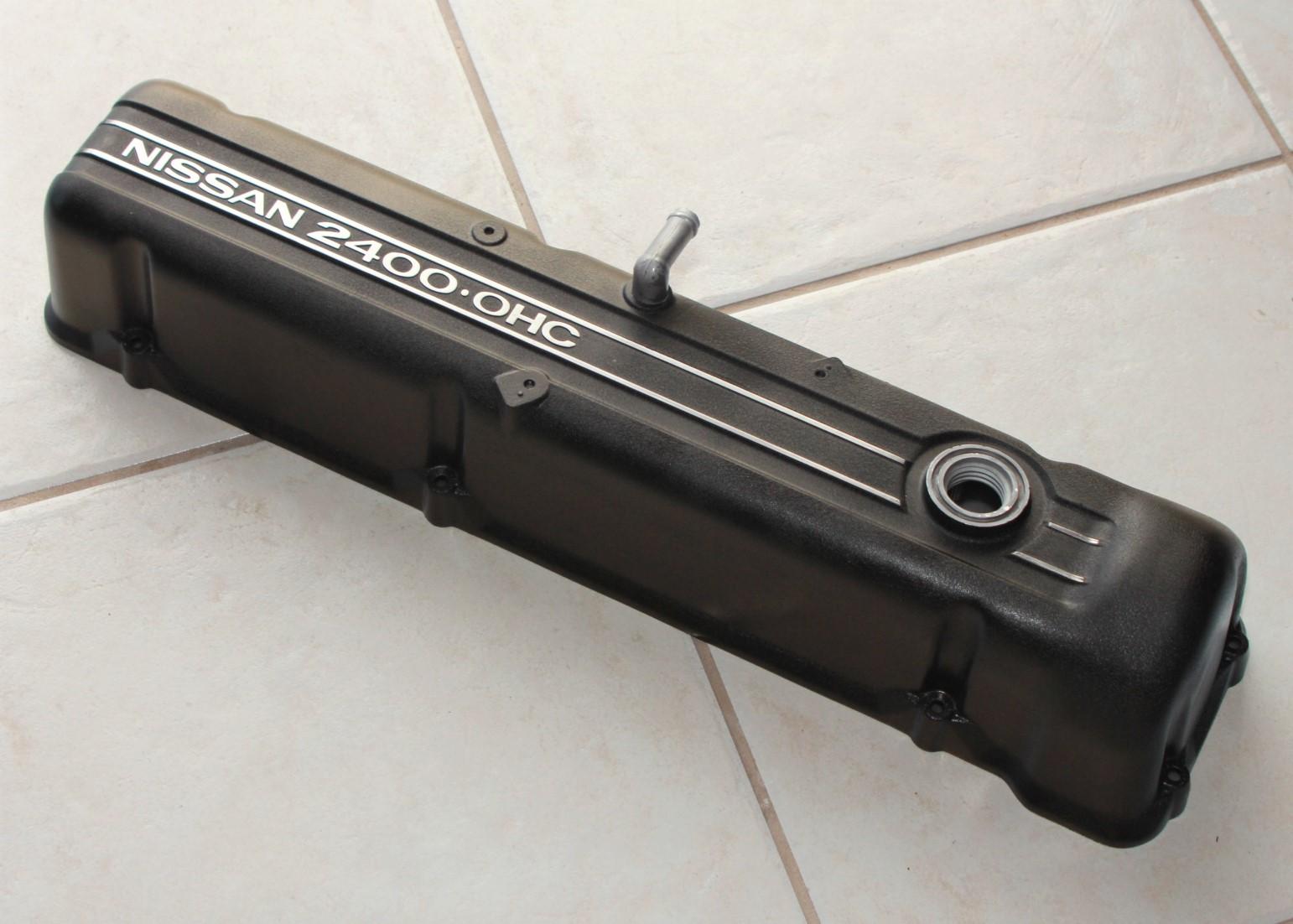

The engine is going back together without the emission control hardware.  I have an exhaust manifold without the air injection ports and the non-emission intake manifold.  I happen to really like the Hitachi carburetor design, have worked with them during my British car SU days and will use Z-Therapy rebuilds (perhaps slightly modified).  I decided to paint my valve cover wrinkle black as a throw-back to my racing days.
