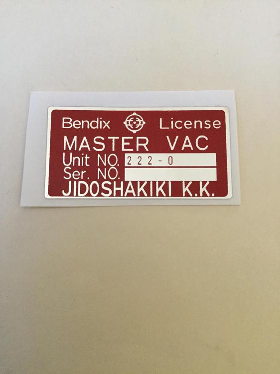

Hi Chris.

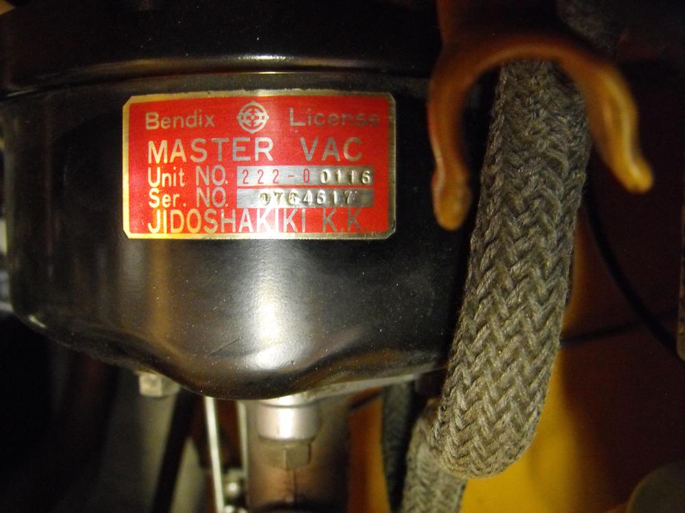

Glad to hear your plans for 26th and 27th are finally back on track.  As you may know, I had
reproduced, along with others, the red mastervac decals being sold by Motorsport and Banzai.
More recently I  have made the earlier ‘69-‘70  mastervac decal, also very nice and yet to be offered for sale.
let me know if they would be of interest to you.
the second  photo is an original decal, the first, my reproduction.  Colors, not well illustrated in
the photos, are very accurate.
Dan

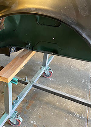

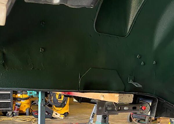

Let me begin by saying that this was an experiment to capture what I believe was the original 'finish' of the bottom of an early 240-Z.  Originally, 26th was covered in a dealer applied bituminous undercoating that covered everything down there.  Fortunately, a good amount of original factory build stuff was preserved.  Factory markings and paint dabs, for instance.  When I scraped all that off I noticed a texture to the original paint coating - a real heavy orange peel texture.  27th was not undercoated and exhibits the same.
For 26th, I did not try to mimic any masking of the application that may have defined the areas applied at the factory.  You have to take the car apart or crawl up underneath to criticise.  The Raptor has a lot more texture than I expected however I am quite happy with it.  I think it's going to be a bitch to clean.  Raptor comes in black color and this was mixed with 907 green.  I would say it is a shade darker, but it shows well and I am happy.  Next time, I'm going to thin the paint a little more and try for a smoother texture.

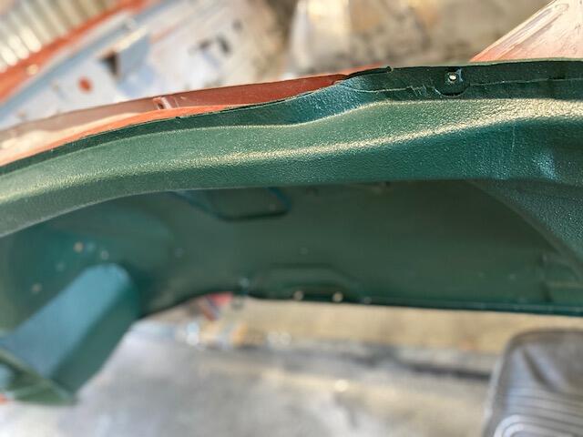

Well, it came out very nice on your car.   For the car I am restoring, I share your observations regarding the factory coating having a really heavy orange peel texture.   Raptor liner (it is a truck bed liner), mixed per spec, and as sprayed from their application gun doesn't lay down quite as smoothly as the factory texture, but it is closer than other spray on liner protection coatings.  I researched quite extensively before I decided to buy Raptor liner.  Additionally, however, I have two videos to provide which I found very interesting and which provide information which may help to achieve a finish like the factory coating.
Jump to 20:50 to see the resulting finish for the tintable stuff this guy achieved with the standard gun that comes with the kit and I think 60 psi at the regulator:
It is still more textured that the factory stuff, but closer than any other bed liner I researched.  That said, here is another video that I found where a guy using Raptor liner over dash parts and achieving a surface that literally allowed the original texture of the dash to show through.  I question the use of this product on dash parts, but I plan to experiment with the same, cheap gun, drilled out nozzle, more reducer and less hardener, as well as different air pressures to attempt to get a lot closer to the original factory look.
Jump to 11:48: He uses a cheap Harbor Freight HVLP gun with the nozzle drilled out to 2 mm.  And he uses 20% reducer instead of 10% and half to three quarter of the amount of the hardener called for, so that the sprayed material doesn't set up as quickly.  Finished dash is shown closer to the end of the video.
Most of the coating on my car is still in good shape.  There are many areas that were impacted at some point, however.  My plan is to try to replicate the original texture in those spots as best I can, probably using the raptor gun and Raptor thinned to 20%.  Hopefully, I can get a good result there, and then, I want to spray a very thin coating over the existing factory coating using the method in the second video.  I hope the new coat won't add any texture, but that it will allow the factory texture to show in the new coat.
